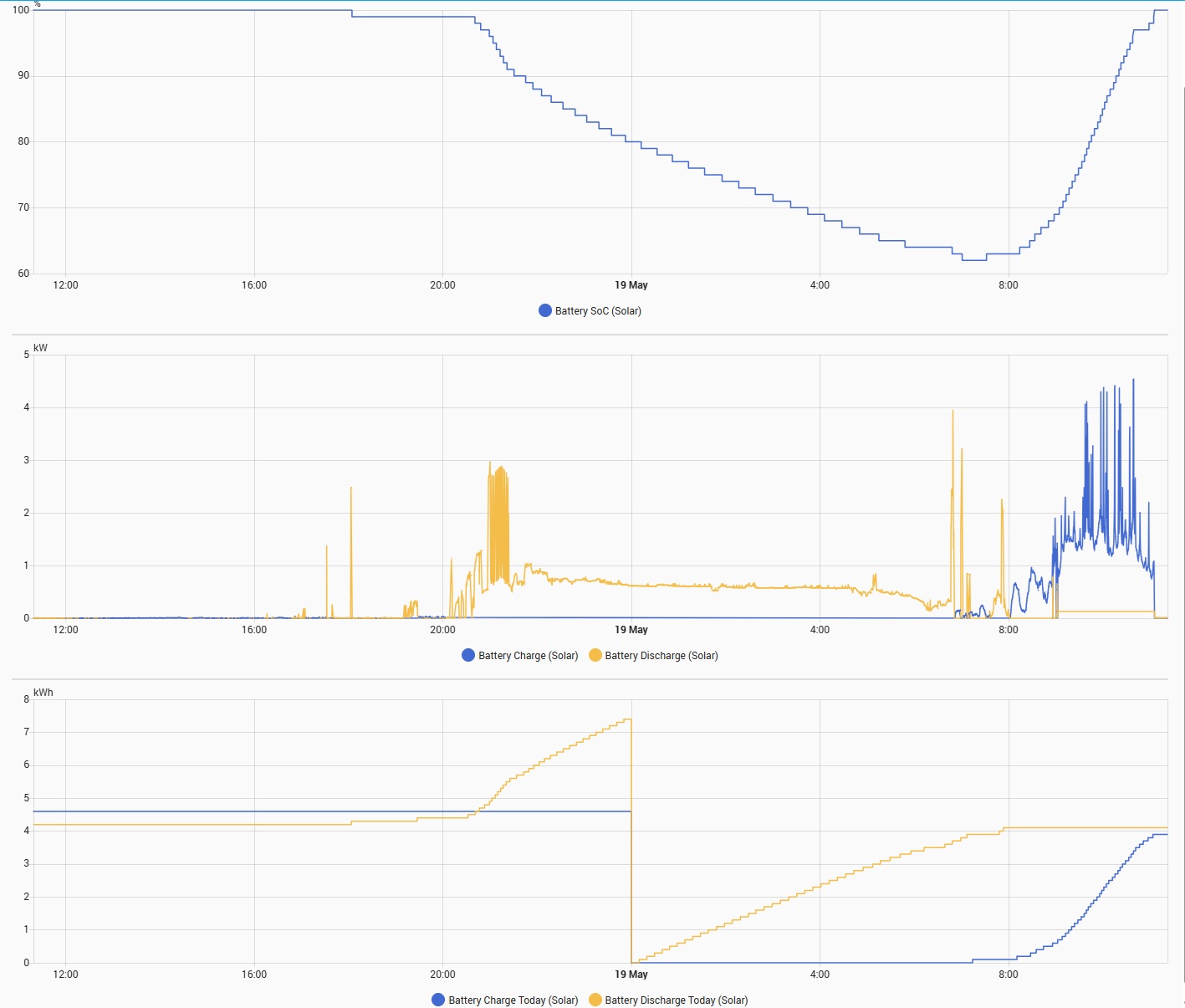

Over the 4-5 months my system has been installed, I'm pleased to say it's been working well, providing far more energy than we use. I have however noticed some odd numbers that I cannot reconcile. Every day that we've fully charged the battery, the battery always shows as exporting far more energy than it imports, for example, all this week the battery has been at about 80% at midnight, it then drops to about 60% over night then recharges to 100% in the morning, sits there at 100% until about 9pm the drops to 80% again by midnight. Each day however the "battery charge today (solar)" value is roughly 4kWh (makes sense as it's a 10kWh battery charging 40%) but the "battery discharge today (solar)" is around 8kWh. Typically discharge is 1.4 to 2 times greater than battery charge. Assuming it's not a magic battery producing power on it's own, can anybody explain this difference? All numbers are through Home Assistant, if that makes any difference.

The graphs all look normal with no sudden jumps. We typically cycle from 100 to 60% and back but have had the odd cycle from 100-10-100%, but not in the recent good weather. The totals for the system since installation are 479kWh import and 888kWh export, so nearly double out than in. I could understand the battery % being out if it hadn't cycled but I'd assumed the kWh in and out would be fairly accurately measured.

Thanks all for the replies.
A typical full set of stats this month is as follows:-
Grid Import - 0.1kWh
Grid Export - 33.5kWh
Solar Production - 47.8kWh
Bat Import - 4.6kWh
Bat Export - 7.4kWh
"Home" - 17.2kWh
Home seems to be calculated from Home = Grid import + Solar Production + bat export - Grid export - Bat Import
I know that when the battery is very low and charges from the grid from 10-15%, it doesn't register as importing to the battery but does register when it exports that energy, meaning I can explain the battery import < export in winter or low sun but I can't explain that in sunny weather when the battery doesn't deplete that low.
I also know that the typical grid import of 0.1-0.2kWh is more like 0.3-0.5kWh taken from my smart meter, which is believe is due to the CT clamp being unreliable at low current draw.
On a graph, the last 24 hours look like this:- The midnight to now lines match close enough but you need to ignore the discharge before midnight. Could there be something funny about this perhaps. I also notice that from about 9am till 11am today, the battery was charging but also has a constant discharge of 128W, which seems odd.
Next sunny day I'll do a forced discharge to 10% and see if it changes anything.
Phil
