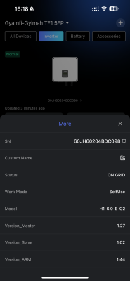

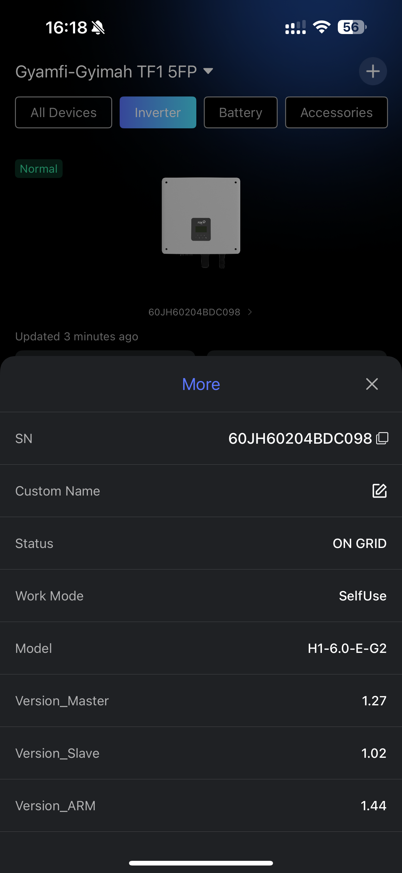

Look in the V2 app, click Device at the bottom and then click the Inverter and click on the serial number below the picture of the inverter, that will show your Master, Slave & ARM(Manager) versions - post them here and include your inverter model H series, KH series etc.. and I can check latest.

That’s the details of my inverter , please and confirm if firmware is up to date.

These are the latest versions for your inverter, you are a little bit behind - either ask your installer to update or you can raise a support ticket on Fox in the app
Master 1.33,
Slave 1.03,
ARM(Manager) 1.49
Master 1.33,
Slave 1.03,
ARM(Manager) 1.49
Thanks Dave, I’m raising a ticket now for firmware to be updated
