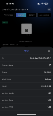

Pitagor
Posts: 3
Joined: Sun Apr 27, 2025 7:48 am
That’s the details of my inverter , please and confirm if firmware is up to date.

Posts: 1856
These are the latest versions for your inverter, you are a little bit behind - either ask your installer to update or you can raise a support ticket on Fox in the app
Master 1.33,
Slave 1.03,
ARM(Manager) 1.49
Pitagor
Posts: 3
Thanks Dave, I’m raising a ticket now for firmware to be updated
