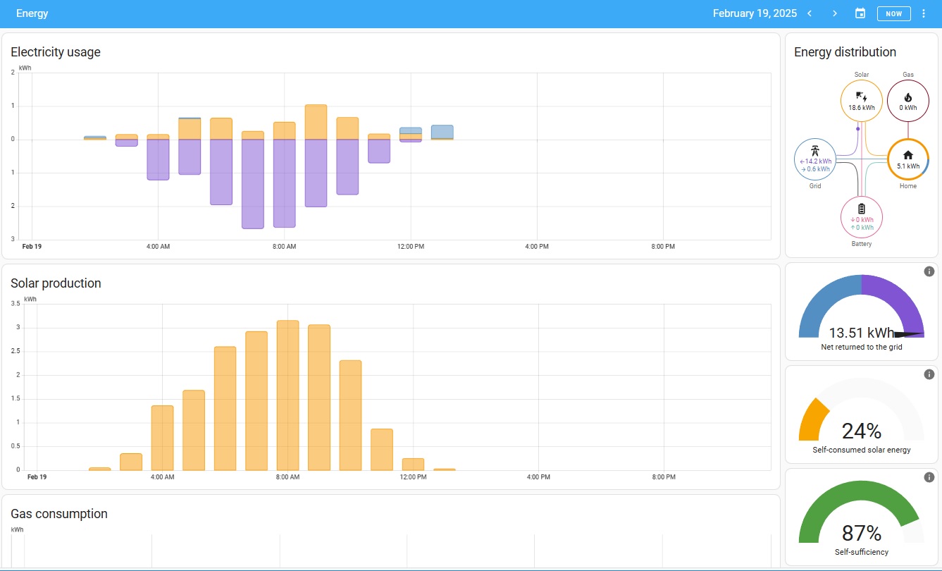

If you add CT2 the website does recognise the extra generation but in my experience it makes a real mess of your statistics by then miscalculating house load, and as Fox has said it doesn't uniquely calculate or keep statistics for it (it will show the power in a graph but no meaningful data).
If you went to a bit more trouble and set up a home assistant (small micro computer) you can get much more information from the Fox cloud as the home assistant will store all the data received from all sensors so you can see power, daily/weekly/monthly statistics etc.. - this is a simple example of the energy dashboard from a home assistant connected to the Fox cloud.
