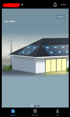

Hi all.   Newbie here with an App problem that somebody may be able and willing to help me with...
For the last few days, my FoxCloud 2 app has been displaying 'Offline / Off Grid and nothing I have tried will get it to go online.   From the app I can generate up to the minute data reports but I can't get real time data to show,
The 'dongle' is flashing slow red with occasional green, it has an IP address assigned by my router and it shows up as a connected device on my router.  I have logged out an in several times to no avail.
Am I missing something very simple?  All/any help gratefully received.  Thanks

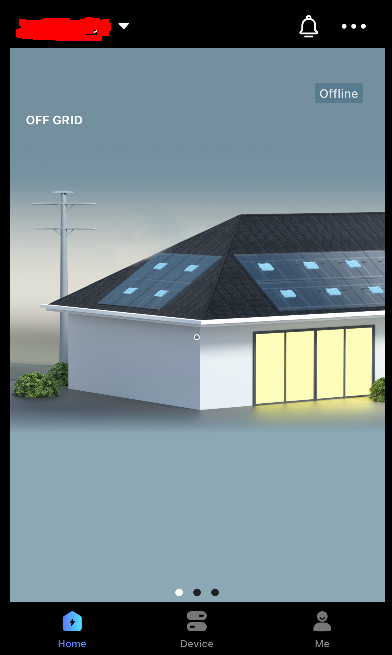

Hi, I have a similar issue as of about 7pm this evening. Fox App says Offline/Off Grid and all the real-time stats are at zero. The graph shows data until 19:08 this evening.
When I log into the Fox Cloud website it is also reporting my system as Offline.
However, when I go and access the panel on the inverter it appears to be working fine. It is able to force charge and discharge as I would expect. I have checked some calls into the OpenAPI and it seems to respond to being set to force charge or Self Use etc but it is not reporting the current SoC correctly - it just reports the SoC value that was correct at 19:08 when the stats stopped updating.
I have tried reinstalling the app and it’s just the same. I have also tried v1 of the app and it is also the same.
The dongle is flashing red (which I think(?) is normal?!)

I reckon it's a Fox app issue, my system went offline at exactly the same time. I've checked the inverter and it's still working. I'm new to this so don't know how these things get resolved. Hopefully it'll be back on in the morning?

Fox are aware of the issue and working to resolve. https://monitor.foxesscommunity.com/
