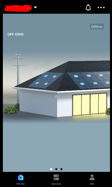

Hi all. Newbie here with an App problem that somebody may be able and willing to help me with...
For the last few days, my FoxCloud 2 app has been displaying 'Offline / Off Grid and nothing I have tried will get it to go online. From the app I can generate up to the minute data reports but I can't get real time data to show,
The 'dongle' is flashing slow red with occasional green, it has an IP address assigned by my router and it shows up as a connected device on my router. I have logged out an in several times to no avail.
Am I missing something very simple? All/any help gratefully received. Thanks

If you log into the Foxesscloud website, do the real time stats look ok there?
If they do i’d be tempted to completely delete the app, and re-install to see if that clears it.

Sorted after a fashion...
... app deleted, re-installed and on line but looking at the 'day/month/year/lifetime' data within the app suggests that no data has been captured for the days the app has not been working.
