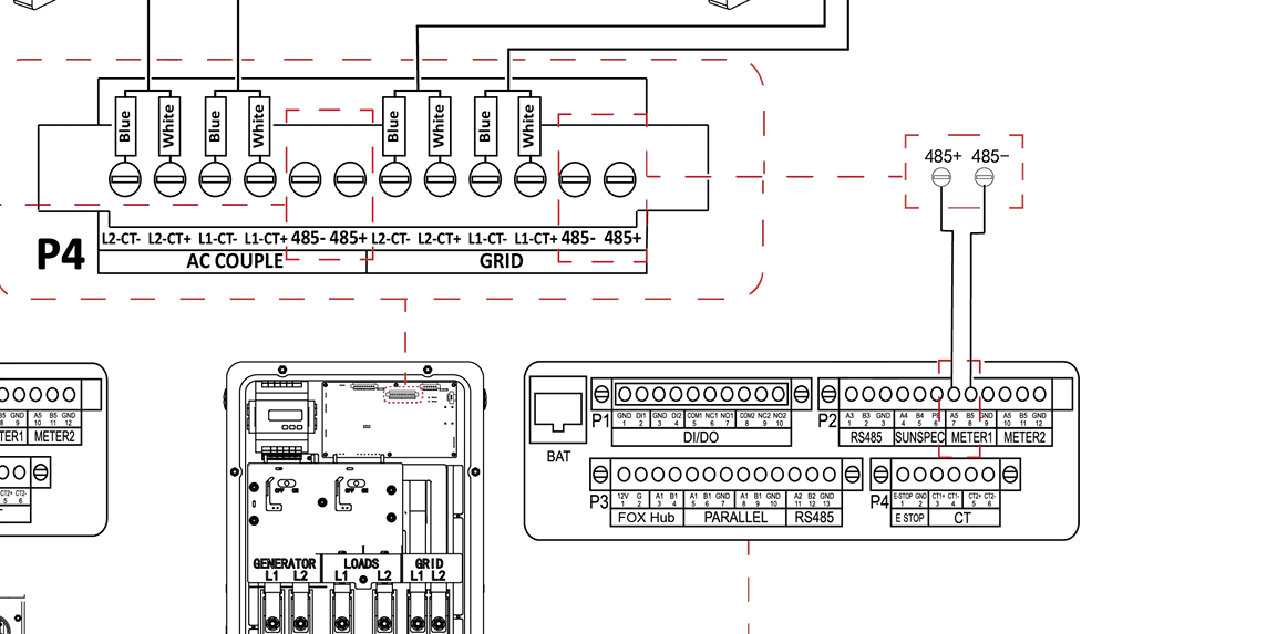

We've never had (heard of) an US H1 being interfaced so far, and looking at the manual there appears to be an RS485 port available (one for meter, the other for modbus?) - can you confirm ?

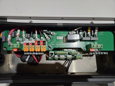

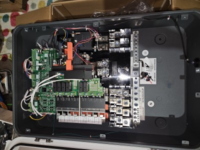

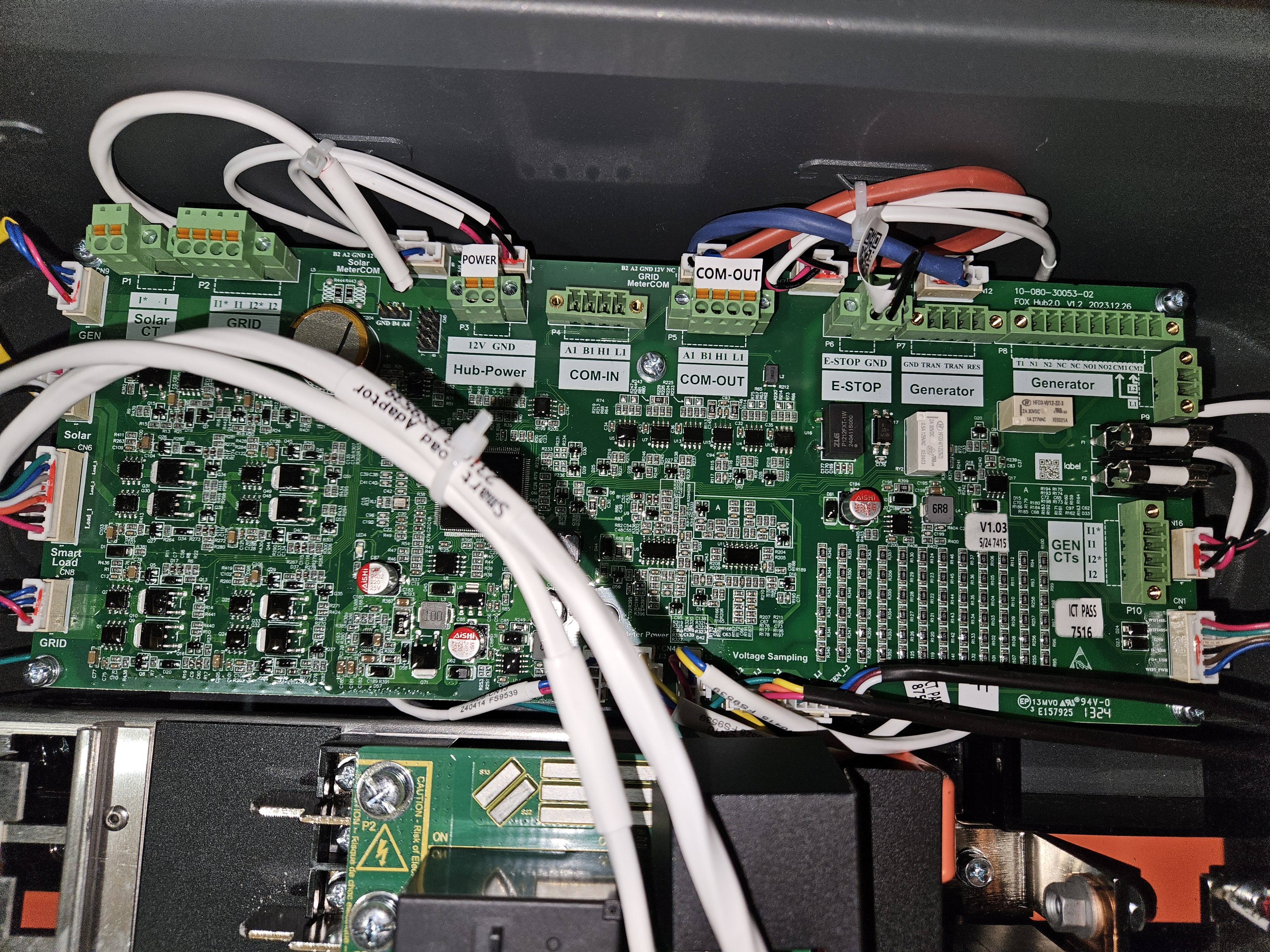

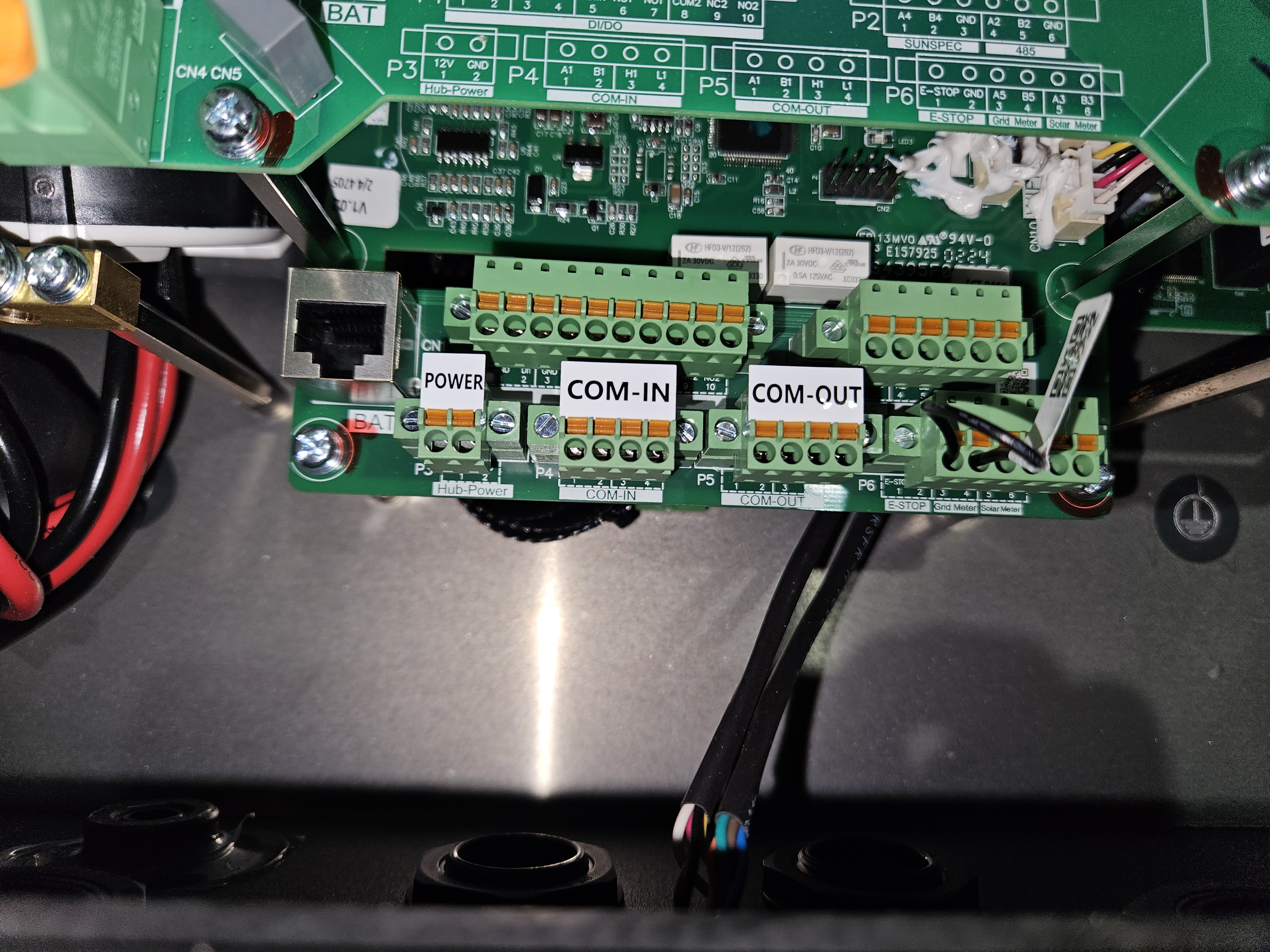

The first 2 pics are the inverter and the second 2 are the hub. The inverter communicates with the hub and the hub is intended to communicate with the app via a USB dongle. Honestly I'm not completely sure how it's going to work. It looks like the diagram you posted is of the Fox hub. However it looks different than mine. Maybe that diagram is Fox hub gen 1? Would you recommend setting it up initially in the Foxess app?

Hmm ok, yours is slightly different from the US hybrid manual on their website but it looks like that P2 connector (right hand 3 pins) has an RS485 output that may allow modbus - but in all honesty it also may not, we’ve never tested one of these so it would be useful if you could connect an RS485 modbus adaptor up to the A/B pins and do some testing using modpoll to see if it responds.

I am working on this as well. The inverter is also the h1-aa.4-us, but I am not using a fox hub. I am using and elfin ew11. I am able to talk to the ew11, but I cannot get the inverter to respond. I also have the WiLAN that is seperate, but can get some info from it. The ew11 seems like it is receiving info (frames?), but I cant get any communication via home assistant witn fox ess modbus. I am using the rs 485 ports next to the sunspec on the p2 connector.
One of the issues that I have is that I connot derive the slave id as this unit does not have any buttons nor display. at first I used modpoill and a small script that went through all the slave ids (0-254) to get it to repsond to anything. No response. I then used CAS Modbus scanner to see if I can find the slave id but only received all timeouts. I am also concerned that I might not have the correct serial settings (baud/data/stop/parity) 9600/8/1/none which is the settings indicated by fox modbus.
There are multiple rs 485 ports on the inverter. Is there one that I should be using? I think I tried the one next to the parellel on the p3 connector, but I dont think that worked. I might try it again, maybe all of them. The modbus scanner takes about an hour and my script takes about 15.
