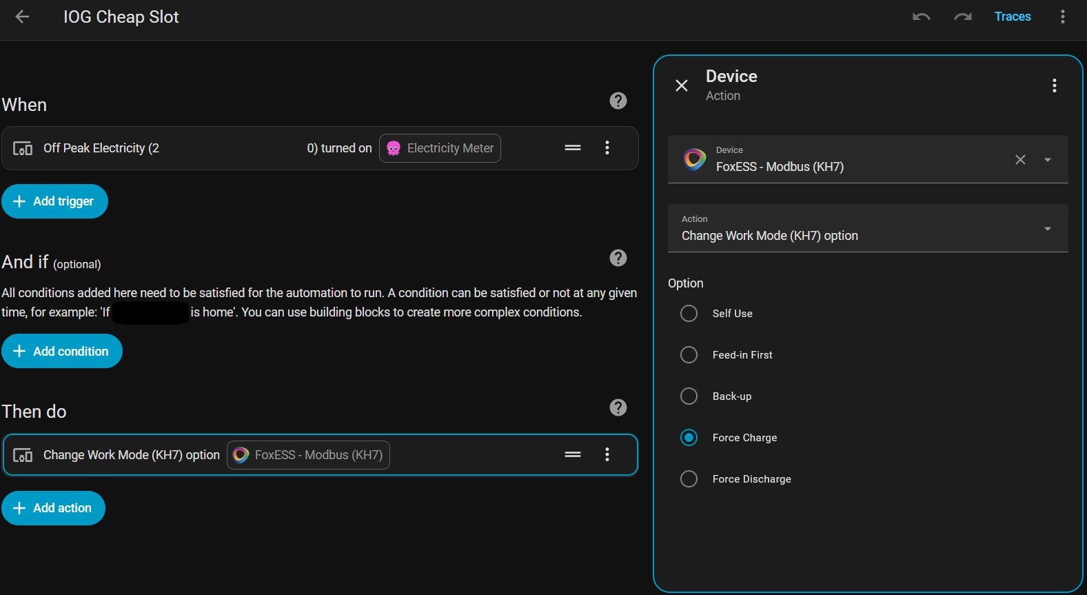

A few things to clarify, IOG takes care of your system, if you try to take 'control' of charging, then you will likely get kicked off the tariff at some point. They are clamping down on things, just a matter of time before it happens.
With Will's solution, that I have implemented on my HA Green, it simply listens for the 'off-peak electricity' flag to be turned on, which should happen during the overnight period OR if you get a random slot assigned outside of the fixed off-peak times. It works fine with my Zappi, I do not control it at all. I am not sure what integration there is with the Ohme within the HAOS, but there could be some 'flags' there to capture when it is commanded to start.
The low power slots have always been independant of the fixed overnight slots, only real change is you are only allowed 6hrs of charging time per 24hrs (an Octopus day starts at 12pm) typically overnight is cheap power, so majority of the slots allocated are set to overnight. If the grid has surplus in the evening, and it benefits Octopus in your area, they could charge your car for 30mins or more to balance the grid.
If the car is charging via Octopus IOG, then your home (cooker/battery/whatever) will be at the cheap rate. The only exception is if you choose to 'bump' charge and then it is at peak rate.

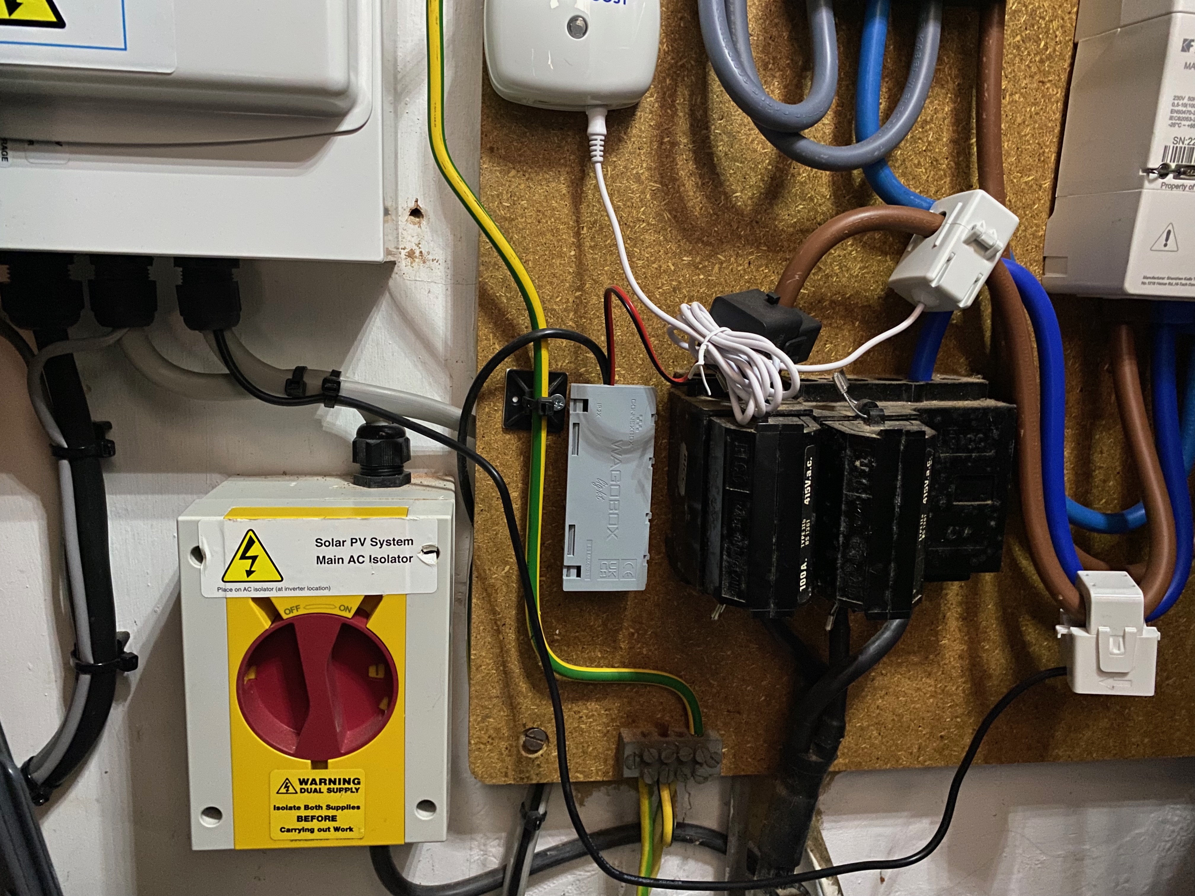

I have just looked in the cupboard under the stairs and have taken these three photos.
There are three cables coming in from the the external inverter/battery. One powers the emergency socket for when there is a power outage, and the other two go into the bottom of the solar panel consumer unit.
Another small black cable comes out of the same unit (don't remember if it was there beforehand), which goes to a clamp on the the main red solar cable. There are two other clamps on the same cable; one (white) to the iBoost water heater (obsolete now) and another (black) that goes into the small grey Wagobox. I don't know what it's for.
Any ideas? It doesn't look very promising to me!
John
Re: Using Home Assistant to control house battery and EV battery charging with octopus intelligent go
Hi John,
In your 3rd picture, it looks like the network cable (it looks like one) enters the 2nd port on the CU from your Inverter.
This then exits to a CT clamp of course.
Now the problem is, that you are going to have to open that CU and find the network cable, and that's Tiger territory, so not recommended.
There might be a way to control the system via HA still, user nicois has created an addon that you might be able to make work, and could be safest choice for you. I think you should take a look here, and ask directly if their integration can work for you?
viewtopic.php?p=15707#p15707

I followed your link and read it but am really none the wiser. I think I have reached the end of the road on this one. Perhaps if I had an Octopus charger and an Octopus battery (if such exists), Octopus could have sorted it out for me. Otherwise, there must be thousands of householders like me who have this problem and find it all too complicated to fix without paying hundreds of pounds for a re-wire. Perhaps they should have wired it up to avoid this problem in the first place.
So for now, when I plug in the EV, I am experimenting with switching a 'Force Charge' mode schedule to 'on' when the charger says that it is charging the EV at low tariff and setting an alarm clock to the finish time of the slot so I can switch it off again. May need to do this several times in an evening! So easier to go back to setting the alarm clock to 23:30 to release the Ohme authorisation hold.
So I have put the HAG back in its box. Perhaps I could make use of it to control smart lightbulbs and curtains when we are on holiday?
Anyway I just wanted to thank you for all your help even though it was fruitless. I'll let you know if I ever get it fixed.
