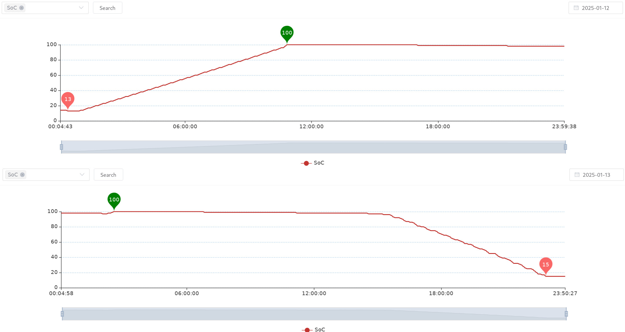

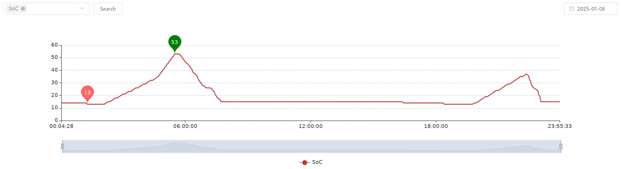

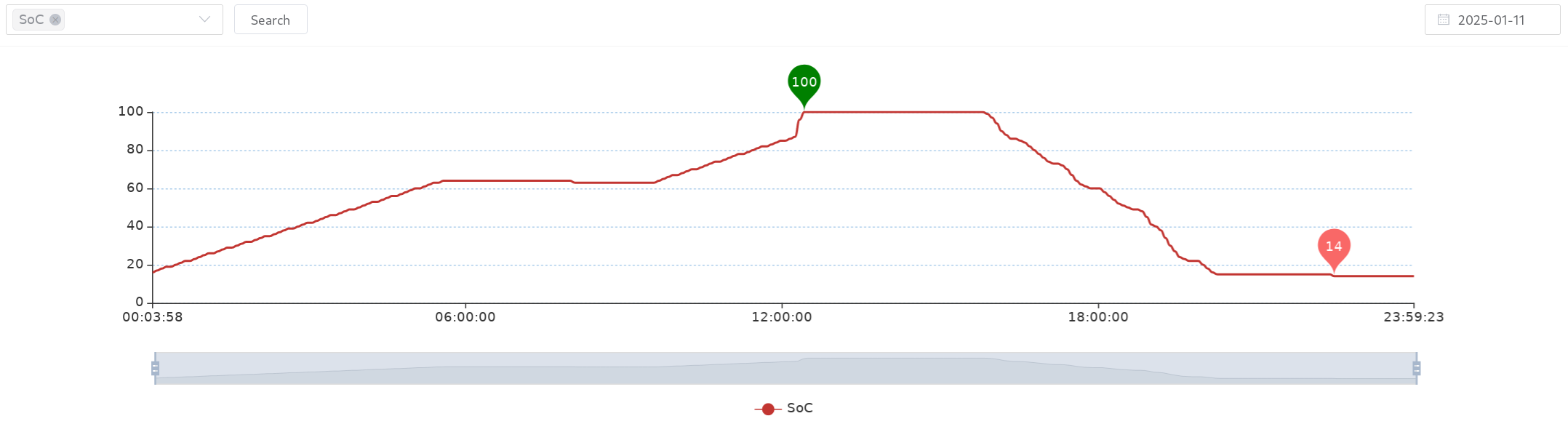

I have also been affected by this issue in the last few days. I have a force charge period from 02:00 to 05:30 and min SoC of 15%.
On 8th January, the battery unexpectedly charged from about 19:45 to 22:20. It reached 37% and then immediately started discharging.
On 10th January, the battery unexpectedly charged from about 23:45 to 05:40 (on 11th). It reached 64%, held it at that level (i.e. pulled from the grid instead of discharging the battery) until the solar kicked in and charged the battery to 100%, after which it started behaving normally.
On 12th January, the battery unexpectedly charged from about 01:00 to 10:45 when it reach 100%. It held it at that level without discharging, all the way through to 13th January at about 14:30 when it started discharging.
While it has certainly been cold during the last week, the forced charging periods, charging levels, and preventing discharge seems rather random and not necessarily correlated to when it is particularly cold. The system otherwise appears to be working fine.
