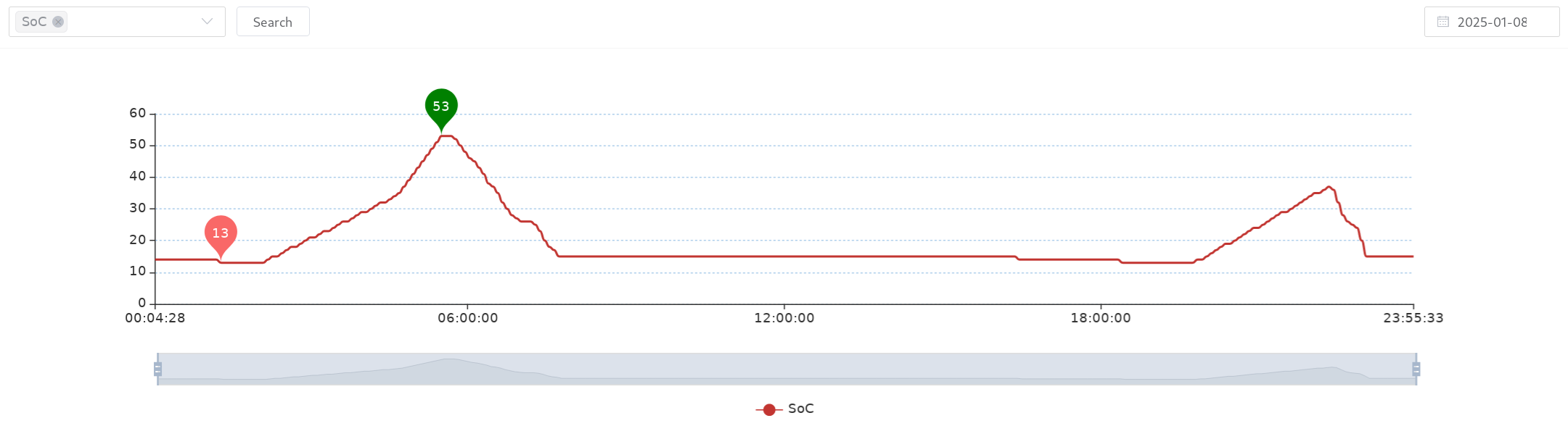

I have also been affected by this issue in the last few days. I have a force charge period from 02:00 to 05:30 and min SoC of 15%.
On 8th January, the battery unexpectedly charged from about 19:45 to 22:20. It reached 37% and then immediately started discharging.

While it has certainly been cold during the last week, the forced charging periods, charging levels, and preventing discharge seems rather random and not necessarily correlated to when it is particularly cold. The system otherwise appears to be working fine.
