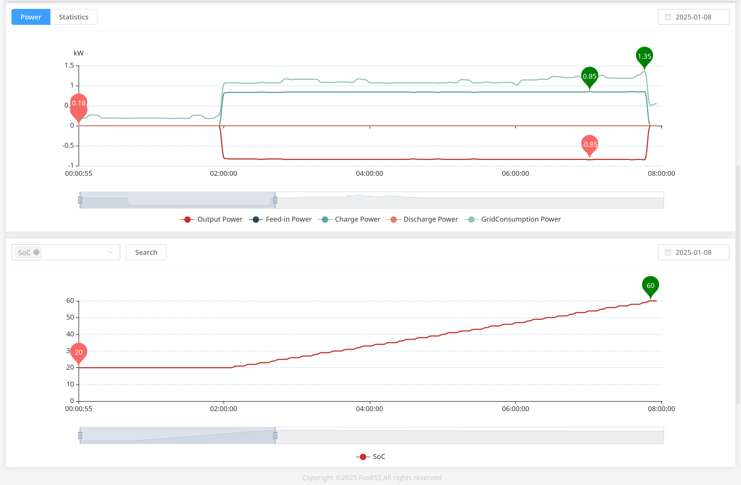

After correcting the inverter's clock on Saturday, and setting the scheduled charge-from-grid period to 02:00-05:00, I've observed much more expected behaviour the last two nights.
On Saturday night when it was still freezing outside, it started charging as expected at 02:00 but at a slow rate of about 0.85kW. It It charged from 58% to 80% over the three hours.
Last night, with the weather being much milder, it again started charging the battery at 02:00 at a rate of 4.15kW, then jumped to 5.43kW after 40 minutes for another hour. It charged from 20% to 100%. The house has been running from battery all day and it's still at 52% now, which is nice.
One minor weird thing was that yesterday, the battery drained to 20% at around 14:35 and stopped being used, but it continued to drain very slowly down to 16% by 01:00 this morning. The system did a brief 15-minute top-up charge at that time to bring it back to 20%.

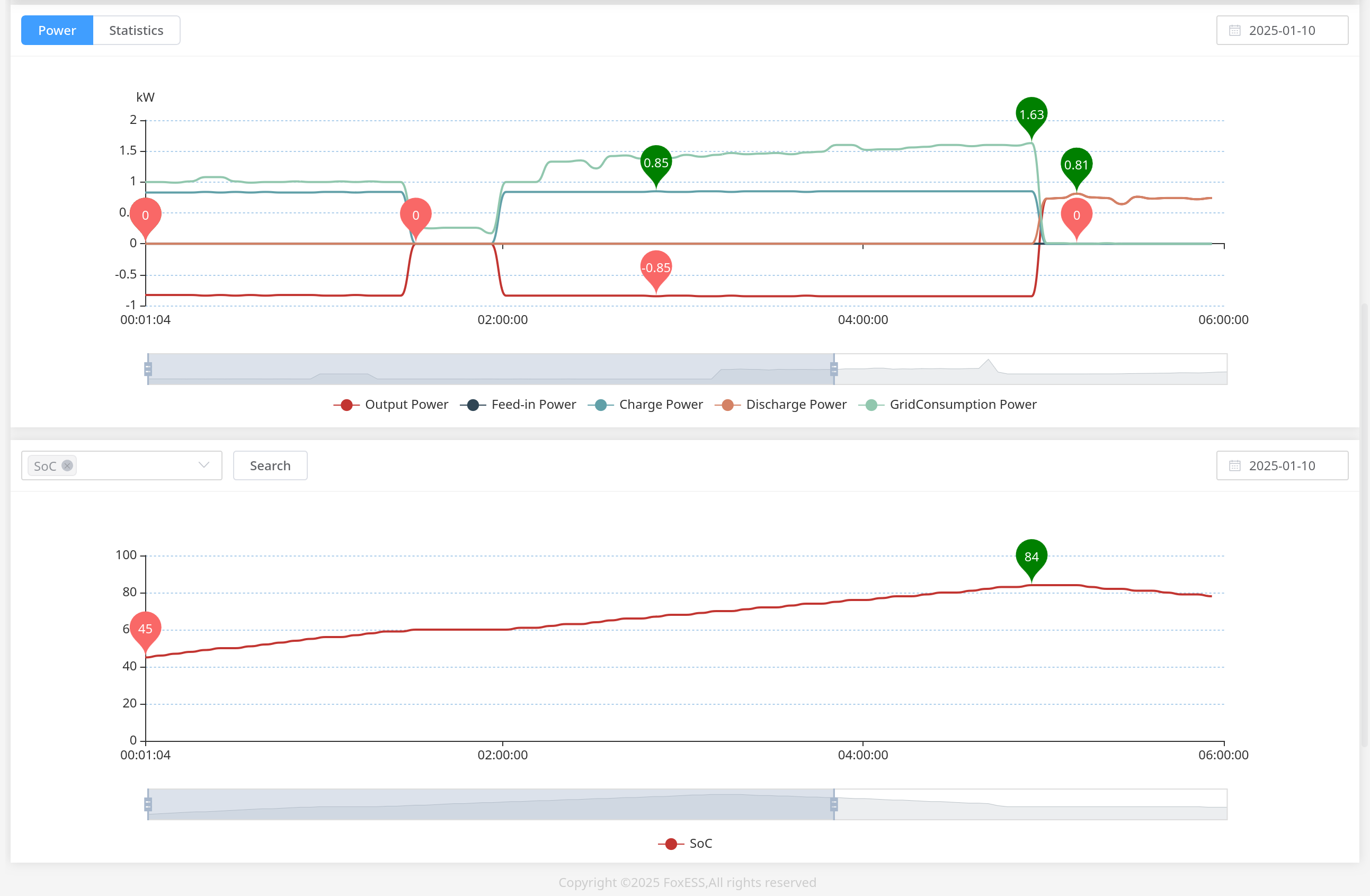

My system is mostly behaving as expected now, but I'm still seeing occasional unexpected charging from grid at non-ideal times.
The system is set to charge from grid from 02:00 to 05:00, being the Octopus Flux cheaper rate period.
This morning, the battery was at about 44% at 00:00 and unexpectedly started charging at that time. It charged up to 60% by 01:30 then stopped, then the scheduled charge kicked in at 02:00 and took it up to 84% by 05:00: On the morning of the 8th, it started charging as expected at 02:00 (20%), but continued until 07:50 (60%), 2h 50m past the end of the cheap rate period: The 60% SoC seems to be a common theme here. My concern is that the system is choosing to charge the battery from the grid outside of the cheapest rate period.
