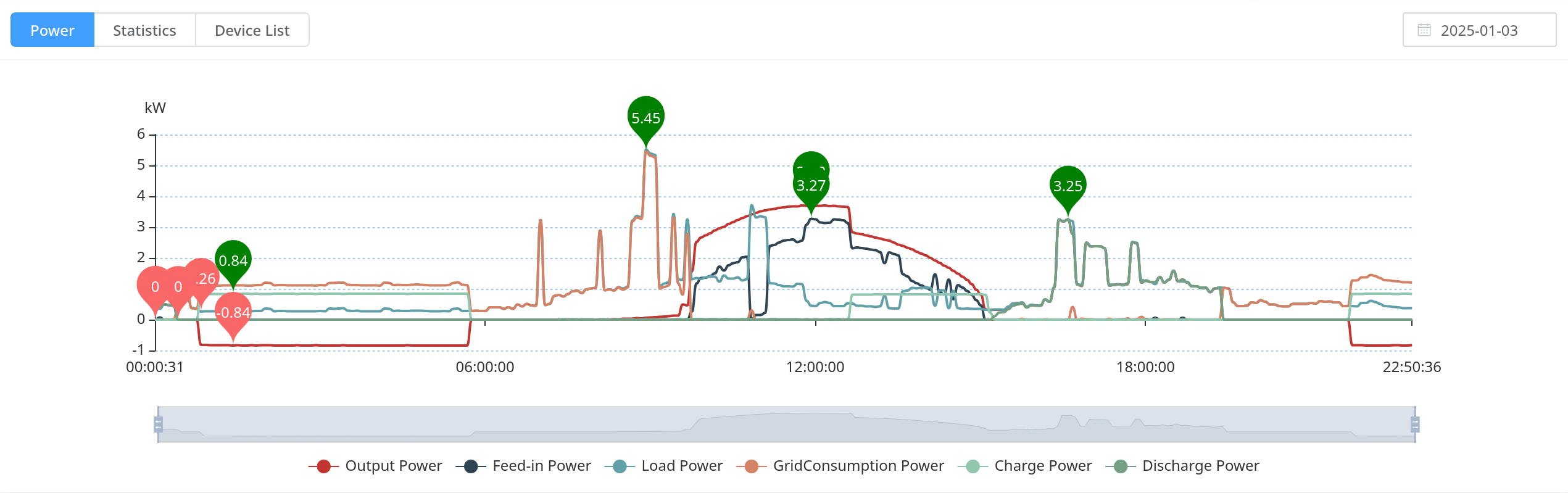

There was a nice bit of sunshine today, so we had 2.5kW of solar generation as soon as the sun cleared the hill to the east of my house at 09:50, climbing to 3.7kW around midday. For some reason, battery charging didn't resume until 12:35, so most of that generation was being exported. Why didn't it resume charging the battery as soon as there was a surplus of solar generation?
Here's today's graph from Fox ESS Cloud:
I'd be grateful if anyone could enlighten me.

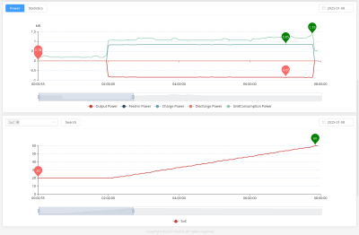

After correcting the inverter's clock on Saturday, and setting the scheduled charge-from-grid period to 02:00-05:00, I've observed much more expected behaviour the last two nights.
On Saturday night when it was still freezing outside, it started charging as expected at 02:00 but at a slow rate of about 0.85kW. It It charged from 58% to 80% over the three hours.
Last night, with the weather being much milder, it again started charging the battery at 02:00 at a rate of 4.15kW, then jumped to 5.43kW after 40 minutes for another hour. It charged from 20% to 100%. The house has been running from battery all day and it's still at 52% now, which is nice.
One minor weird thing was that yesterday, the battery drained to 20% at around 14:35 and stopped being used, but it continued to drain very slowly down to 16% by 01:00 this morning. The system did a brief 15-minute top-up charge at that time to bring it back to 20%.

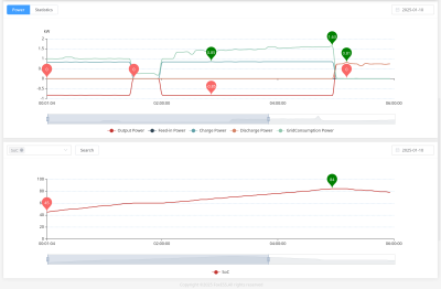

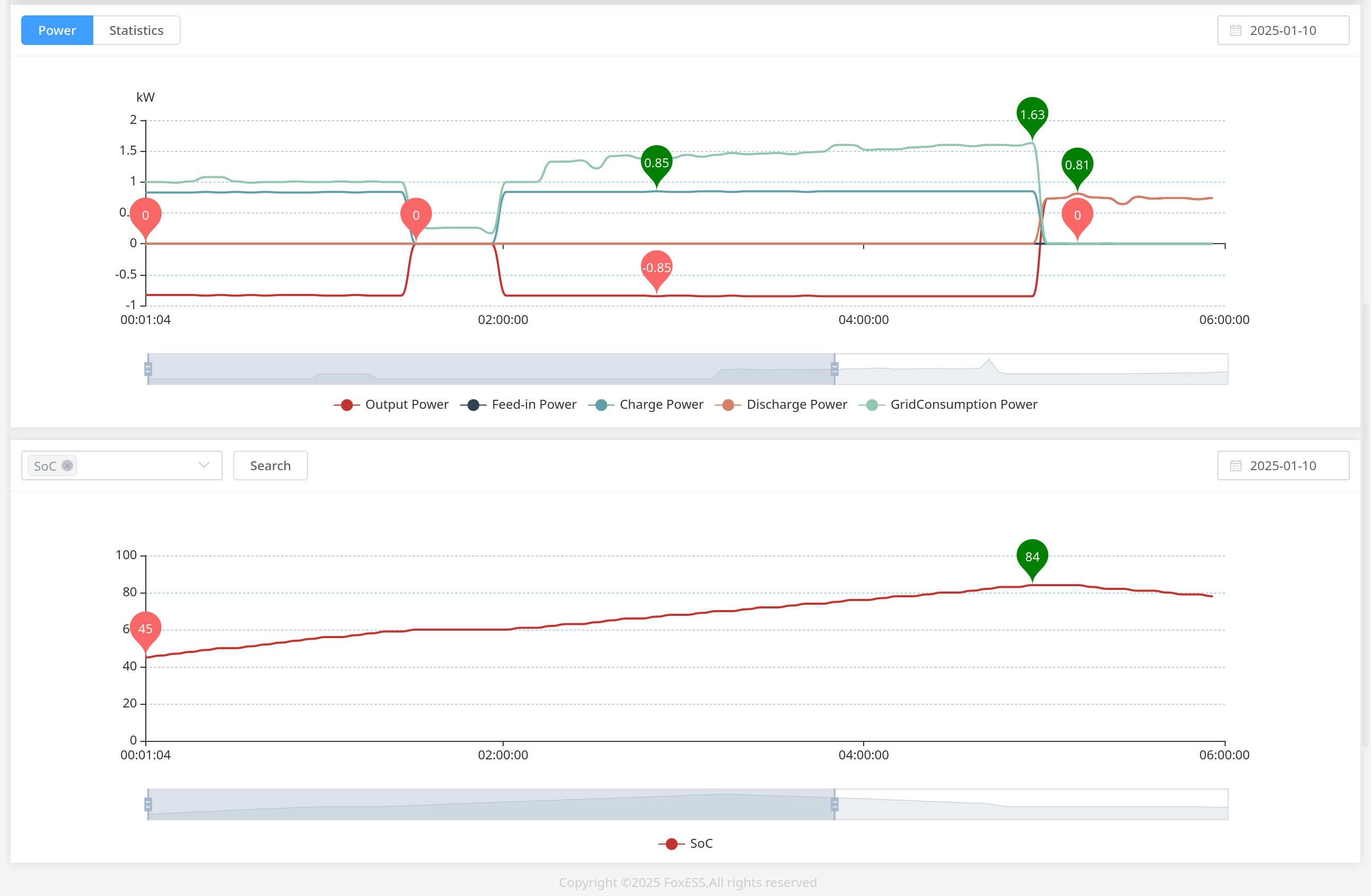

My system is mostly behaving as expected now, but I'm still seeing occasional unexpected charging from grid at non-ideal times.
The system is set to charge from grid from 02:00 to 05:00, being the Octopus Flux cheaper rate period.
This morning, the battery was at about 44% at 00:00 and unexpectedly started charging at that time. It charged up to 60% by 01:30 then stopped, then the scheduled charge kicked in at 02:00 and took it up to 84% by 05:00: On the morning of the 8th, it started charging as expected at 02:00 (20%), but continued until 07:50 (60%), 2h 50m past the end of the cheap rate period: The 60% SoC seems to be a common theme here. My concern is that the system is choosing to charge the battery from the grid outside of the cheapest rate period.

The charge power is really low, that only happens when the BMS is throttling the charge because of temperature (or at minSoC which you are not), the V2 app will show the lowest cell temp which is what everything triggers from - on the 4th it was reporting 1.5C and at 0C the batteries stop charging all together so much of this is the BMS trying to maintain it's operation.
As soon as the ambient temperature rises you will see your charge rates recover, I can't see what inverter spec you have but at 20C the batteries will charge from grid at just under the inverters rated capacity i.e. 5kW would charge at approx 4.8kWh.
If the batteries are outside they will be affected by cold weather (mostly affecting the charge rate) but when they fall below 0C they will stop discharging soon after - a lot of people build an insulated enclosure for this time of year which helps stabilise the temperature - there is a link here viewtopic.php?p=5465 to an example of what other users have used but if you search for insulation there will be quite a few hits.
