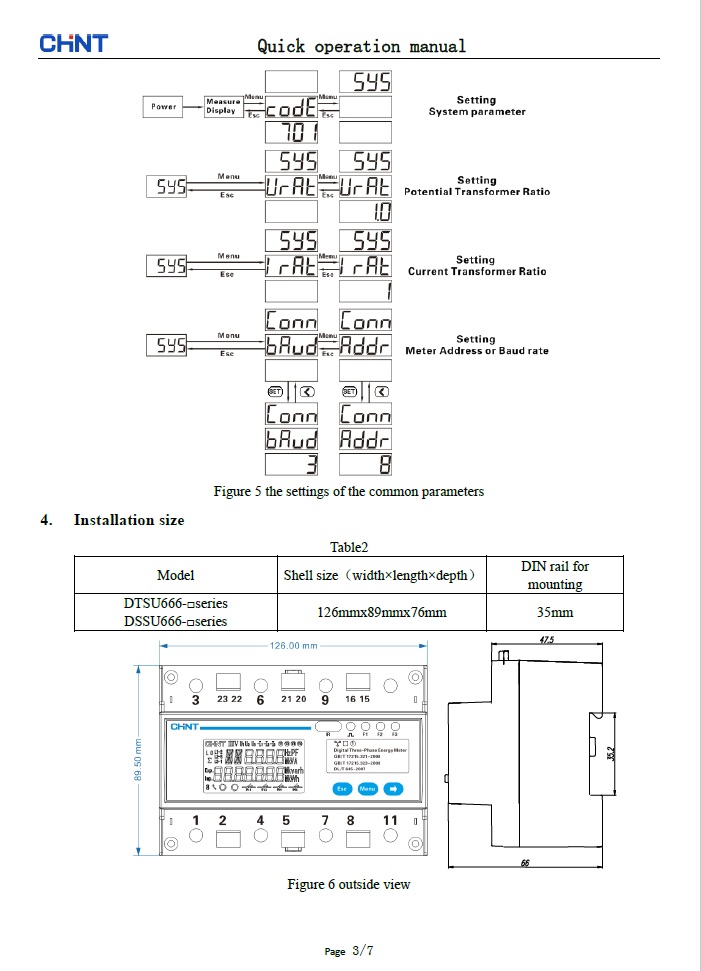

I own a Foxess T10-G3 inverter where I would like to use the meter function
to see the energy consumption also in the app.

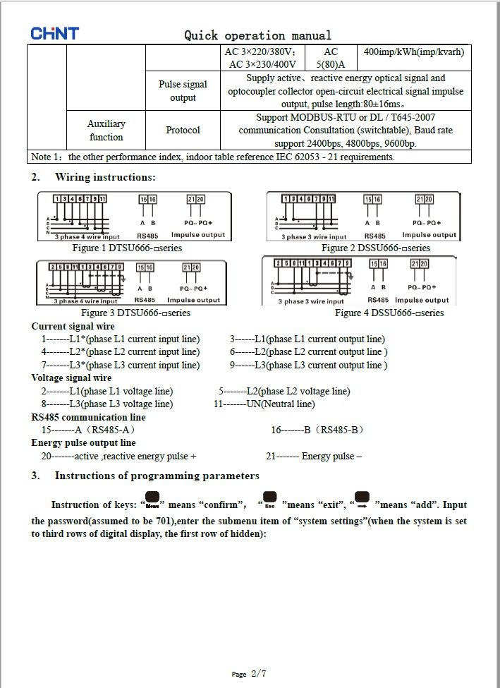

I bought a DTSU666, the version with the external current sensors.
I set the DTSU666 according to the instructions for Foxess inverters.
The meter function is activated in the inverter and the export limit is deactivated.
All cables are correctly connected (R485) the DTSU666 shows the correct values on the display
only the inverter shows strange values (such as 300W although 4 kWh are consumed)

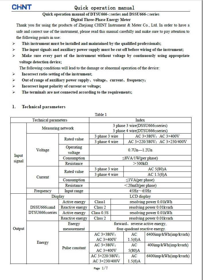

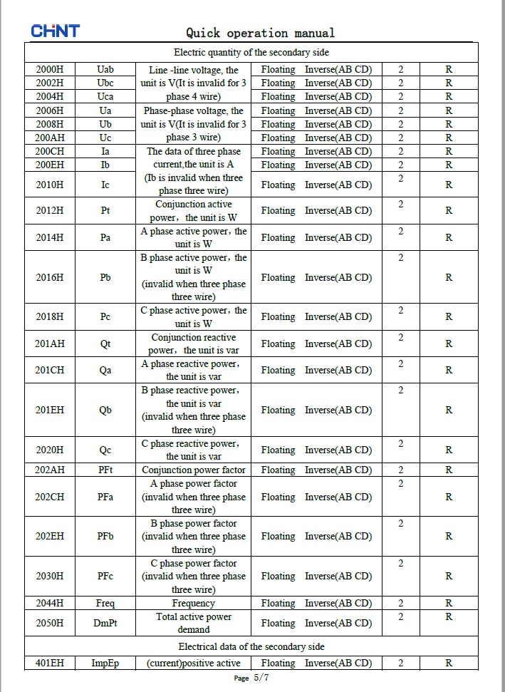

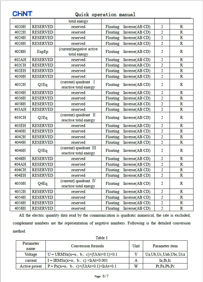

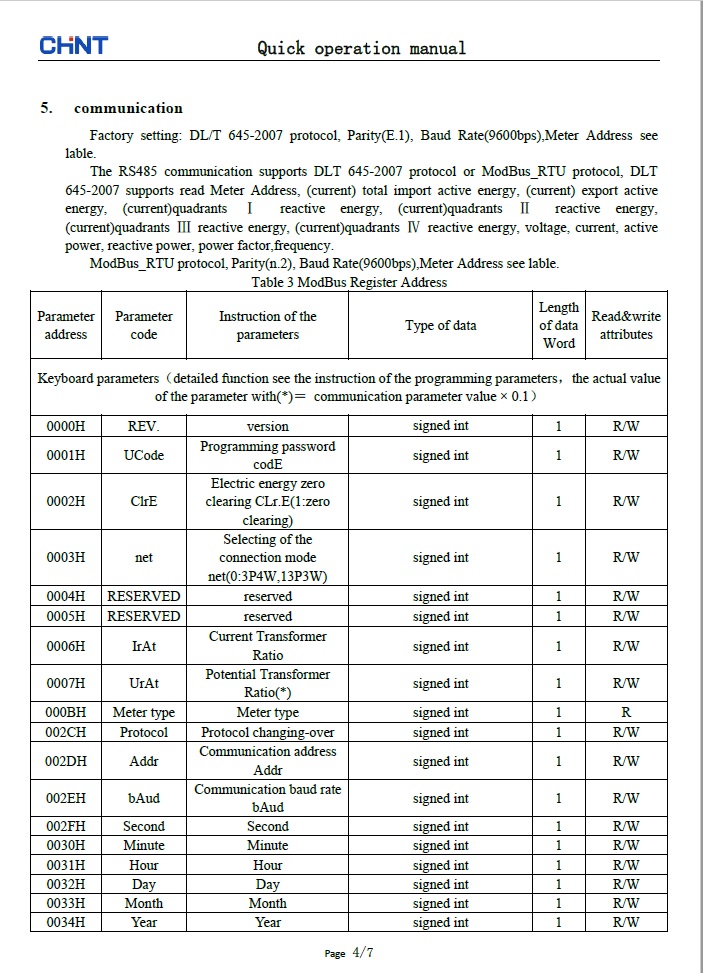

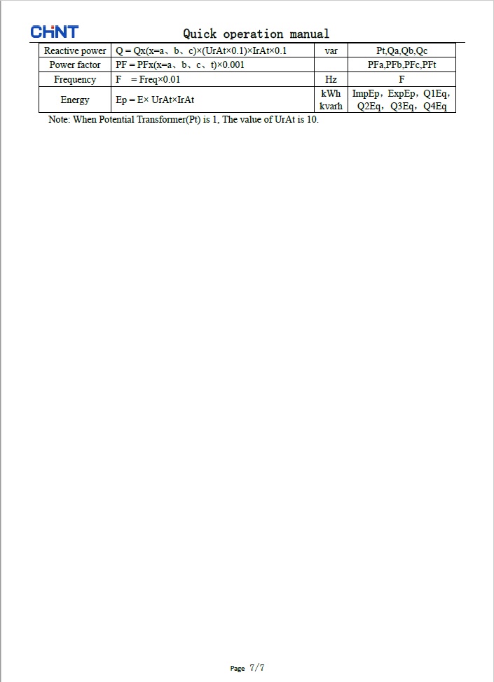

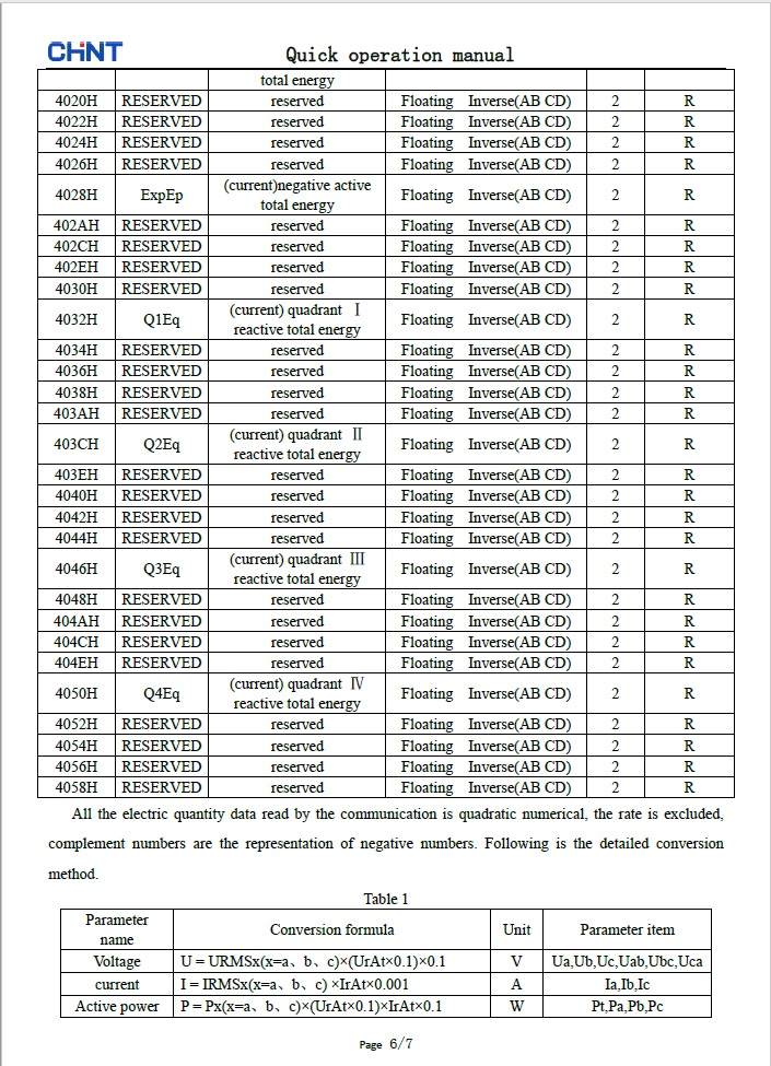

Your English is considerably better than my German sadly I can't answer your specific question but would refer you to these if you have not seen them already which shows the wiring and setting of the 3 phase meter.
- Posts: 1148
I have attached the manual, I can see there are many options that would change the transformer ratio and reporting values.
Sorry I can't help any further but hopefully something here will help.
