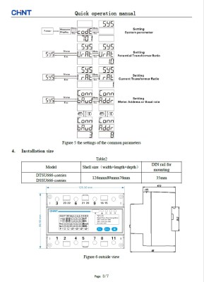

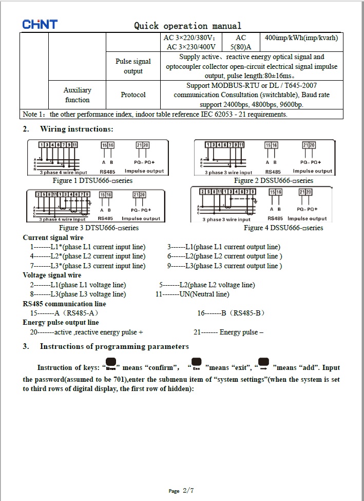

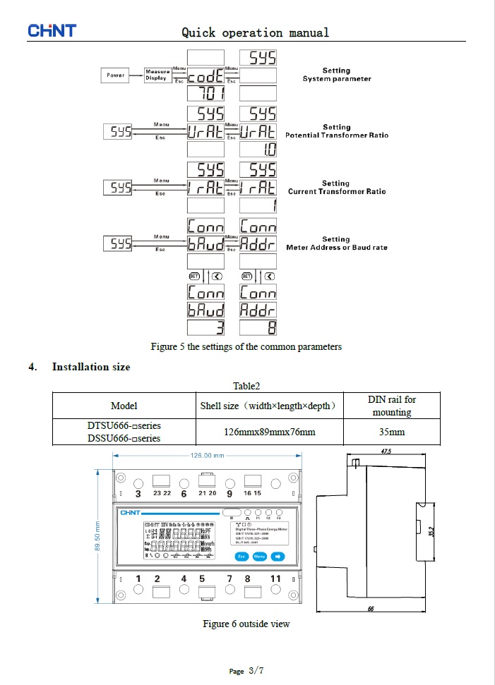

Your English is considerably better than my German ;) sadly I can't answer your specific question but would refer you to these if you have not seen them already which shows the wiring and setting of the 3 phase meter.
Posts: 1786

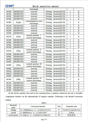

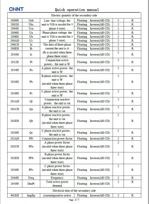

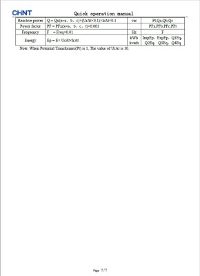

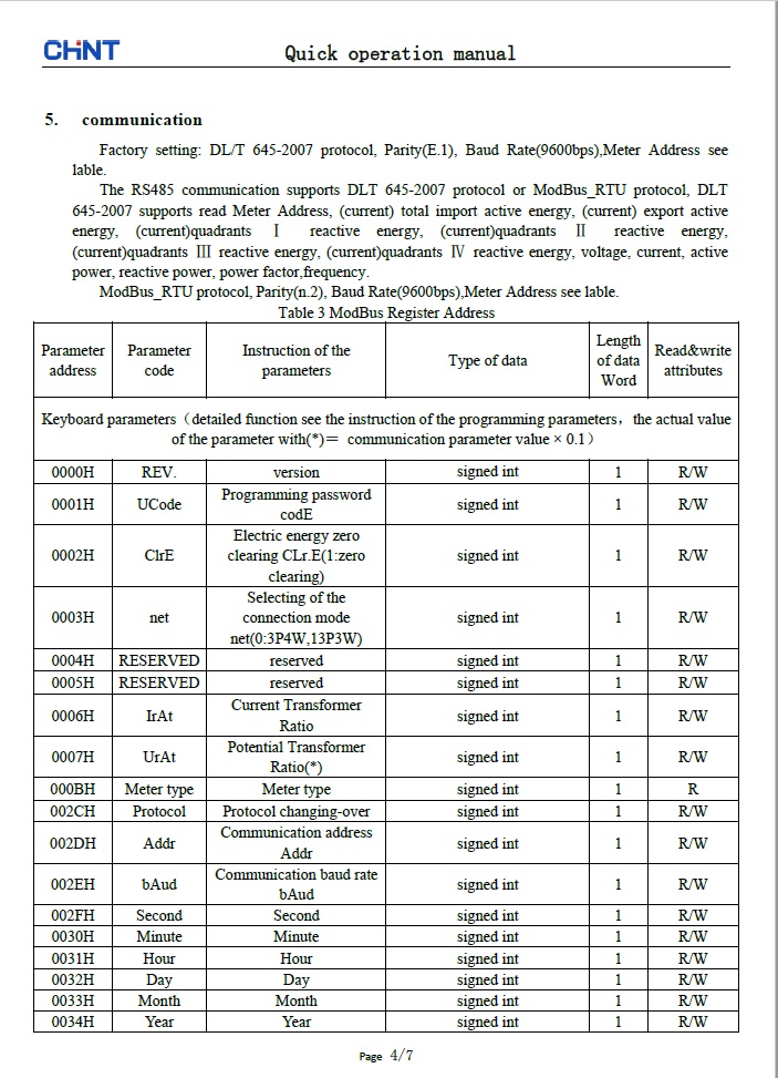

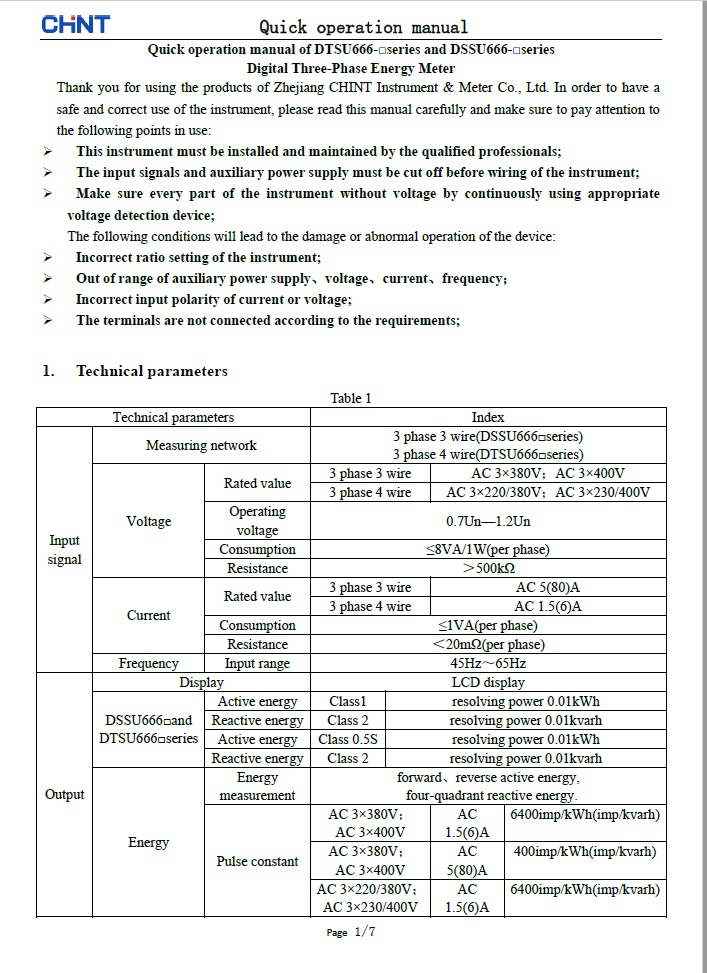

I have attached the manual, I can see there are many options that would change the transformer ratio and reporting values.
Sorry I can't help any further but hopefully something here will help.
