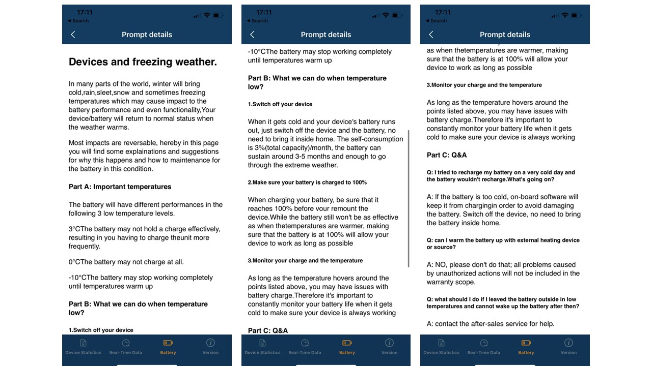

I can't remember whether I included the Foxess battery information that comes up on the app when it's cold (courtesy of William Eccles from his test system) but attached it now.
