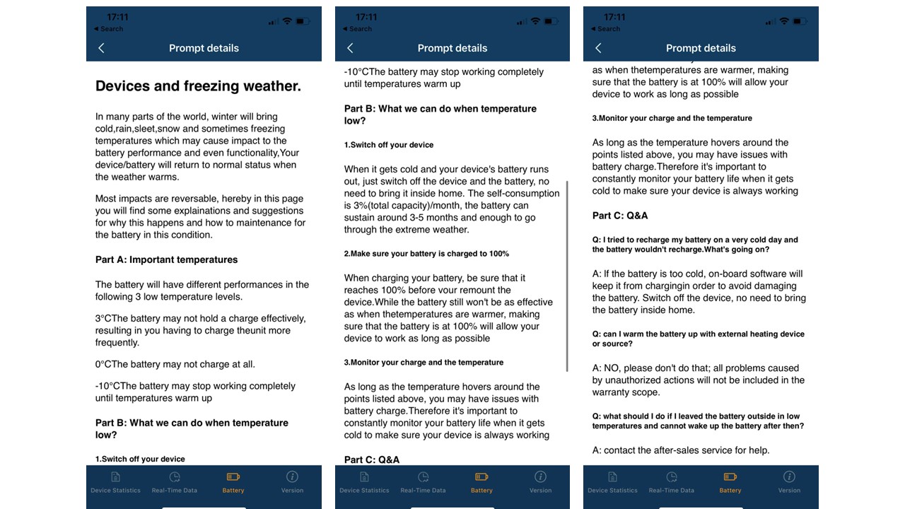

Turning the batteries off is a Foxess recommendation for when it's cold and solar is low; it's a physical turn off (power/isolater off), sadly you can't stop them charging with any of the app switches, it's the BMS that takes control.ml wrote: Mon Jan 23, 2023 7:25 pm You've suggested that the batteries can/should be turned off - that's via "enable force charge on & enable charge from grid off" options, rather than the physical switch? (significant as the former I should be able to automate).

I can't remember whether I included the Foxess battery information that comes up on the app when it's cold (courtesy of William Eccles from his test system) but attached it now.
