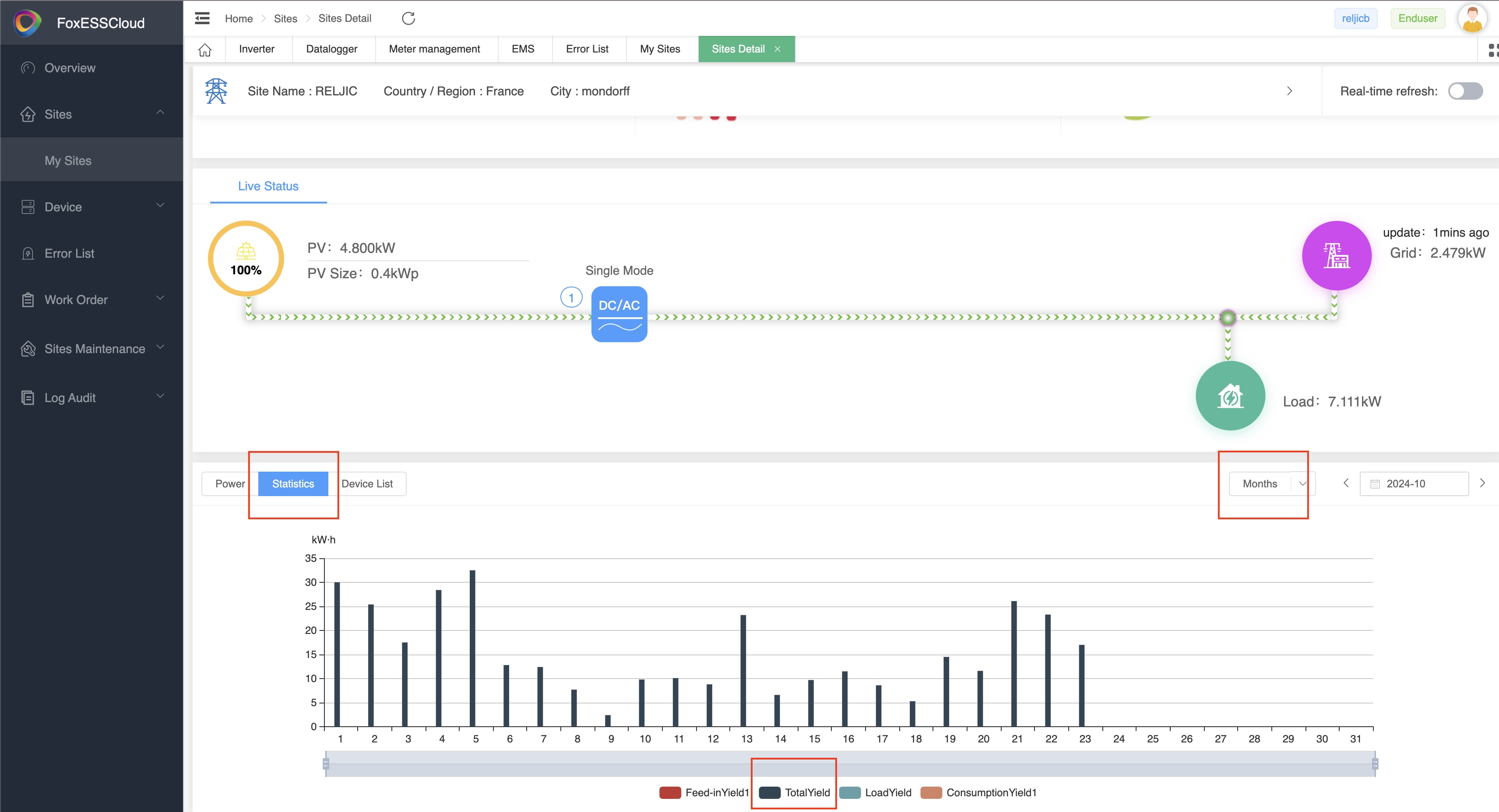

Missing statistics monthly and annual chart
In the site's Statistics page, charts for Days, Months and Years have only the data from the Total Yield metrics, but nothing else (Feed-in, load, consumption).
Is that expected, or there's something wrongly set up by the company who sold the hardware and service to me?

The statistics you have mentioned don't get populated for inverters that are not hybrids with energy storage - i'm not entirely sure why, but that comes direct from Fox themselves.

I have the same issue. I only see some graphs.
I can only see the production of the panels, not the breakdown of how much I consumed and how much was sent to the grid.

I believe you won't see those values unless you have a ct clamp installed and enabled.
