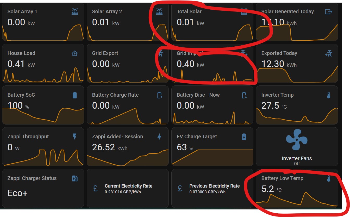

albie999 wrote: ↑Thu Nov 20, 2025 11:05 am I am just totally confused now ..... so, based on the email from Fox that I posted ....... is it saying that basically ... I can either
1) "warm" up the bateries and not be able to charge or discharge (therefore pull from the grid)
or
2) can charge / discharge and power the house but the batteries gradually get colder and colder?
Example now .. that ... pulling from Solar and 100% charge ... but .. battery temp is dropping ... as I have turned off the heating module ... as if I turn it on ..... I then start pulling from grid .. even though I got battery
Anything I can do .. temps are still dropping .. now down to 5.5c ... but cannot turn on heater .. as will draw from grid?

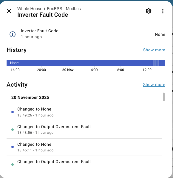

albie999 wrote: ↑Thu Nov 20, 2025 1:53 pm Is just so wierd ... turned on heater to see what would happen (as it is continally getting colder) .. and it just killed everything .. even solar .. and drew from the grid .. no idea at all ... switched heater back off ... and all came back to life
Did you get a fault code when you did that? I had a fault code every 4 min today "Output Over-Current Fault" which went away when I turned the battery heater off.

Re: EP11 with heater
albie999 wrote: ↑Thu Nov 20, 2025 2:37 pm Where would i see the fault codes?
If you use the Modbus integration you should have an entity called sensor.inverter_fault_code.
This was mine (note all the different coloured lines after noon until when I disabled the battery heater:
There will also be something on your inverter display when it's happening if you're brave enough to go out in the cold :D

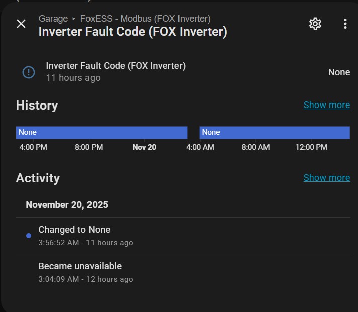

All seemed to be clear for me

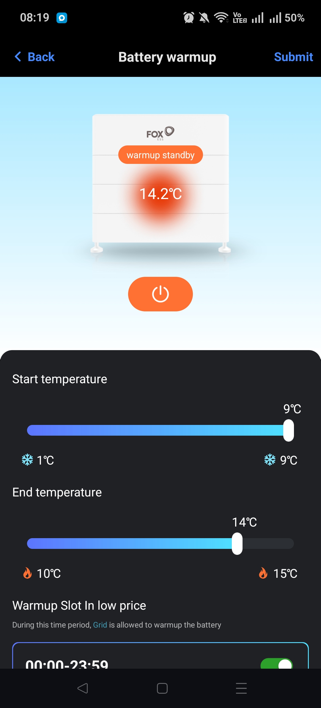

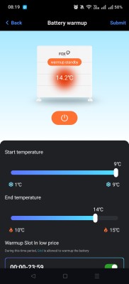

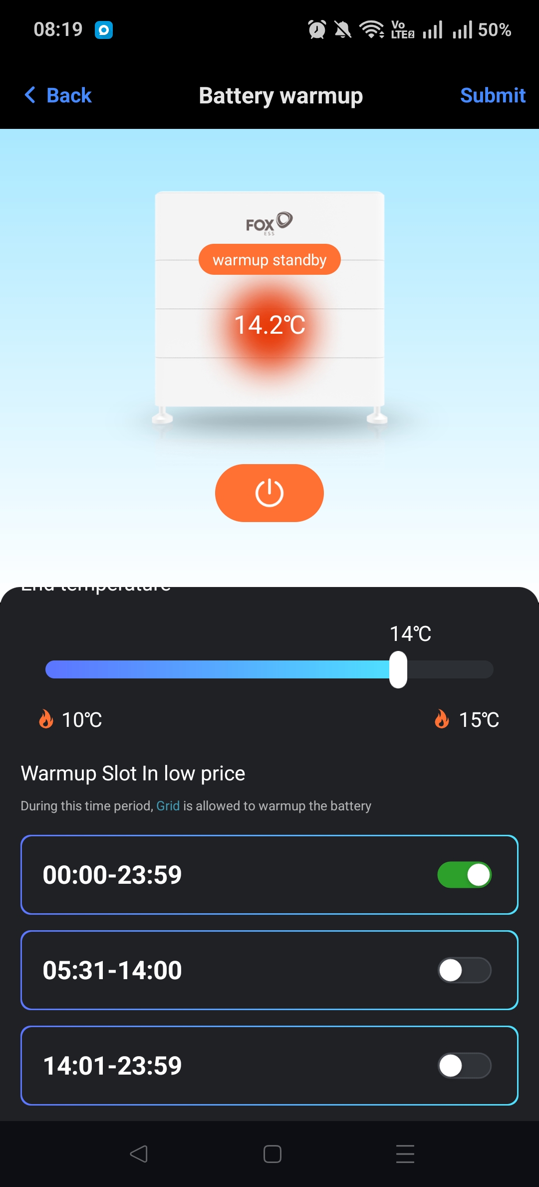

Update - I’ve figured out the warm-up function on my battery is actually working as it should. The problem was operator error. I assumed that if you switched the warm-up function on the battery would ramp the heat up until it hit the upper figure (End) set on the app.
That’s not the case. On my system at least, if you switch the heater on, nothing happens until the temperature falls to the low (Start) slider setting. This triggers the heater_on and the temp rises until it reaches the high (End) slider setting, this triggers heater_off and the battery starts to cool down. The system keeps cycling between these two temperatures.
I originally had the ‘Start’ slider at 3° and the ‘End’ slider at 15°. While investigating I set the ‘Start’ slider to 8° when the battery cells actual temp was around 5°, the heater started immediately and slowly rose to 15°.
I’ve been monitoring this all day before posting, and it’s cycled up/down using different high and low temperatures 3 or 4 times, so I’m confident it’s correct. A few things to note -
1. I set the upper temp to 15°, it actually goes up about 1° above that.
2. If you set (Submit) new ‘Start’ and ‘End’ temperatures at any time in this cycle the heater switches off, even if it’s still rising, and you have to wait until the battery drops to the ‘Start’ setting again before the heater switches on again.
3. Although ‘Warmup slot in low price’ is set nothing was taken from the grid. The most drawn from the grid shown on the app was never more than 20w all day, and I’m led to believe the heater is 200-300w. Little or no PV today so the battery was providing the power for the heater.

Set mine as per screenshots yesterday and it now seems to be working more reliably

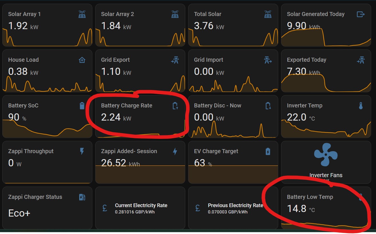

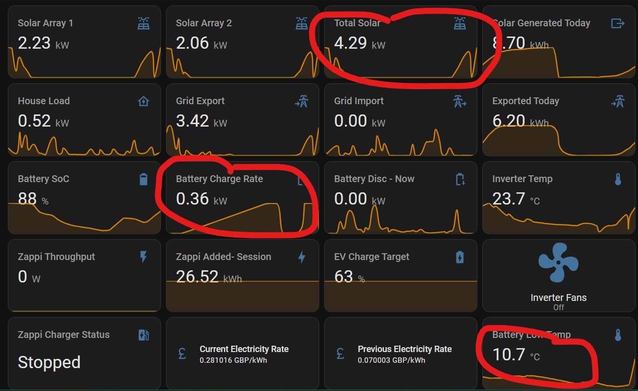

My EP11 batteries start warming when PV is above 1kw and can push around 700w into the batteries after house base load. The heating just doesn't work reliably from internal battery or grid power. I'm waiting for the 1.009 firmware upgrade to see if that makes any difference.

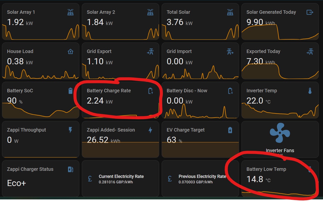

So, this morning Fox updated the firmware on my inverter and also on the EP11 battery (to 1.009). I have enabled the battery warmup function, and it does look like my battery is now warming ... gone up 6c in the last hour :-) ... as well as allowing the solar to function ... and some battery charge (although for some reason ... the battery is only charging slowly .. even though a lot of solar is available) ... wonder if these could still be an issue with warming and charging/discharging?
So .. for now ... things do seem to be better
For info .. as soon as the battery heated up and the heater auto turned off ... the battery charge rate jumped up .. so there does still seem to be a minor issue

Will has been speaking with Fox and confirmed the 1.009 firmware is where you should be, also the actual operation is slightly different than I thought, so worth watching this video and note the 40% SoC limit. https://youtu.be/_9hNCI1bTP4?si=oC4khit641SJd2TM

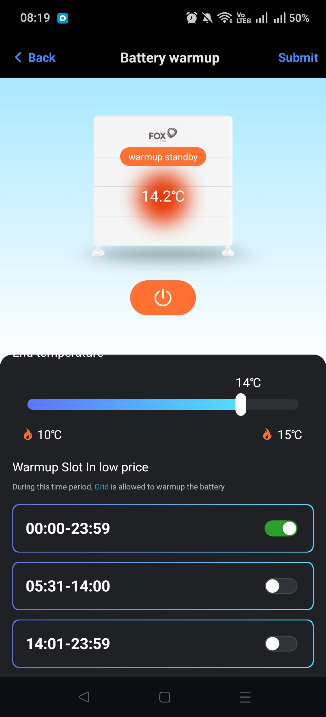

RussJH wrote: ↑Fri Nov 21, 2025 8:21 am Set mine as per screenshots yesterday and it now seems to be working more reliably
Confirm mine has now warmed itself 3-4 times per day with the settings previously shown.
Currently on 1.07 but have asked to upgrade to 1.09
I can't see the point in not having charge from grid set for 24 hours. If you are below 40% during the day and there is no PV, then the battery won't warm.
