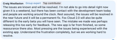

Clearly a lot of users are getting on to them, this has just come out from the UK support lead

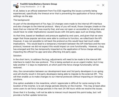

Please see the latest update and statement from FoxESS, click on the image to enlarge

Dave Foster wrote: ↑Sun Jan 07, 2024 11:08 am Please see the latest update and statement from FoxESS, click on the image to enlarge
I think this is important: they can claim that the API/protocol is internal all they like (though I think there really should be a public, documented, supported API), but each time this has happened their own public website, www.foxesscloud.com, gets exactly the same error. And as far as I can tell, immediately so, not later due to some rollback. Surely third parties cannot be blamed for that.
More recently: it was working earlier in the week. What did they change *on Friday evening* to break it, knowing that there have been problems with it only a few weeks earlier?

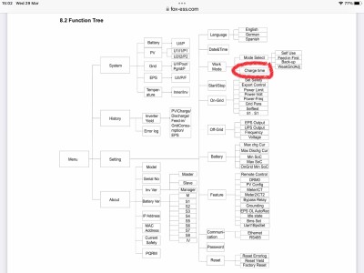

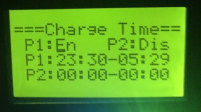

I have copied my post from the previous page as guidance for those that wish to set the charge periods through the inverter panel - the inverter will continue to be fully functional.
I am told that for those on the latest firmware and using the Energy Stats app it is possible to set schedules to Force Charge - but the normal charge periods continue to time out.
You can however change the normal charge periods 1 & 2 at the inverter panel in Settings, Work Mode, Charge Time (the inverter passcode is usually 0,0,0,0).
Set P1 or P2 times to whatever you want (or reset them by setting to 00:00-00:00)
Then make sure it is set to En (enabled) for grid charge, or Dis (disabled) to turn off
Fig 1. Inverter menu structure from the front panel (charge period highlighted)
Fig 2. This is what the charge period settings look like at the inverter panel with charge period 1 (P1) set to 23:30-05:29 and grid charge (En)abled
