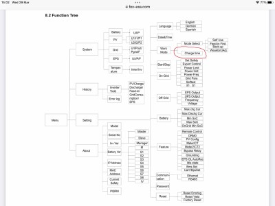

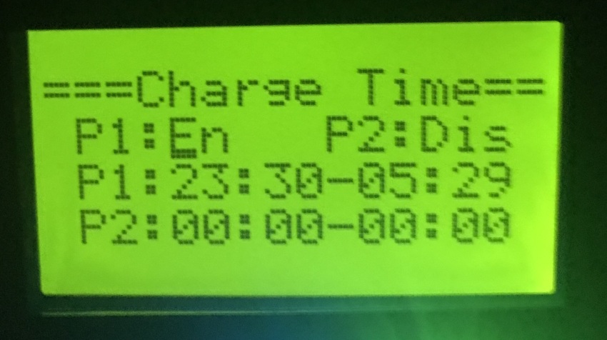

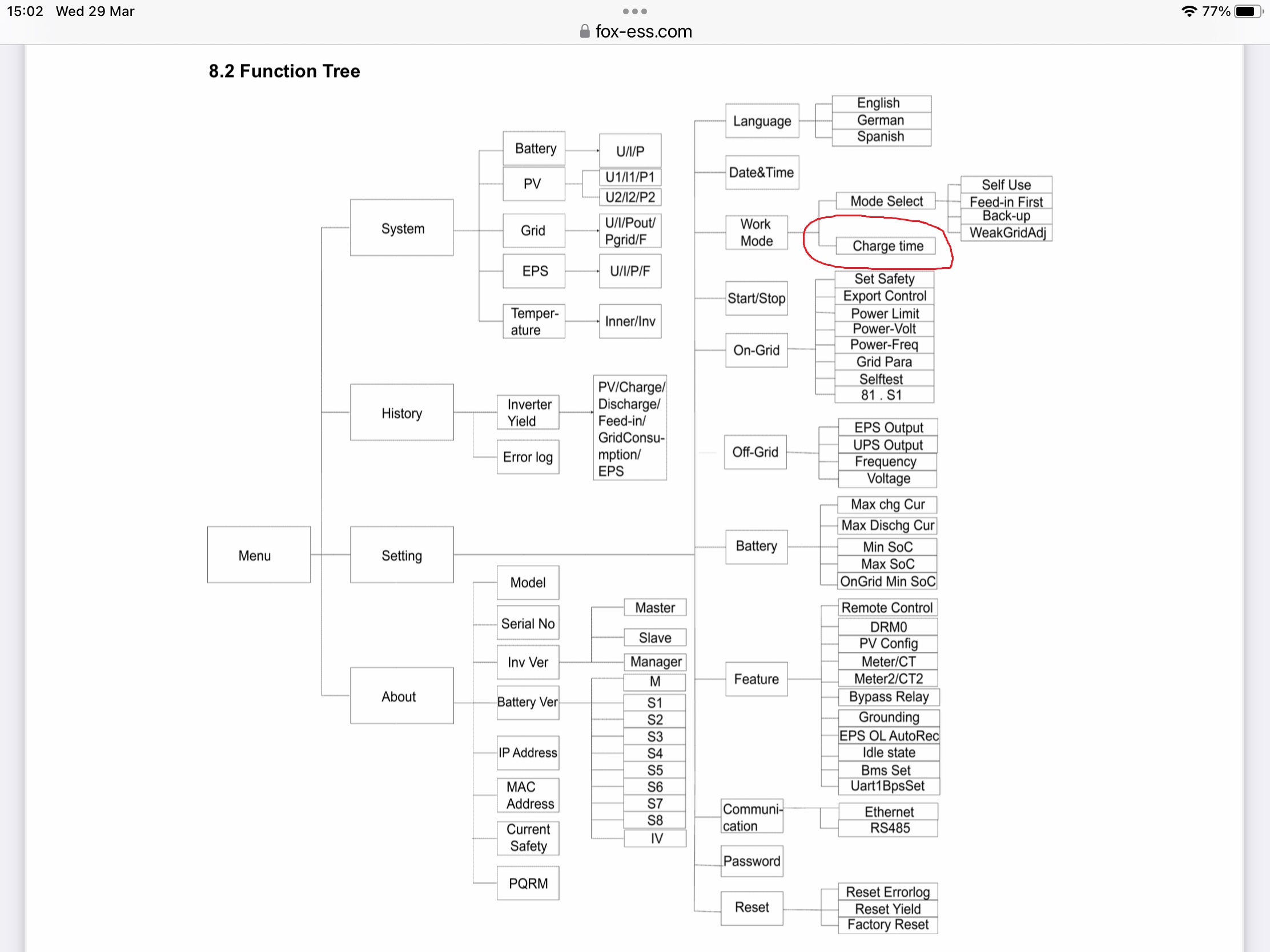

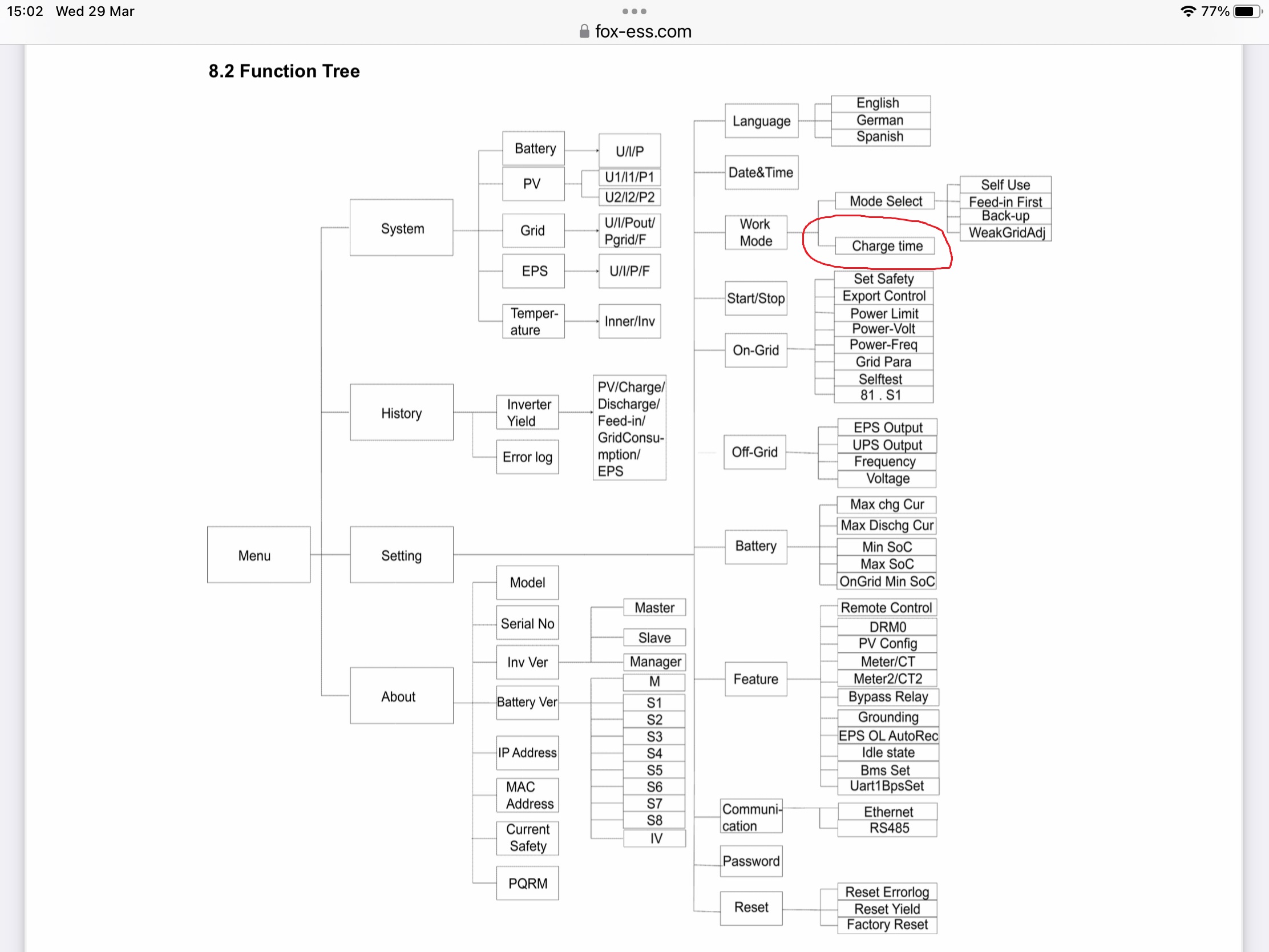

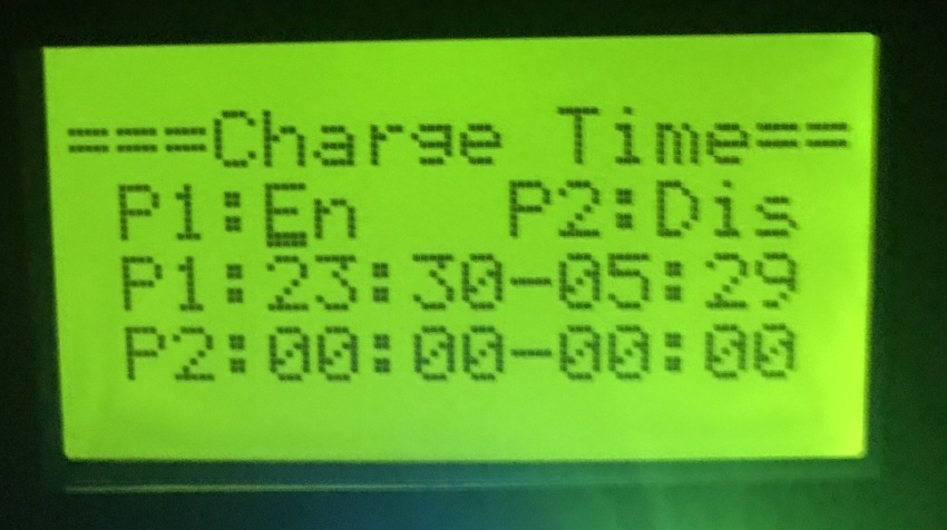

Whilst Foxess are sorting the cloud problems I can't help much other than to post guidance for setting charge periods through the inverter panel - I hope this is of help.
As the app isn't allowing charge periods to be set, it is possible (but fiddly) to set the charge periods at the inverter panel.
I gather that for those on the latest firmware and using the Energy Stats app it is possible to set schedules to Force Charge - but normal charge periods are timing out.
You can change the charge times at the inverter panel in Settings, Work Mode, Charge Time (the inverter passcode is usually 0,0,0,0).
Set P1 or P2 times to whatever you want (or reset them by setting to 00:00-00:00)
Then make sure it is set to En (enabled) for grid charge, or Dis (disabled) to turn off
Fig 1. Inverter menu structure from the front panel (charge period highlighted)
Fig 2. This is what the charge period settings look like at the inverter panel with charge period 1 (P1) set to 23:30-05:29 and grid charge (En)abled
