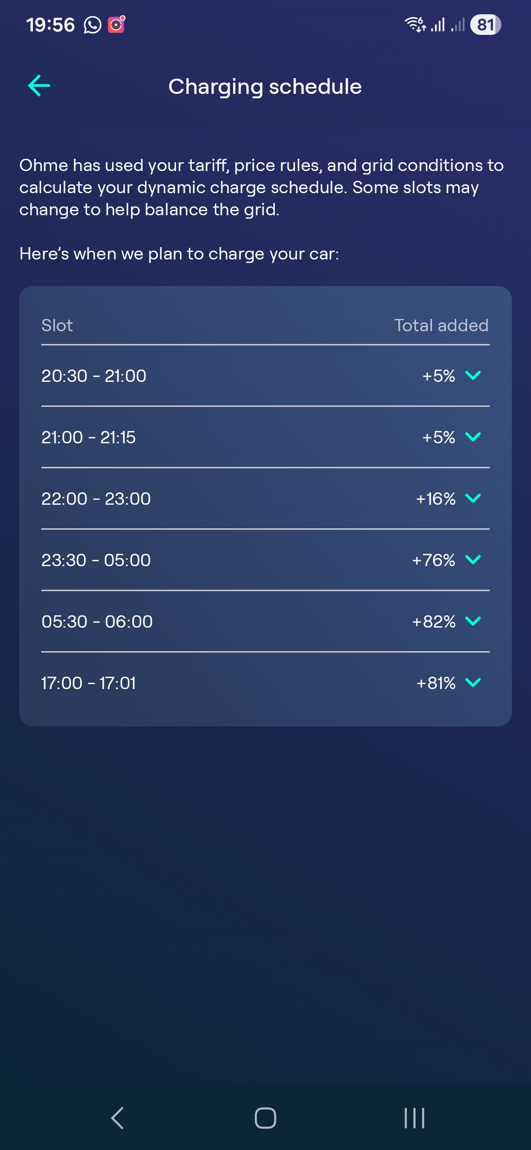

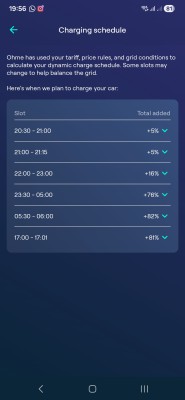

Out of curiosity what's the max import load from the grid on a single phase domestic supply like mine?
Can it handle 7.5k on the car and 5k on the battery charging simultaneously?
Lastly below is my scheduled charge for tonight...
The solar battery is scheduled to dump at 10.30pm so which will take preference the dumping or the car charging?

nadlad1984 wrote: ↑Tue Oct 21, 2025 8:00 pm
When you dump your battery to the grid any appliance in front of it will think you are exporting so if your EV charger is capable of starting when it sees excess solar it would start charging, if you use an iboost it would start heating your water etc..
Your grid connection is effectively a single 'pipe' it can suck or blow, but not do both at the same time, if your EV is charging when you are dumping your battery your battery power will be used by the EV so best to find a time to dump when the EV is likely not to be plugged in or charging.

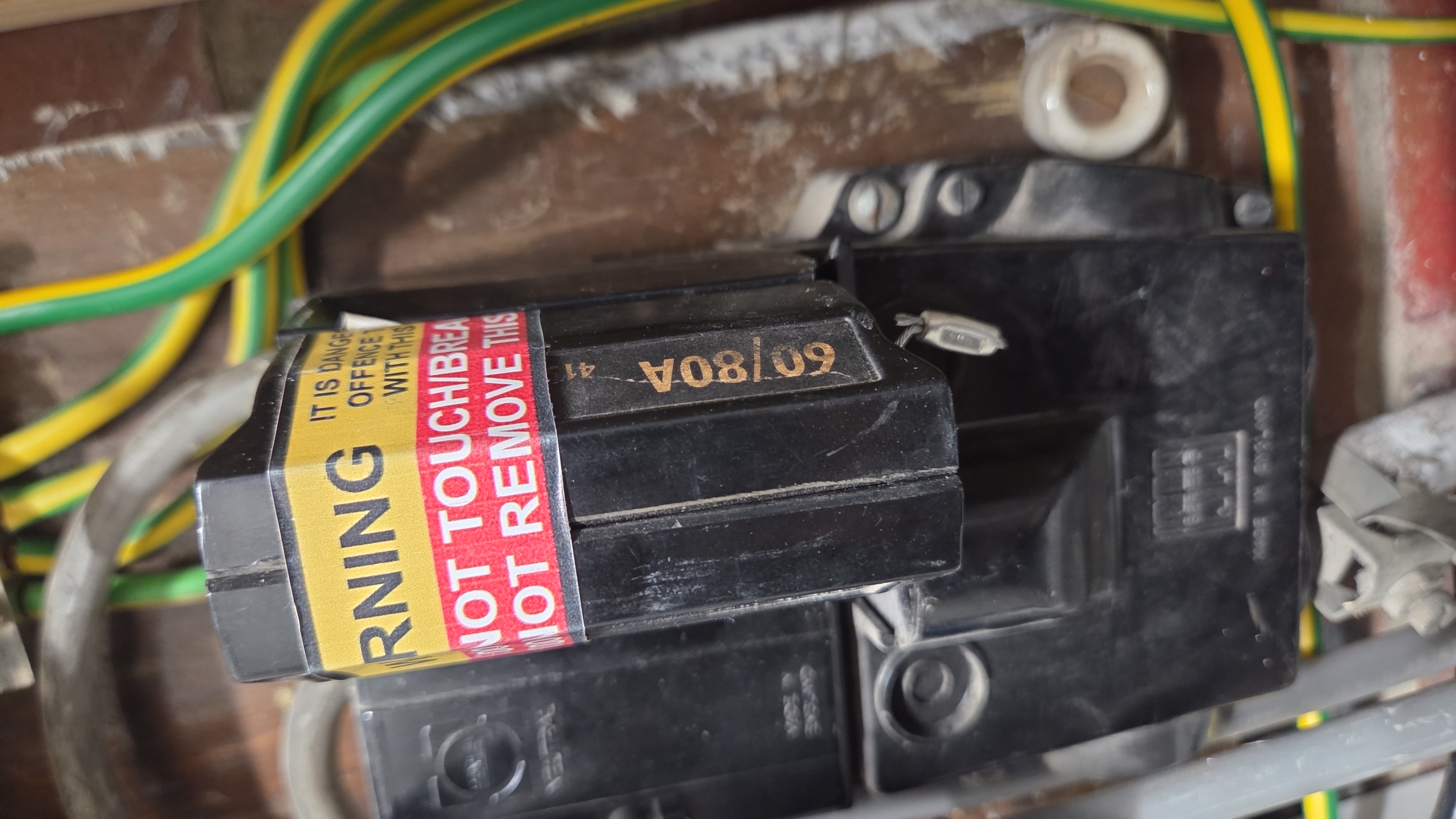

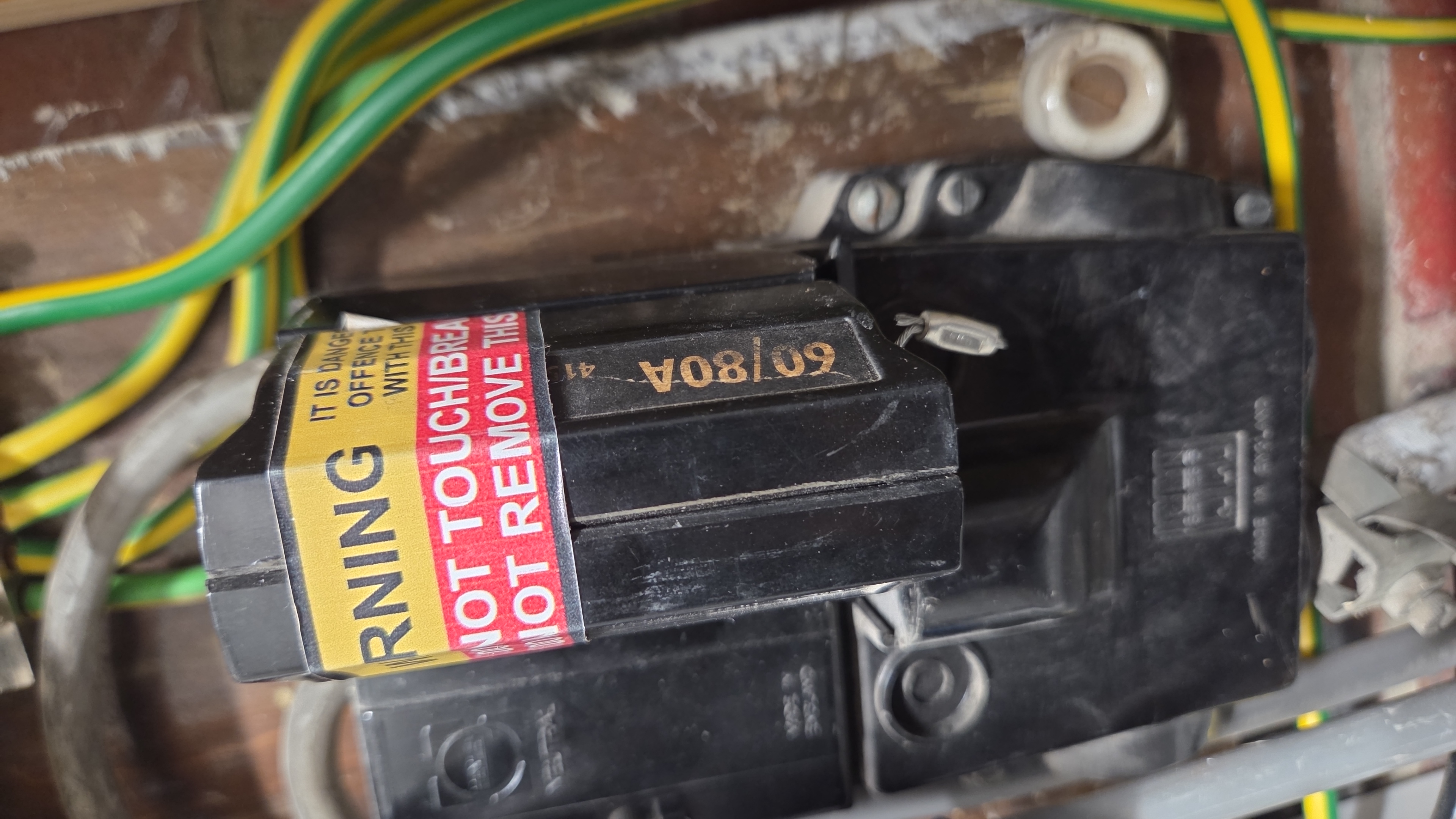

Is this 60 or 80 app breaker...
Re: Octopus Dynamic EV Charging without draining my battery
nadlad1984 wrote: ↑Wed Oct 22, 2025 9:07 pm Is this 60 or 80 app breaker...
One thing for sure is that it isn’t a 100A fuse… but unless there are any other markings only your DNO will know for sure what fuse has been fitted to the carrier.
The person who installed your EV charger should know as they would have done an assessment on the property as part of the install, and it will likely throttle the EV charger if you are using a lot of power at the same time.
I asked my DNO to upgrade my 60 amp fuse to 100a
They are UKPN
They asked for pictures of the current installation
They assess the setup and determine if it’s possible
A week later they were onsite
Changed the fuse unit that was 50 years old for a 100A new unit
All FOC! I
