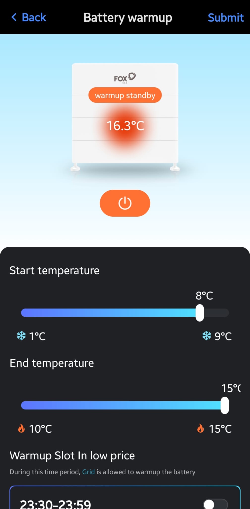

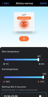

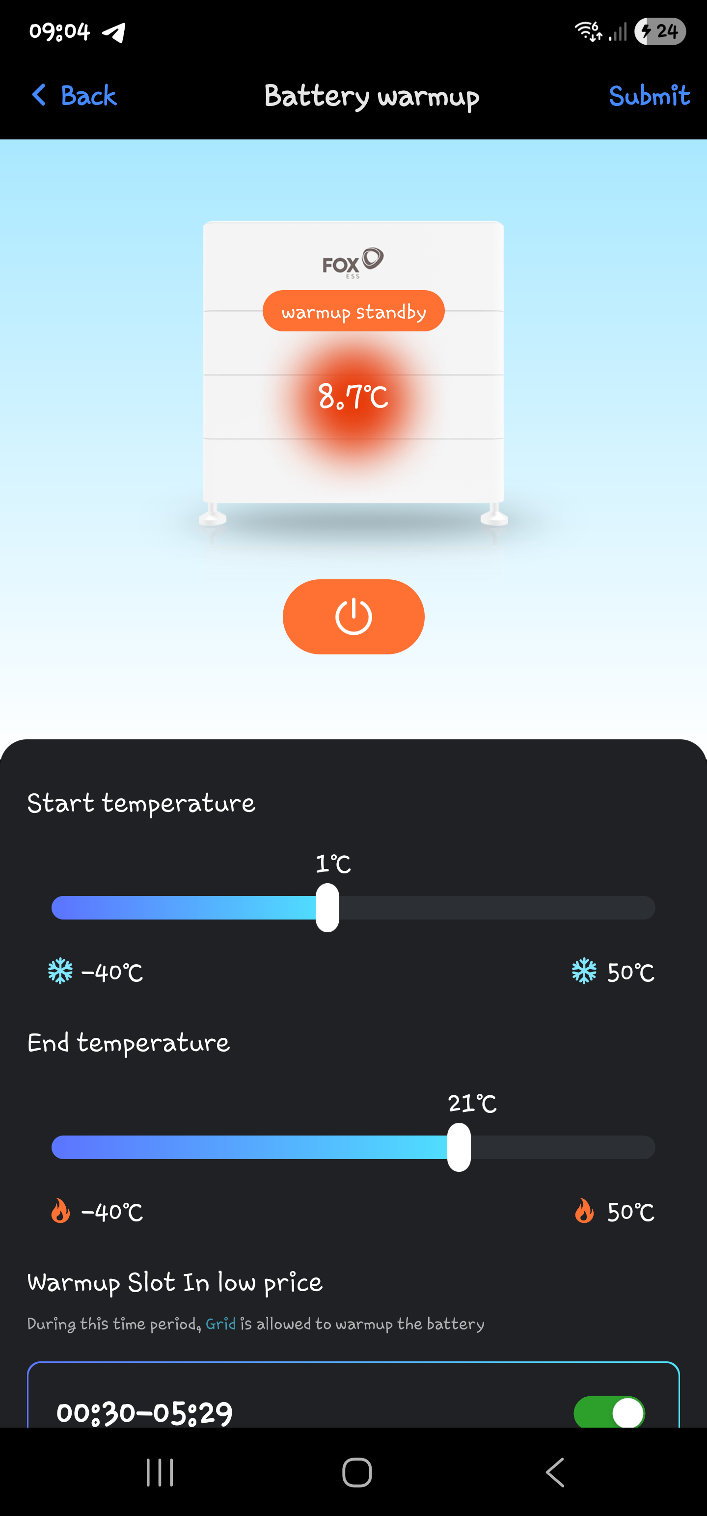

On a side note, in my phone app, I can set a range of temperatures from -40C to 50C for both ranges... that never seemed right to me, and in the picture above the temperature range isn't the same.

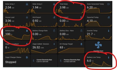

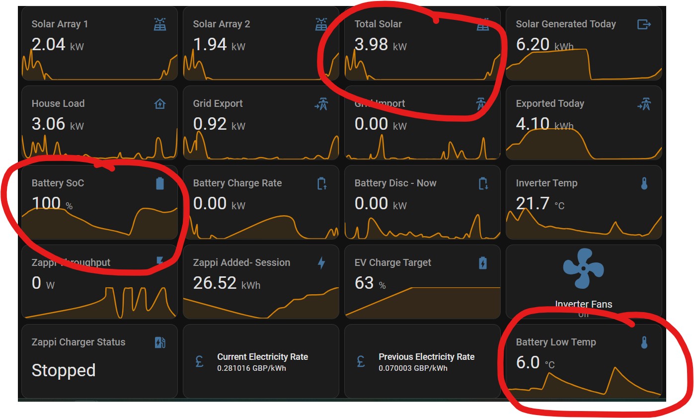

So the battery is heating now...
But why did it drop down to under 7oC before it started heating, when set to 9oC!?
https://ibb.co/BY6GH8V

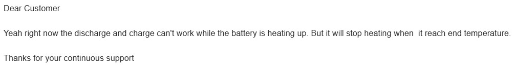

Nope ... does not seem to be heating ... it is showing it is heating .. but the temperature is not increasing. I have switched off the heater, and now my battery is discharging like it should .. temperature is staying stable at 7.9c for now

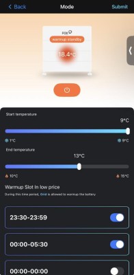

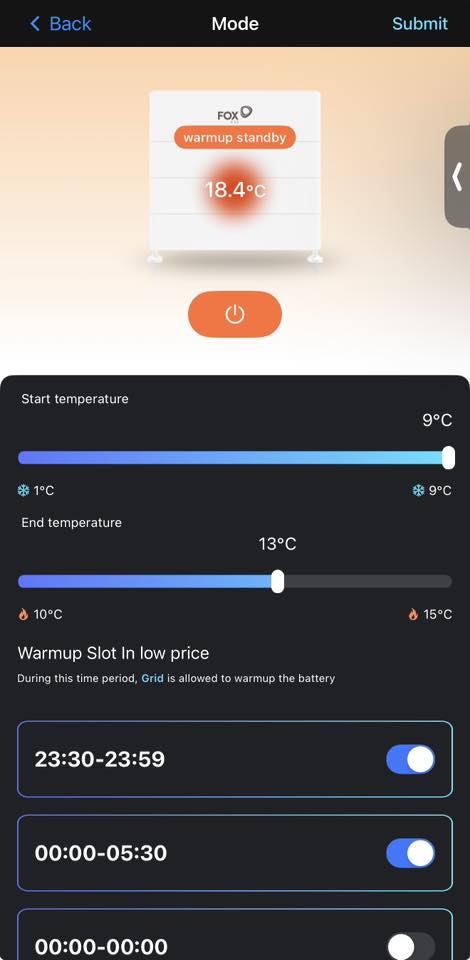

Fox just confirmed that he grid time should be 0000-2359, but that does not explain why its warming up now then?
"Warmup slot in low price" is bit misleading!
My EP11s heating did kick in, so I've maxxed out the heating to 15c now! The heating range on my Fox app is shown on the attached picture which is the same as Craig's video:

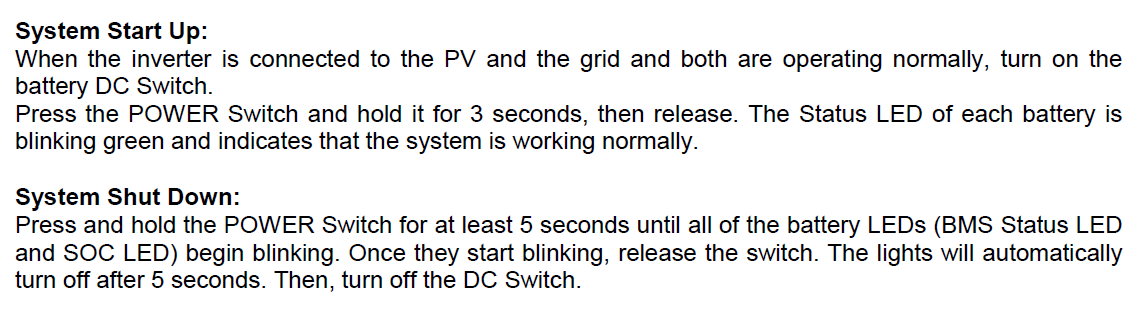

How are people rebooting their batteries to see if that makes any difference? My manual says I can do a battery shut-down and start up as per attached (hold power switch for 5 seconds etc and then start again with another 3 second power switch press)? Is anyone fully resetting their inverter as well? I've got a DC switch on the battery - I'm assuming I can leave that alone when doing the battery power switch reset? Any advice or insight is appreciated! TIA.
Thanks MB48 - Recycled the system, no change. Battery temp is still plummeting.

Have you set the warmup slot grid time to 0000-2359?Ferryhill9 wrote: ↑Thu Nov 20, 2025 10:34 am Thanks MB48 - Recycled the system, no change. Battery temp is still plummeting.![]()
Not sure what to do next, when I approached my installer about the firmware update they pointed me to Fox. The problem as I see it is Fox has released a product that’s not fit for purpose. I’m sure many people are deciding where to have the battery/inverter installed at least partly based on the warm-up function feature, I know I did.
Yes, it was originally set to 00:01-23:59, I set it to 0000-2359 as suggested in the thread. No difference.oxfordmark wrote: ↑Thu Nov 20, 2025 10:45 amHave you set the warmup slot grid time to 0000-2359?Ferryhill9 wrote: ↑Thu Nov 20, 2025 10:34 am Thanks MB48 - Recycled the system, no change. Battery temp is still plummeting.![]()

I am just totally confused now ..... so, based on the email from Fox that I posted ....... is it saying that basically ... I can either
1) "warm" up the bateries and not be able to charge or discharge (therefore pull from the grid)
or
2) can charge / discharge and power the house but the batteries gradually get colder and colder?
Example now .. that ... pulling from Solar and 100% charge ... but .. battery temp is dropping ... as I have turned off the heating module ... as if I turn it on ..... I then start pulling from grid .. even though I got battery
