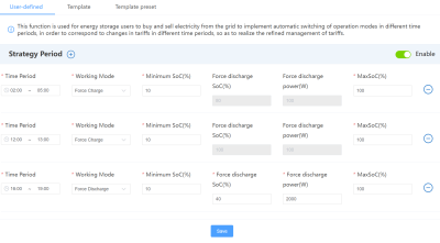

Hi all,

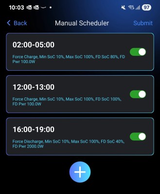

I'm very new to this, and have just had the firmware updated on my battery/inverter, to allow Mode Scheduler to work. I have a Forced Charge set up between 2am and 5am, Force discharge between 4pm and 7pm, and a floating force charge (currently set 12pm to 1pm) to cover free electricity sessions (Octopus, of course).
The discharge from 4-7 appeared to work the other day, but I can't seem to get the force charge to work. I've attached screenshots from both web and mobile app - can anyone confirm it all looks reasonable, and if so, what my next steps might be?

I can’t see anything wrong with your Force Charge settings, the FDSoC and FDPwr are not used by it (but must be set with a credible value).
I heard this morning there may be problems with latest firmware and schedules not working, but i’m also wondering whether it may be this setting which has been a problem for quite a few users recently - if you read this post and check to see what your importpowerlimit is set to. viewtopic.php?p=9414#p9414

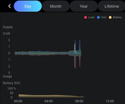

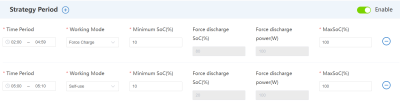

Hi Dave, and all...
Quick update - Force Discharge appears to be working perfectly; combined with my solar output I got up to 6kWh export between 12-1pm yesterday!
Force Charge though is a different story. I think I have it set correctly in Mode Scheduler - I also read online somewhere that it may also be beneficial to add a short Self-Use schedule immediately afterwards, to force it back into Self-Use mode? So attached are my Mode Scheduler entries, and a screenshot from the app of power in/out last night.
One thing to note is that I did schedule my dishwasher at 2am also, on a 60C "quick" wash ("quick" means 1hr 45min!). Could that be screwing up what's happening? Happy to try it again tonight without the dishwasher?
Cheers for any ideas!
David.

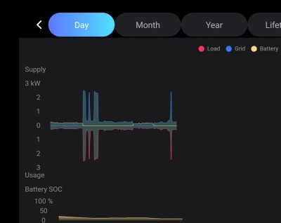

I'm an idiot, sorry - I just realised I cut off the time part of the graph... the two or three spikes close together occurred between 2am and 3am - hope that helps!
I'm really an idiot! And sorry for the confusion... Yesterday's 6kWh during the free session was a force charge, not discharge of course! So now I'm even more confused... Why would a force charge work during the day (I had other loads turned on, immersion heater, kettle, etc), but not at night?!

Hi Dave,
Still no charge, but I did notice that battery usage for the regular background load on the house dropped to 0, so everything was coming from the grid... Looks like my original screenshot from the other night shows the same, but worth the dishwasher running the other lines on the graph distracted me! Here's the one from last night, scheduled force charge from 02:00 to 04:59.

It’s definitely seeing the schedule as it shuts down battery use so we know the schedules are running.
I had heard that the latest firmware for KH and H inverters caused problems with schedules, but also just heard that FDPwr on latest firmware is being used to control charge as well as discharge power - sorry can’t confirm that yet, i’m trying to find out more (it might simply be a bug)./
You started the thread with i’ve just had my firmware updated so it’s worth trying with FDPwr set to confirm it, you can’t set FDPwr on the website but you can in the app - try setting your force charge schedule with an FDPwr of (say) 4000 watts and lets see what happens tonight.

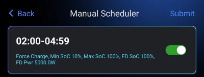

Hi again Dave,
Thanks so much once more! I had noticed that FDPwr was available in the app for all modes, but only for force discharge on the web (which makes more sense). Will update that for tonight, and let you know here! Have you considered setting up a "buy me a coffee" fund?!

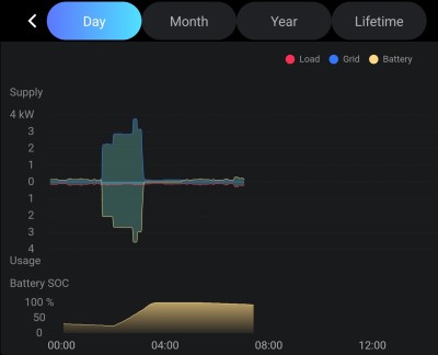

Hi Dave,
Can you believe it, that worked!!!
Thank you so much for all your suggestions and help! Just to confirm, this was setting the FDPwr to 5000W (had to be done in the app, as it's greyed out in the web version for force charge).

That’s great and confirms what I had been hearing on latest firmware. I’m still not sure whether that is a bug or has been added as a feature (arguably a long overdue one) but at least we know for sure - happy charging

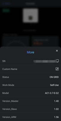

I can also confirm that FD Power controls both Force Charge & Force Discharge in the latest version of the app.
I have a H1-5.0-E-G2 running Master 1.40, Slave 1.04, ARM 1.56

Running ARM 1.58, Master 1.43, Slave 1.04 on a H1G2, it seems that FDSoC also has an effect on force charging, overnight using mode scheduling for forced charge with Max SoC set to 100% and FDSoC set to 80% the battery charged to 80% then held until the end of the time period.
It seems that regards mode scheduler both "Quick Settings" on the portal and the App no longer truly reflect the function of these values. I've seen on an installer's login, under Devices->device Details-> Settings FDSoc is now referred to as FC/FDSoC, FDPWR now referred to as FC/FDPWR and MaxSoC is referred to as "Max SoC from Grid" although under "Quick settings->Mode Scheduler" the old descriptions are still used and FDSoc & FDPwr cannot be changed unless "Force Discharge" is selected.
Manager(ARM):1.79
Master:1.59
BMS:1.013
Manager(ARM):1.79
Master:1.59
BMS:1.013
