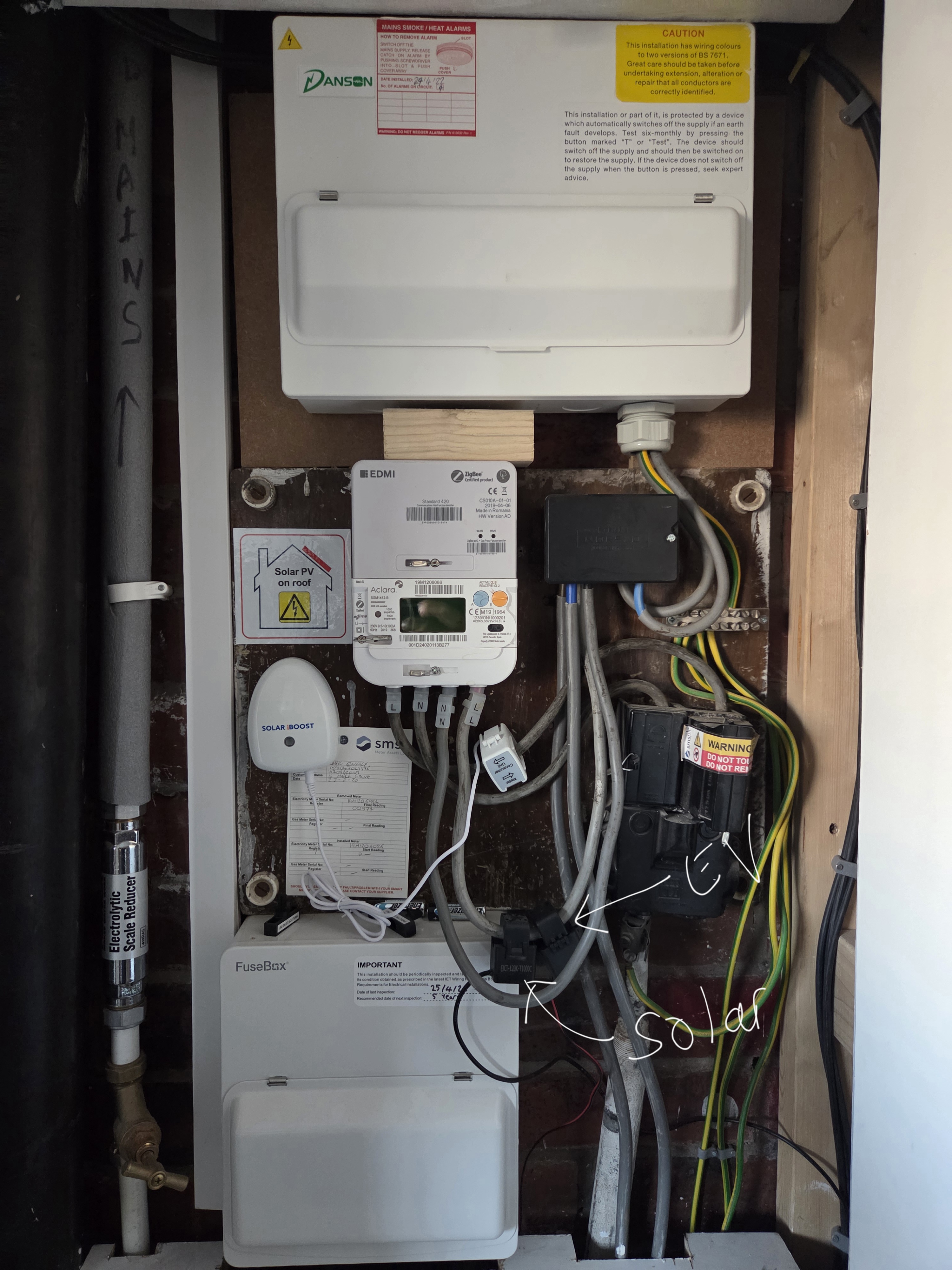

Another new user of solar here, been installed for a week.
My setup is as per the diagram, except clamp difference on Zappi and Solar positions, with my Zappi charger CU wired off a Henley block and it’s CT clamp on the live cable that’s between the DNO fuse and the smart meter, arrow facing into the property.
The FOX CU is also wired into the Henley block as is the house CU.
The Fox CT clamp is on the live cable between the smart meter and the Henley block, arrow facing towards the grid,
I also installed another CT clamp off a Harvi, that sits between the Solar CU and the Henley block, arrow facing towards the Henley block.

Can you take a picture of your meter cupboard showing the cables, henley block etc.. - from what you have said the inverter CT clamp is in the wrong place (with an EV charger) where the Henley block splits the power to go to the EV and the House/Inverter it should be on the House/Inverter live cable.
Re: Octopus Dynamic EV Charging without draining my battery
Thanks Dave, Myenergi have just come back with the same observation. Thats where the solar sparky placed it.
I will move and try to see what happens.
Will I lose any functionality on re fox app ?
Any issue having the 2 clamps on the same section of cable ? They can be separated by a couple of foot.
Yes that's in the wrong place it will see all load wired there.
It's not entirely clear from the image as to where all the henley block connections go, the important thing is that the Fox CT clamp must see both the house load and the inverter feed when clipped to a single cable.
If the house/inverter are being joined at that larger henley block you will need to get them to install a small henley block that connects the 2 live feeds together with a single core to connect to the other henley block and the Fox CT clipped here.
Thanks Dave, I did realise it was seeing all load in that position.
The 3 CUs are all connected to that one Henley block.
So placing the clamp on the other side of the Henley to Inverter CU will only see load from inverter and no house load, so agree it needs another Henley in the position you describe.
Many thanks for the feedback and support.

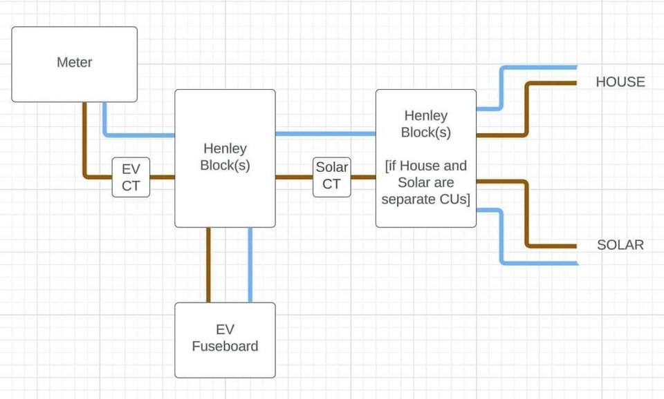

Just an image for anyone looking for setup to separate EV charger from house load and battery, now that it’s been rewired adding new Henley blocks, with house CU & solar CU wired to new Henley’s and then live/neutral to existing Henley which EV CU is connected to.
Placement of clamps 1. EV charger CT, direction i/c to house from grid, 2. Solar CT between Henley blocks, direction towards grid, 3. Another EV CT direction towards grid, this is for an extra monitor point for Myenergi app.showing AC generation from inverter
Now Fox system cannot see the EV charger load so does not discharge when EV calls for power.

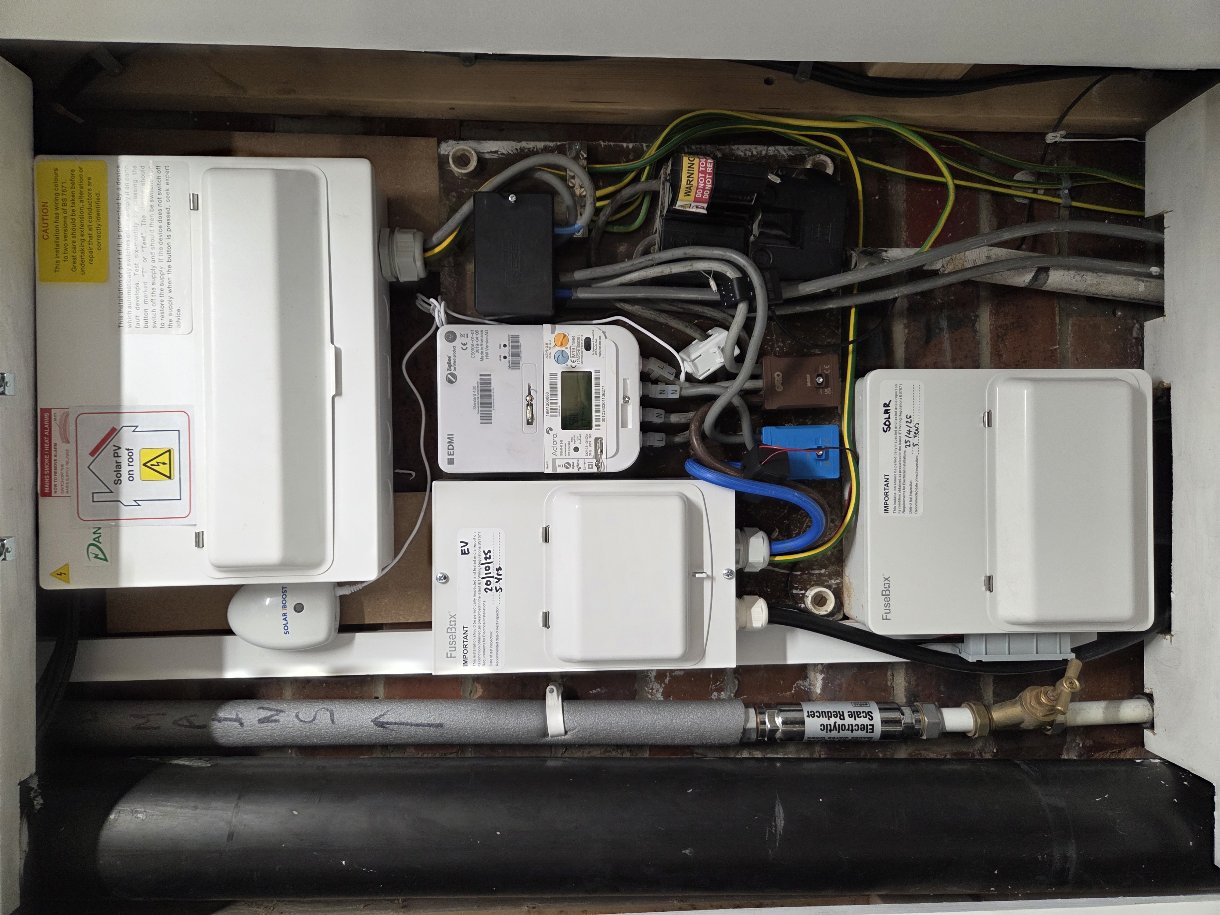

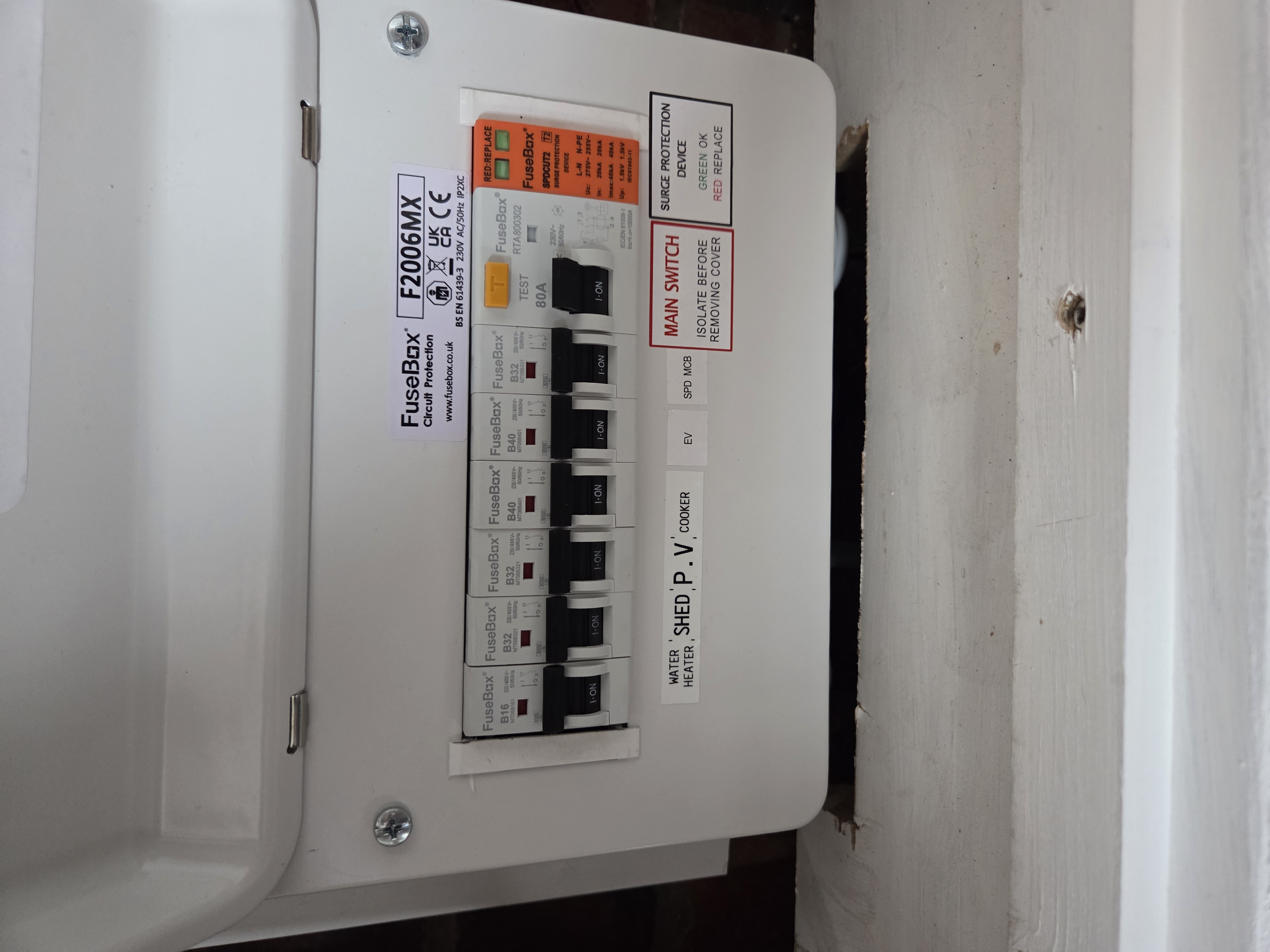

Hi Dave, thankyou for your message this is my current setup top consumer unit is house and bottom one is for solar and ev. Should I move the ev charger breaker to the house unit and then where would the clamp be positioned.
Can you add a description for the where the solar power is connected and also the EV.
It looks like the solar consumer is at the bottom and connects to the Henley block where it splits to go to the house consumer and the smart meter - is that correct ?, I can't see where the EV feed is taken and that's the important one.
Hi Dave thankyou for the quick repost this forum is great!
So the bottom board is the ev board as pictured. The bottom board is fed fin the Henry block you can see the 2 grey cables running down the side i think!
The solar and the ev are both in the same bottom consumer unit.
Ahh that's a problem, there's nothing you can do about the CT clamps to solve the problem with the EV charger being taken off at that point - the only option you would have for now is to disable smart charging on IOG and set your home battery and EV to charge at the same time.
To fix this correctly so that you can use IOG to start and stop randomly as it does you would need to remove the EV feed from there, split the feed from the smart meter via another Henley block and wire the EV via a breaker to that (as per this post download/file.php?id=2025&mode=view) - it's a pain but your EV installer should have known that.
Do you have home assistant ?, my home is wired like yours which would flatten the home battery when the EV charges, but with home assistant I have an automation that looks at the state of the Octopus tariff and when it goes low it sets my minsoc to 100% which stops the discharge (and slow charges the battery).

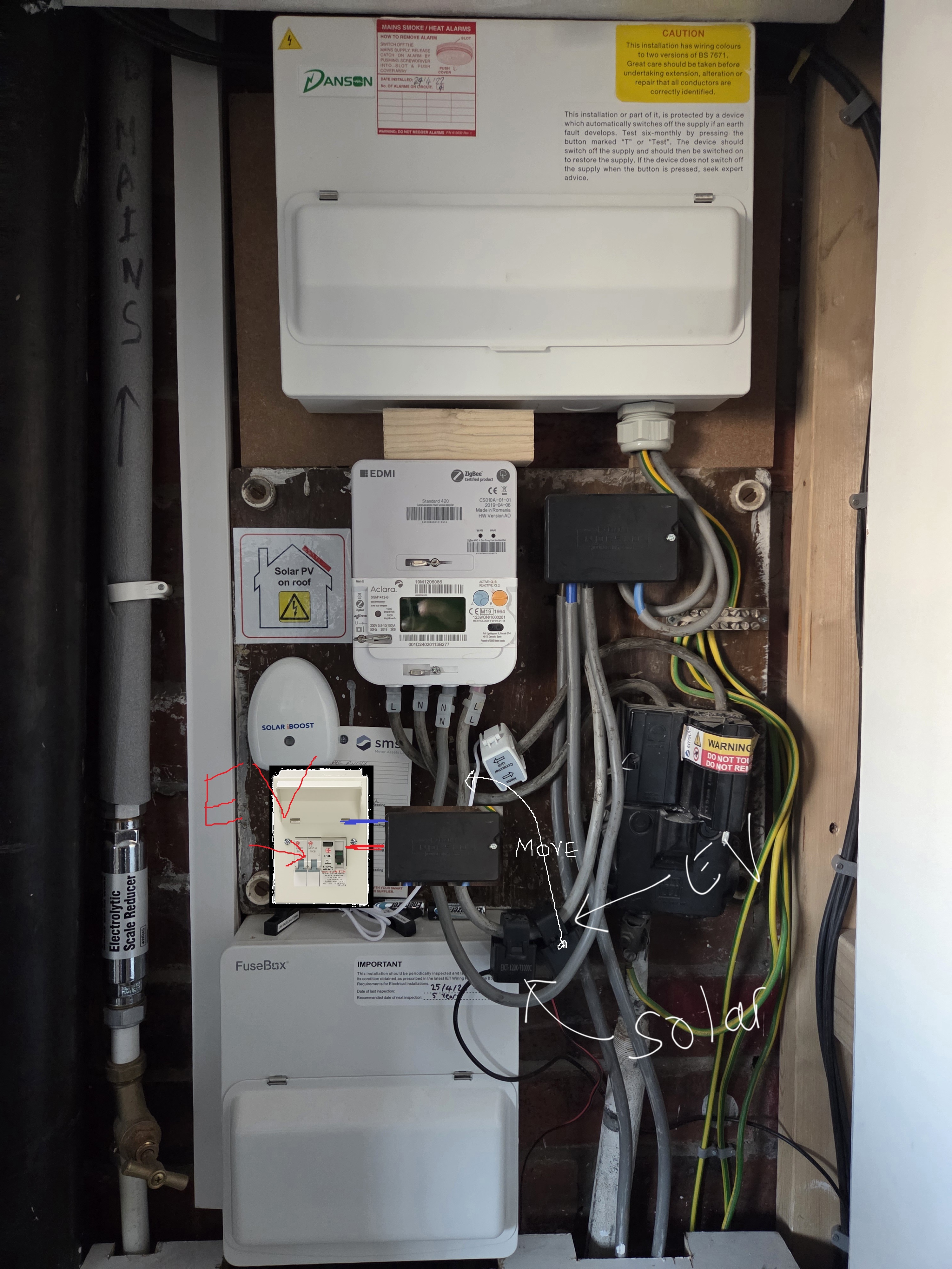

No don’t move the EV breaker to the main consumer as that would still be seen by the inverter as house load.
In effect what you need an electrician to do is to install a small distribution box with the single breaker to the EV charger which is connected to another Henley block which needs to be added to split the feed between the smart meter to the existing henley block.
For now as long as you set a charge period whenever your EV is plugged in, your home battery will be protected.
nadlad1984 wrote: Sun Oct 19, 2025 2:52 pm Hi dave,
Appreciate the help, i have spoken to the sparky, he can do the above, but he did say adding a second henley will be doing the same thing as the 1st one, as in why can you not connect directly into the spares on the 1st block and then into a new DB board
Not quite, it's actually about where the inverters CT connection is as it needs to be able to see all of the load of the existing 2 consumer units but not the EV load - the only way to do that is to use the existing Henley block to make a single connection that the inverters CT can be clipped to before it gets to the new Henley block where the EV is connected; that way the EV load will be on the grid side of the inverter CT clamp and it cannot be seen.
Note the EV CT clamp needs to be moved as shown once it is re-wired but leave the inverters CT clamp where it is.
Otherwise once this is done, will IOG charge directly from the grid at all times and not take batter.
And my current stored battery settings which are 2 hrs 3am to 5am will not be disturbed.
Finally if and most likely when the car wants to charge through a slot in the early hours simultaneously to the force charge of the battery would it just evenly distribute charge
thanks
Yes once this is done, your EV will charge without disturbing your inverter at whatever times IOG starts instructs it to and you can leave your inverter charge time settings to be whatever you want to suit your low tariff.
