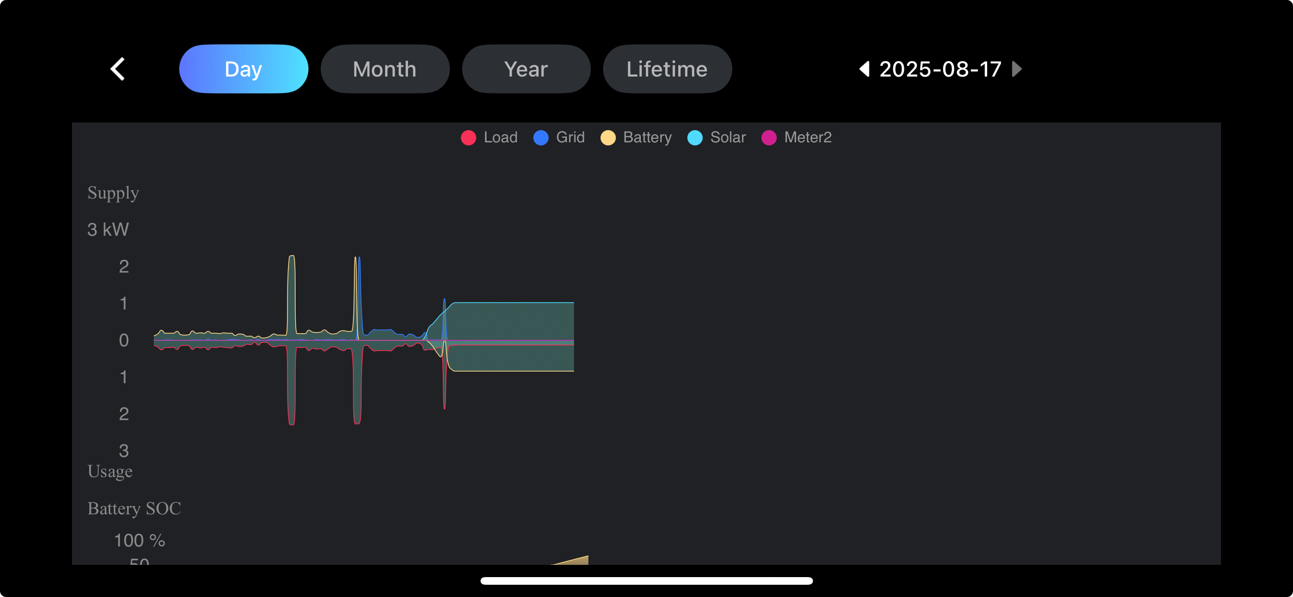

PV Power has halted at just oner 1 kW
PV output got stuck at just over 1kW at 7am in the morning. The reading has been static for 3 hours. Based on recent other sunny days it should be producting nearly 3kW by this time of day.
Any ideas why the output has levelled out? And by levelled out, I mean absolutely no variation from 1.02kW.

What inverter / battery system is this ?
Also can you check and post your firmware versions click on Device, Inverter, then click the serial number just below the image and it will show your Master and ARM versions.
Flat lining at that level plus the weird battery ‘charging’ would suggest the Manager/ARM has crashed which would require a shutdown / restart to correct.

I think this is a communications problem. As you identified the battery is charging. And I've had appliances on at over 3kW and they are working without drawing on the battery or grid. In other words perhaps the App is not collecting data from the inverter correctly.

The data is the same on the mobile app as on the web interface. Closing and re-opening the app didn't solve it.
