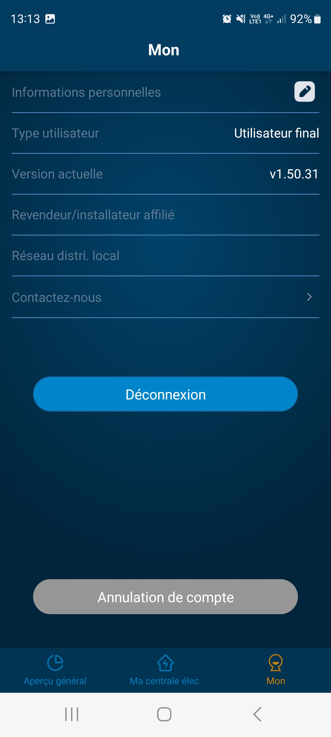

Hello, I have a 6kW installation with a hybrid inverter and battery.
For several days, the data on the Foxcloud 2.0 application has been giving me incorrect values in daytime mode. The incorrect values are for my consumption and my return to EDF. The correct values are only those of the solar panel production. Is there a bug? Is there a fix planned soon? Thank you

Alors qu avec une autre version fox cloud 1.5 les donnees son bonnes

Thank you for your interest in my problem, but I've already restarted the entire system and it hasn't changed anything.
What I don't understand is why the data is good with Foxcloud 1.5, but it hasn't been good with Foxcloud 2 for three days. For me, it's not a problem sending information; it's more a report from Fox that isn't good.
