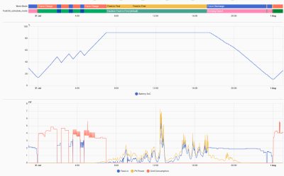

Personally I do 100% once a week, 10% once a month via an automation. It'll do it more often in certain circumstances (for example, if forecast PV for the day is very low, it'll use the full range instead for a bit of extra arbitrage to make up for the lost generation).
It's not worth doing the calibration cycles manually, you might as well just stick to the full range rather than trying to keep track. Also, underutilising the battery is just as much of a waste, due to calendar degradation (for example, sticking to 20-80 all the time, 0.6 full cycles daily, would mean you'd run out of warranty years, and the battery capacity would have decreased anyway due to the passing of time). It's a bit of a balancing act.

It changes on a day to day basis, anywhere from 14-92 to 20-84 (my automations will tweak it based on the PV forecast / weather forecast / etc), but I will also be cycling in the middle of that range as well (again, dependant on things like cell temperature / PV / weather / etc). I also adjust charge and discharge rates based on those criteria. On very hot days etc it will be using the slowest possible charge and discharge rate and no mid-range cycling (a high cell temperature causes increased cell degradation). When it is cold, it will be more aggressive, to generate warmth.What SoC range do you typically use for your batteries then?
So I'm using more like 0.8-1.0 full cycles daily even if I don't hit the extremes. That's only possible on particular tariffs.
