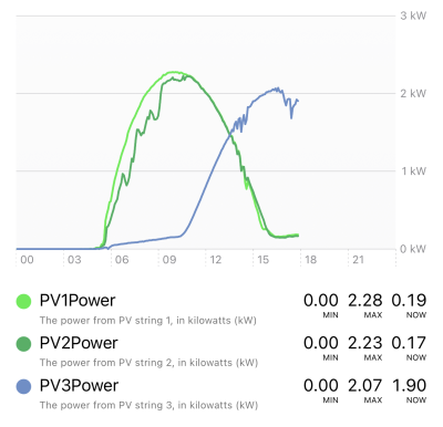

I’ve managed to get this graph of the generation patterns of my 3 PV strings:
PV1 and PV2 are on an East-facing roof, and are 2 rows of 6 panels each, with the 2 rows one above the other. PV3 is on a West-facing roof.
PV1 has a smooth curve, but PV2 and PV3 don’t have smooth curves. Why would this be?

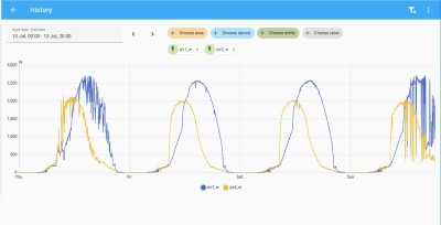

These are the traces of my 2 string system for the last 4 days, the very light / high cloud today and Thursday make the MPPT’s appear more ‘twitchy’ - your app graphs will be based on 5 minute samples, my graphs are taken from a direct modbus connection with a 6 second data sample.

Thanks Dave - it's not immediately obvious what might cause the discrpancies between the 2 rows of panels, but I'll try not to read too much into it!
