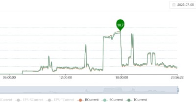

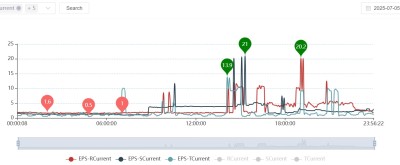

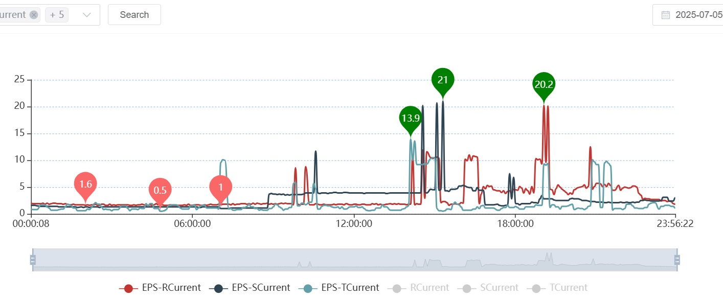

I have started analysing the various current graphs as it appears easier to track the usage in Amps.
I have attached two files that clearly illustrate the problem.
R/S/T Current - Does not appear to be valid in that all three register as exactly the same and are not always running.
EPS Current - Runs 24/7 and I can see some significant peaks where thankfully we did not trip.
Based on this I can only assume we are running in 'EPS mode' always and hence must be peaking over 22Amps on a single phase when we trip.
This leaves me with two options :
1 - Look to move loads off the 'Red' phase onto the 'Teal' phase
2 - Replace the 12kw with a 15kw 3 Phase
Option 1 seems like a good starting point.

Hmm ok, it looks like you are running in EPS mode which is good for when your incoming grid fails as it will continue to run, the down side is you lose the 'top up' from the grid which stops the overload.
Yes absolutely agree - option 1 is the place to start !
