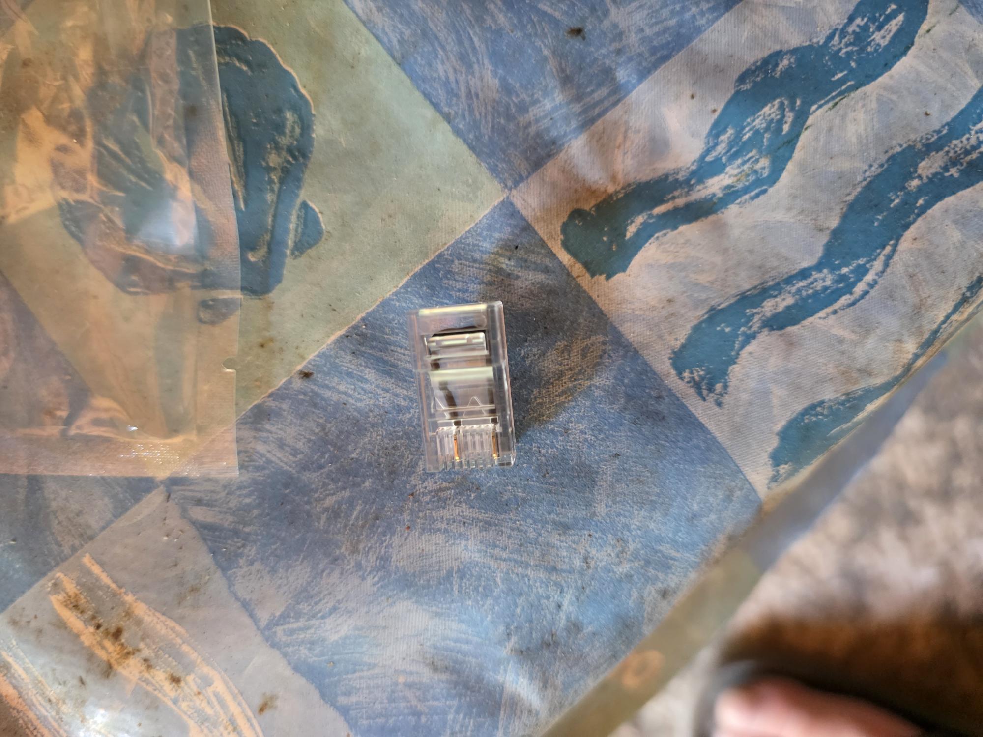

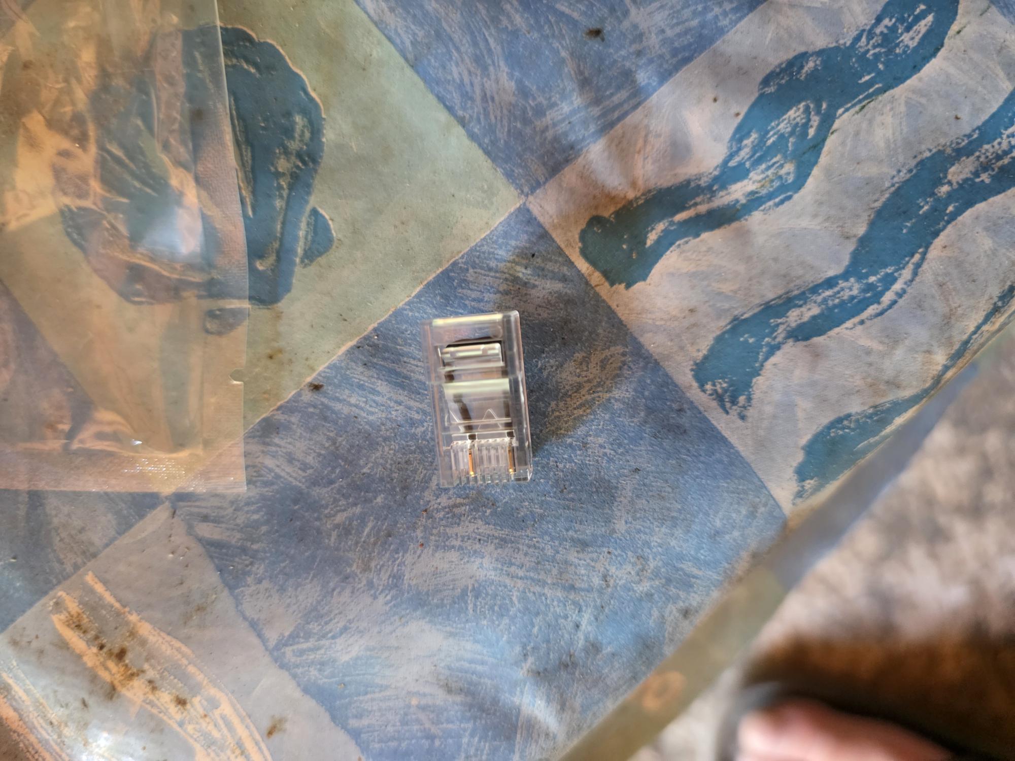

OK. Sorry, but where do they go and can I find them in the box? Is it on the inverter?
Re: Battery - parallel addressing failure
They come in the battery box. Two small connectors. They look like blanks but they have a small wire in them
I found one. Should there be two? Where is the jumper between which pins? Should they be link in and link out?
there is a jumper between pin 1 and 6.
