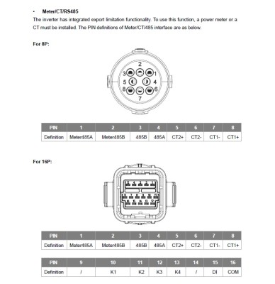

If you have a new H1 inverter it will be a G2 and there are 2 possible connector configurations for the meter connection wiring, i've attached the schematic below - you need to connect to RS485 A/B pins (pins 3&4) - these need to be connected to an RS485 adapter.

Looking at the wiring on the wave share USB RS485 connector there is 3 wire connections and you mention connecting pin 3 & 4, which wire goes to where & where is the GND connected to please?

It’s a balanced differential pair so you don’t need a ground, just 2 wires - the RS485A (pin 4) goes to the waveshare A connection, and the RS485B (pin 3) goes to the B connection

Not sure I understand the bit about cutting into the 2 wires for the CT, the CT itself will be wired to 2 different pins (usually pins 7 & 8), unless the installer has put in a multi core cable for you to tap into ?
