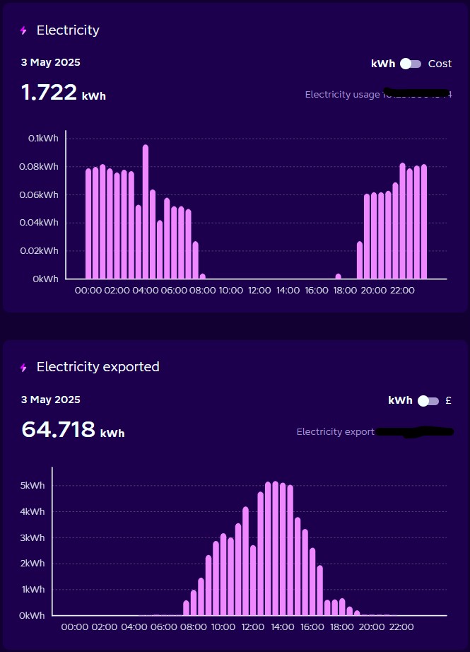

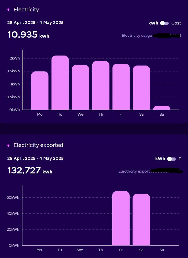

This is the example I'm looking at for why the house is using electricity at night. Doesn't seem right to me if I have a decent battery and minimal load at night. Always pulling from the grid. Top image is a typical DAY, the bottom one is the week view.

That looks pretty normal in Self use mode, no grid use during the day when the sun is up and the bias automatically shifts towards export, and overnight when the bias shifts the other way there is a small usage.
You would expect your installer to know how to do it, the larger installers that work closely with Fox would but for installers that use a variety of equipment it's probably a bit much to stay on top of every feature and this is quite a new feature.
Sadly there is no way of telling what it has been set to unless your are an installer, nothing in the settings or in the app - so once set the only obvious way to tell is the very small overnight grid use should reduce fairly close to zero.

If you look at your first octopus graph of grid usage overnight, you are trying to find an average bias point that would overcome the hourly usage - in that graph if you draw a line across at 0.08kwh (80 watts) you would have the vast majority of the import peaks below that line.
You might want to start a little bit smaller at say 60 watts which would cover much of the import as you will probably never achieve absolute zero (but if you are getting Fox to do it for you best to start at 80 watts and monitor for a few weeks).
The reason for this is that with any grid tied inverter when larger appliances such as fridges turn on /off (particularly the larger American fridges) the load is instantly there and whilst it may only take several hundred watts the inverter has to firstly measure the load change and then balance the load from batteries, it takes the inverter a small amount of time (seconds) and in that small window of time the grid will be filling in until the load has balanced. Likewise when the load turns off the battery will be still supplying power and again for a few seconds that will be sent to export until the inverter adapts to the new balance - this is what creates the usage (and export) you see overnight.
When you set the bias to 80 watts the first 80 watts of any instant load will always be taken from battery making the grid demand much smaller, as I said there will always be some demand but if you can get it down to 0.5kWh in a day you will be doing well.
Just to add, as an alternative test that will help - change your workmode to Feed-in First overnight and then back to Self-Use in the morning, whilst that may seem a little counter intuitive feed-in first changes the bias slightly towards export and so your overnight usage should drop - perhaps as much as half of what you are seeing.

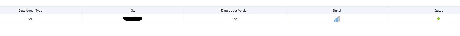

Thanks for that, any idea where to check on the firmware of the system on the app or the website log in? Or does it show on the front of the inverter?
My Datalogger is this. Is this up to date?
