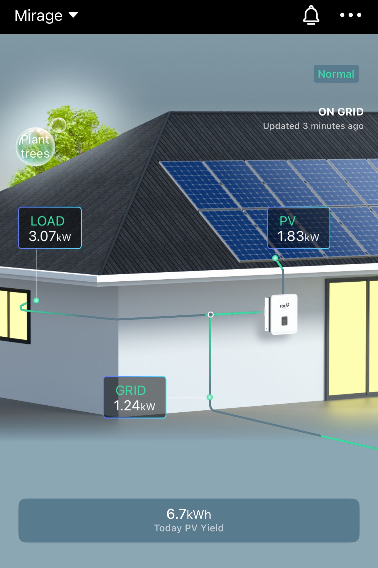

The app is reporting a very high LOAD for my house, which I know isn’t accurate. For example, see this screenshot:
https://i.postimg.cc/w9Nf0Zpg/222.jpg
It shows a load of 3.07kW, but that’s just not possible—nothing major is running aside from a few essentials (fridges, some LED lights, and my PC).

My actual consumption is around 0.5kWh at night and 1–1.5kWh during the day. I get that 3.07kW is a momentary reading, but I’ve also seen it spike to 4kW+, which simply doesn’t align with my actual usage.
Has anyone else experienced similar discrepancies with FoxESS / FoxCloud? How is the LOAD calculated in first place?

Readings like this (on new systems) are usually as a result of an incorrectly fitted / located CT clamp, you do get spikes but the data sampling is every 5 minutes and so you wouldn’t expect what you are seeing - we need a bit more information, as it is not showing a battery, is this a solar only inverter or a hybrid ?, are there are any other sources of solar generation.?.
If solar only, has it got a CT clamp or meter fitted as without that the load cannot be calculated properly.

Yes solar only and yes CT clamp is installed.
