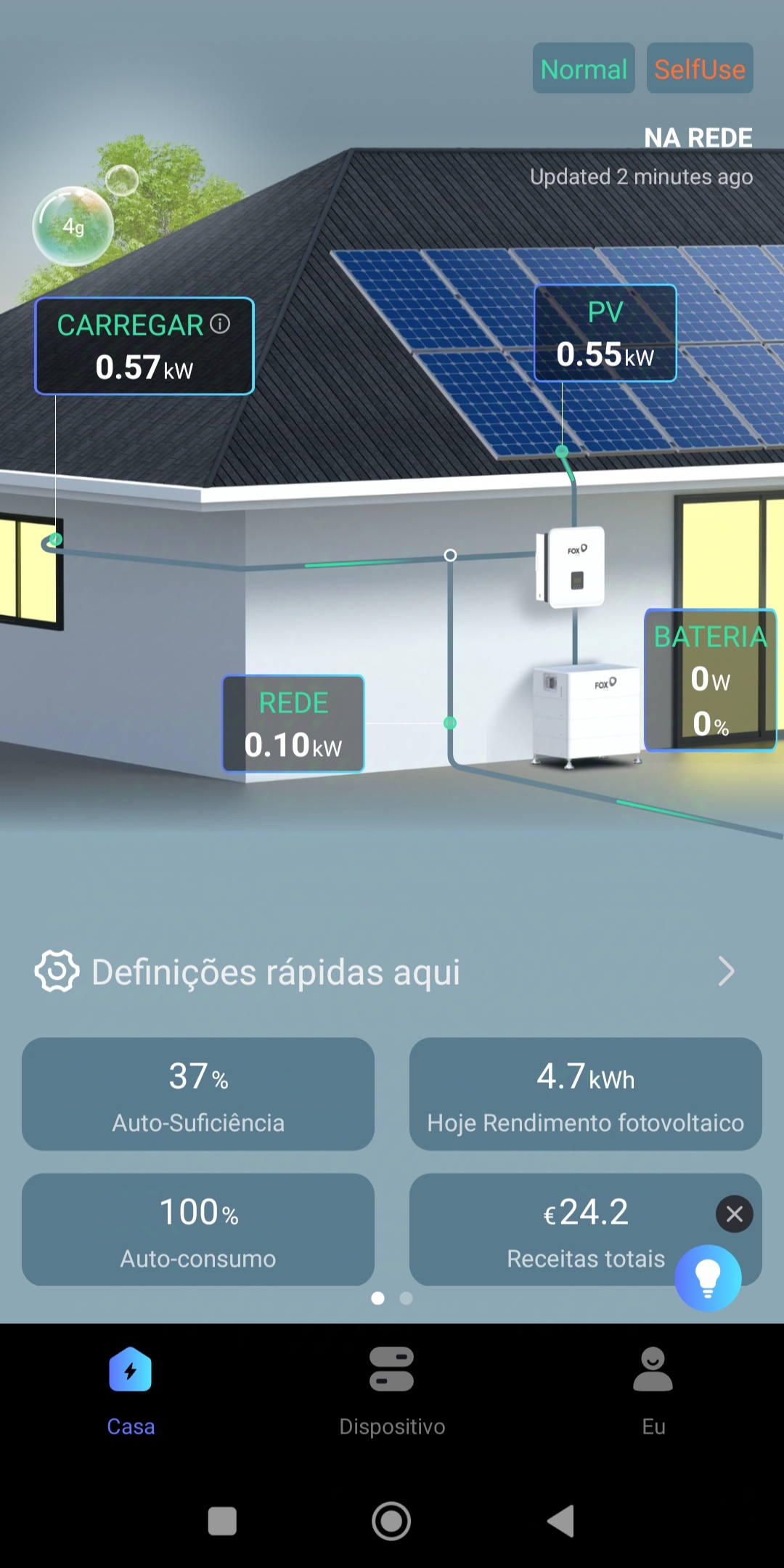

I have a photovoltaic system with 6 525 W panels and a FoxESS H1-3.0-E inverter installed, but no batteries.
At the moment, the application does not display the total production of the panels, but only the value according to what I consume.
My question is the following:
- Is it possible to check in the FoxESS application what the panels are actually producing in total?
- In the inverter, what are the necessary settings to be able to display the power actually produced?
I thank you in advance for any help you can provide.

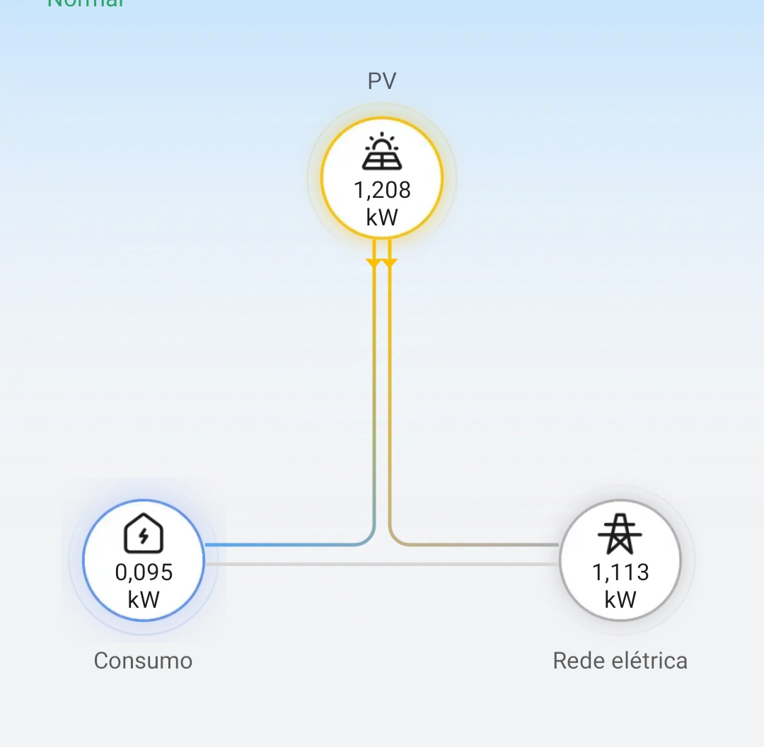

Note that the power consumed is equal to what the panel is producing.
It's a beautiful sunny day and the panel should be showing the maximum power produced.
I'm attaching an example of a HUAWEI inverter, installed in a family home, where it shows the real power of the panels.
That's how I wanted it to appear on mine.
Is it possible?
