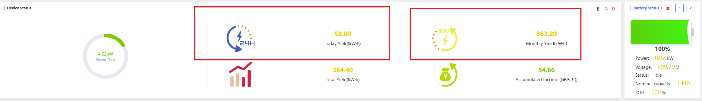

Is it possible to see from the web log in the total daily generated energy as a simple total? For example, Monday 56kWh, Tuesday 61 etc etc. All I see is the daily generation but want to see the quick list in history? Just for the generated daily total.

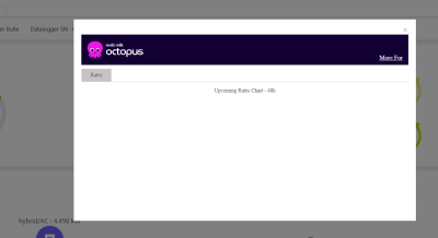

I'm also trying link the system to my Octopus plan, I'm on a day and night tariff have added the API from Octopus to the system from my octopus login but the pricing isn't pulling through. Should the system interrogate Octopus via my account with them?
See screen shots attached - This system is 4 days old so monthly generation will be pretty low.

important to note that those numbers are your inverter yield which is anything that leaves the inverter including PV and Battery. Revenue is not simply just what you exported which is confusing.
