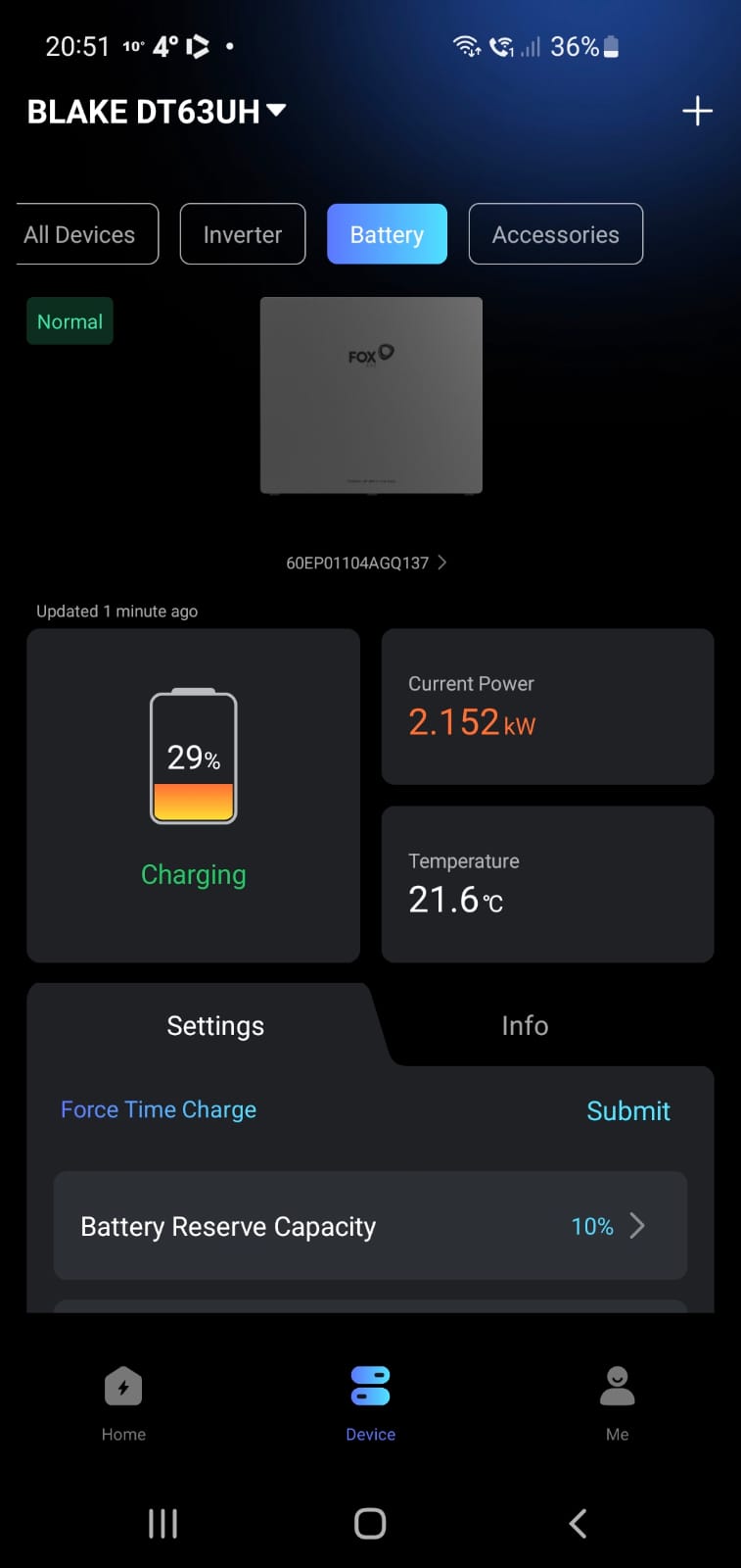

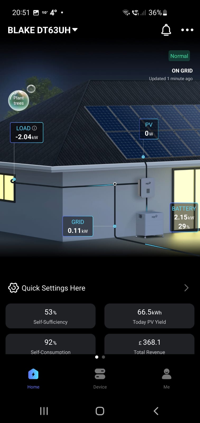

Also attaching a screenshot of the app showing the negative load and the battery charging off the grid (it was dark so definitely no PV generation at the time). The trigger in this instance was dishwasher (EV was not plugged in).

You shouldn’t see a negative load, it means that either the meter is not connected in the right place, or the phases have been wired out of sync (i.e. they should be connected as L1 = ‘R’, L2 = ‘S’, L3 = ‘T’). The result is that the inverter is unable to calculate the load correctly.
The Fox batteries should charge automatically in Self Use mode if there is excess solar without having to set a Force Charge.
