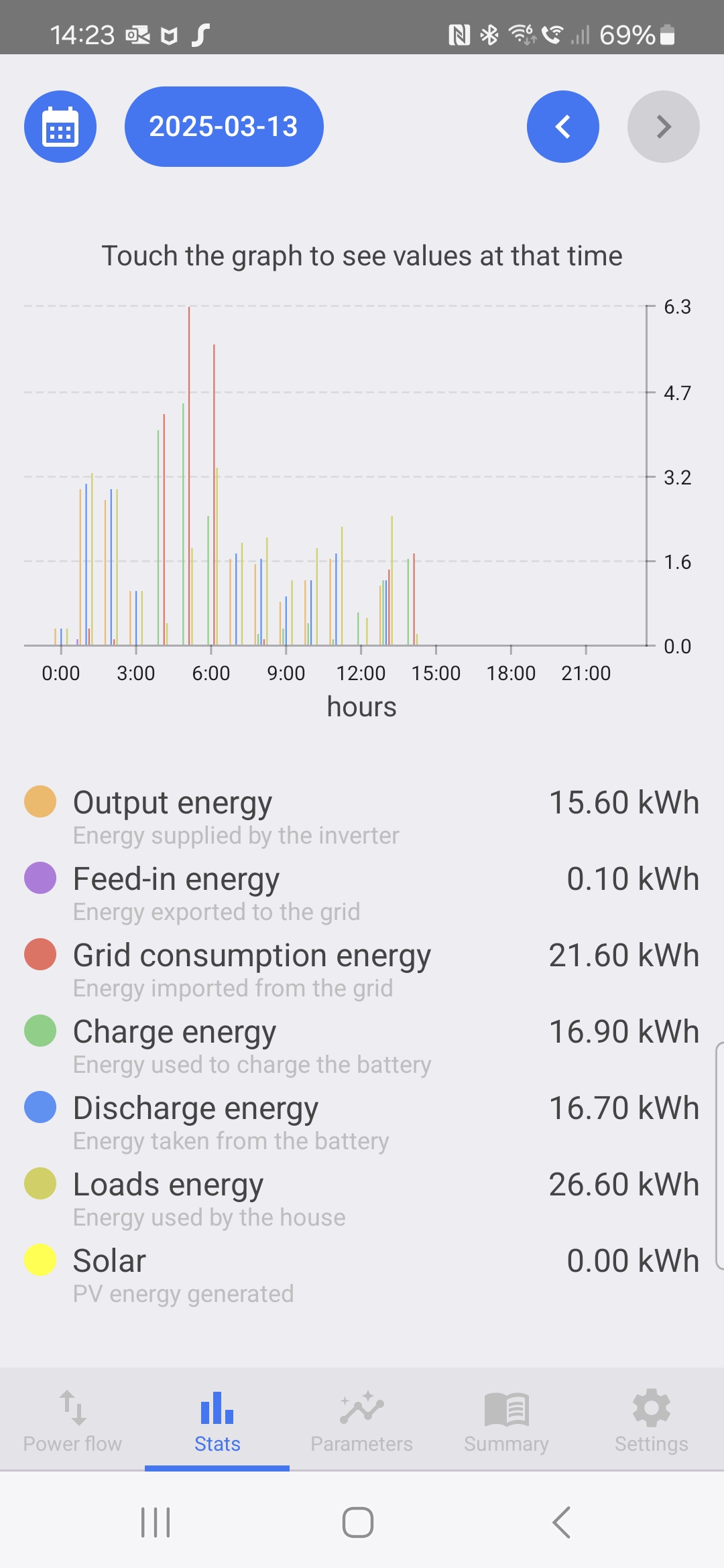

I am somewhat new to FoxESS and Energy Stats App... after several months of being okay, now on the Summary tab it is no longer displaying generation numbers instead it says Solar Forecasts – visit the settings tab to configure Solcast… what is causing this and how do I get it to re-display the generation numbers?

Hi, thank you for the reply. I updated the App and the summaries did reappear except Solar Generated which is zero. On the Stats tab, all the numbers are there but again Solar is zero. I cleared the cache, rebooted the phone but no change. All numbers are there except Solar which is zero. Any further ideas really welcome.

It will be zero if your inverter doesn't store solar statistics, if you post your inverter model someone can confirm.

The system was intalled in July last year the solar numbers have been available constantly until a few days ago. So something changed quite recently, maybe in the last week? Software change or bug? My inverter is Fox Ess AC1 5.0 e g2 but has been reporting the numbers successfully for last 8 months

Until recently ES estimated Solar generation based on your stats, then as Fox made actual Solar generation data available I removed the estimation in favour of the Fox data. Take a look on the stats page, if you're not seeing anything along the "Solar Energy" then this means Fox aren't reporting actual Solar stats for you.

Hi, Thank you for the reply. This is what I see, hopefully I have attached this correctly.
download/file.php?mode=view&id=1494
Would there be a reason Fox aren't reporting actual Solar stats? Is that a limitation of my inverter model or is there something I can do to correct that?
Otherwise, bringing back the estimation would be nice, but it is easy to calculate from the other numbers provided.

Looking at your inverter I believe the AC1 doesn't have solar input directly, but rather via CT2. This means that the inverter doesn't therefore store solar generation, hence nothing shown.
