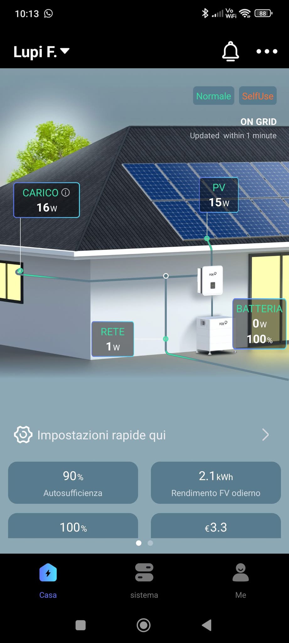

My house is actually empty, I have a constant standby load of only 20W but recentl I saw that everyday, at sunset, when the PV has no power and the battery is engaged, the load increase around at 65W:
Is it related to the inverter using the battery energy?
Every load I add (a dehumidifier for example) during night, it is like is using more energy.
For example the dehumidifier during daylight use around 100W, so I see a total of 120W with the standby load.
If I turn the dehumidifier on during night (from battery), the load goes from 65W to 210W.
At sunset, after the battery is fully charged, the load goes down again to 20W:

You'll want your grid compensation setting adjusted to around -25 by your installer remotely.
You will first need to be on the latest firmware which your installer can send over the internet to your inverter.
