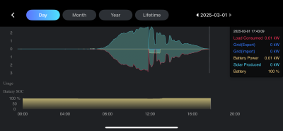

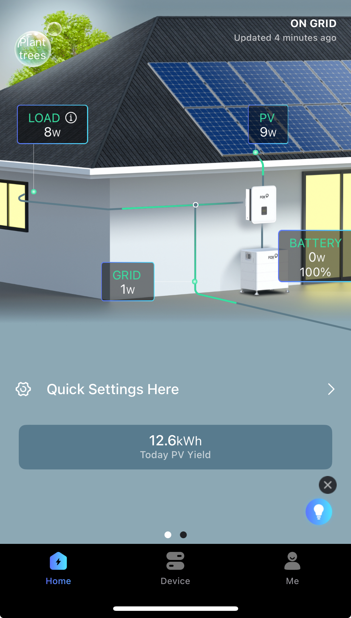

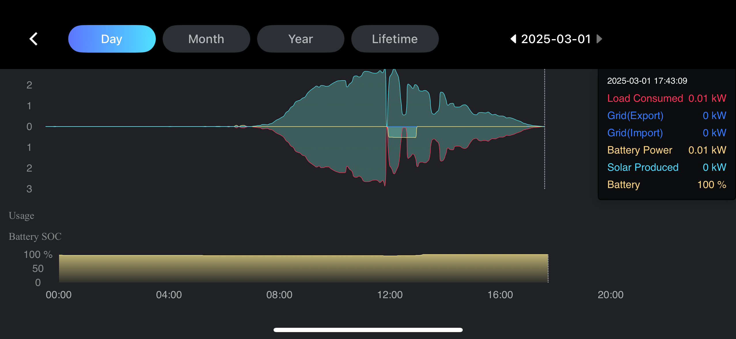

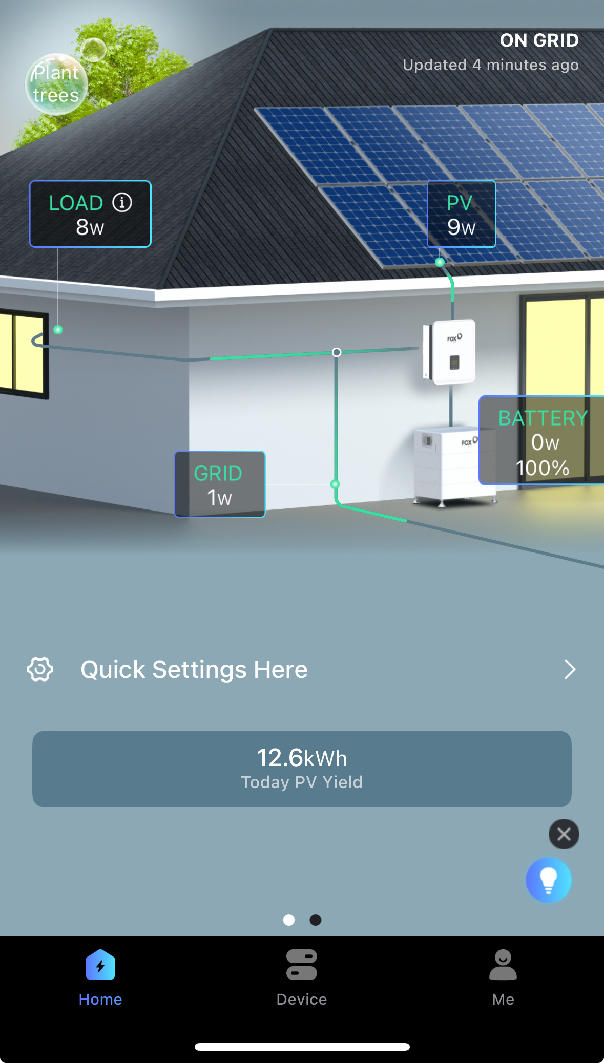

No problems, here you go. I think it is actually working ok, judging by the graph, it’s just that the house diagram page is a bit unreliable.
There’s something wrong there, most houses use a minimum of 150 watts, often much more and yours is showing 8 watts - you should see your house load going up and down as you use appliances and also explains why your battery is at 100% and is not being used as it cannot work out what the house load is.
That looks like a problem with the meter/CT either a cabling fault or if a meter it hasn’t had the current transformer set correctly - give your installer a call, they should be able to do some tests remotely.
It does go up and down with usage, but I think there’s definitely something odd happening. Right now it’s reading 0w everywhere. I’ll give them a bell on Monday.
