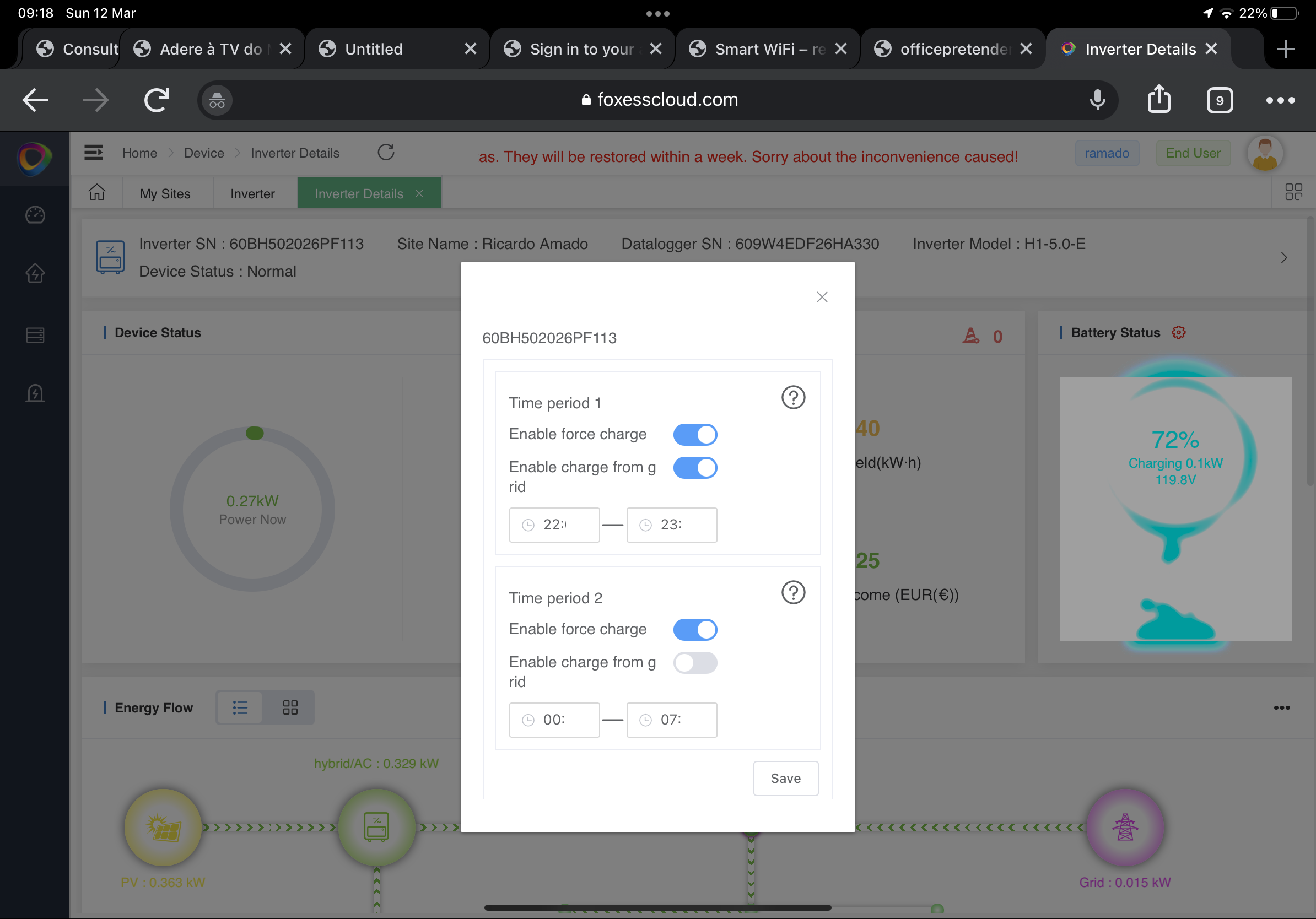

Here you can find the battery force charge configurations:
Am I missing any extra configuration to preserve the battery for the period 8h to 22h?

During the night the battery will be used to keep the inverter running, it doesn't use grid power to do this - it always comes from the the battery (or solar during the day).
The force charge option you have set will stop the batteries being used to run the house load, but it will continue to be used to keep the inverter running during night time hours.
