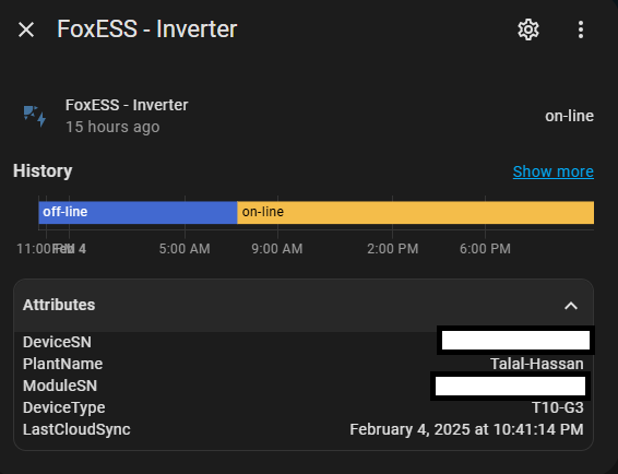

I have been experiencing a weird phenomenon since 29th January 2025. After the recent HACS update and HA Core updates, I started to see Load Power values populating even when the sun was set. I was unsure and double checked the "FoxESS Inverter" sensor value and was showing "Online" at 8PM.
The issue automatically got fixed yesterday, however, today the same thing happened again and I can see the Inverter status as On-line and the Last Cloud Sync value showing updated 1 min ago.
Looking forward to experts guidance around this issue.

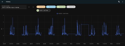

That's a weird one - can you post a graph of your load_power sensor over a few days please.
I heard a report yesterday that a user had seen his api_calls get reset - so it is possible that Fox may be doing something with the openapi - but i'm not seeing anything wrong with my test system and i'm running the latest core.

Thank you for your response. Here are some stats you requested for. I also saw a holding pattern for Grid Consumption and Load Power sensors where they would continue to report the same values as were being populated as the sun was setting, for the rest of the night, until the next morning.
Ohh and no errors reported against FoxESS in the logs.

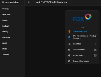

Ok, thanks - so now just trying to understand if it is the Fox cloud that is playing up - if you log in to the V2 app and look in ‘Device’ what status do you see reported for the inverter and the datalogger ?.
Are you running the latest version of the integration v0.43

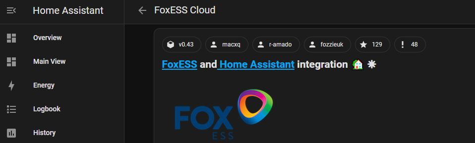

Apologies for not mentioning that the integration I am running is HACS -> Fox Cloud.
App and Fox Cloud website, both showing Inverter and the Datalogger as Offline.
Fox integration with HA also running latest, i.e., 0.43

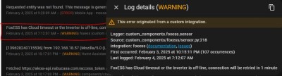

Just found this error while I was going through the Logs again, somehow missed it.
Re: T10-G3 Inverter Status during non-solar hours
Hmm ok there are a lot of errors in getting data from the cloud - is there anything special about your home assistant, is it on a slow wifi or does your broadband have a slow connection for example?

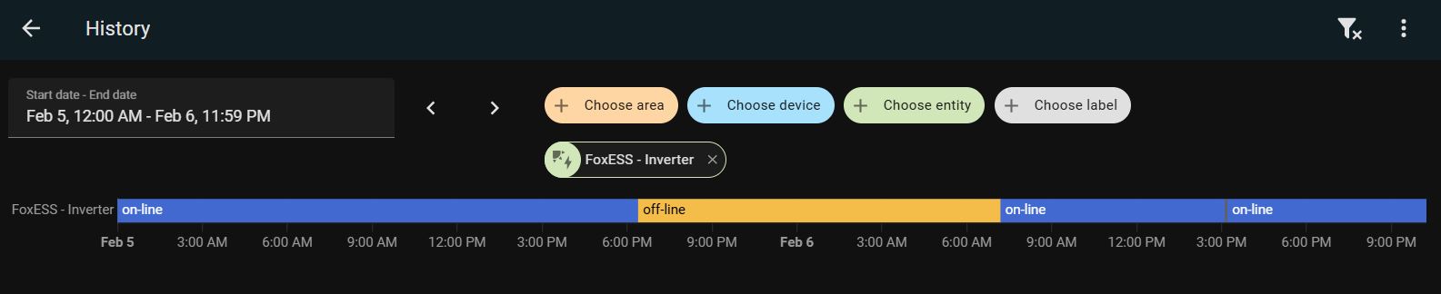

So the inverter status today at sunset changed to Offline. I am sharing some actions I performed after you inquired about potential internet / bandwidth / connectivity issues:
1. Switched the laptop from static IP to dynamic. HA however is still on a static IP address.
2. Removed DuckDNS addon as I am behind a double NAT and, until I purchase a static public IP address from the ISP, I believe I will not be able to access HA outside my home network and if I decide not to use HA Cloud.
3. Was running Microsoft Edge on the laptop, running HA. Closed that too, just to lessen out any load contributing to performance issues.
Here is an extract from the logs as well (removed confidential details):

The logs show the succesful transition from on-line to off-line so that’s working today - there is a fox cloud timeout which only happens where an api call doesn’t get a response within 75 seconds which I wouldn’t expect - i’m not sure it’s a performance issue, timeouts are more indicative of a loss of network connection?

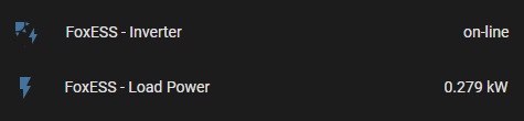

Unfortunately, the inverter was again stuck on On-line status today. It continues to be Online as we speak. Here are the stats from yesterday to today:

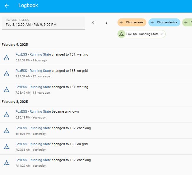

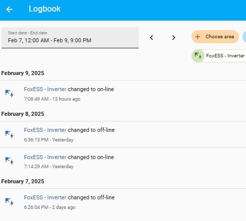

Ok good news of a kind, it did it tonight - in fact it's still showing as online, whereas the runningstate has gone to off-grid.
Now when that happens, the runningstate (on a solar only inverter) will trigger an off-line event that overrides what is being reported in the site details.
