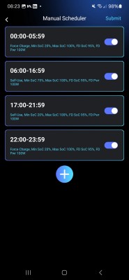

The problem is that I can't get the mode schedule to Force Charge more than once after cycling the system down and up (down: Battery, PV DC, Grid - wait until screen is blank plus some - up: Grid, PV DC, Battery). My latest try I even had two Force Charge after one another (since low tariff passing midnight), but only the first charged and the following just acted as self-use hence draining my batteries during cheap hours. Using the standard/simplified force charge is working multiple times though.

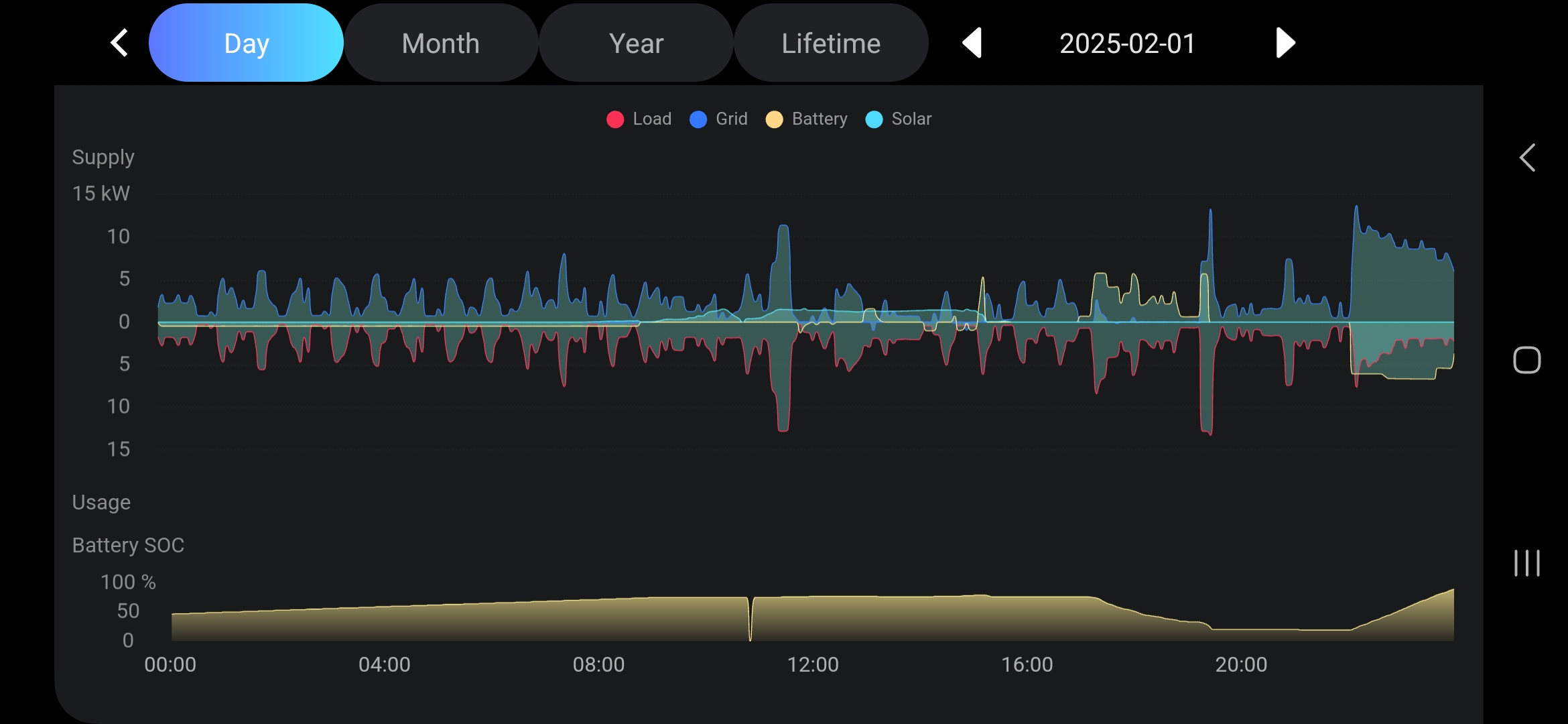

The notch in the SoC is where I rebooted the system, no altering of settings at all after that

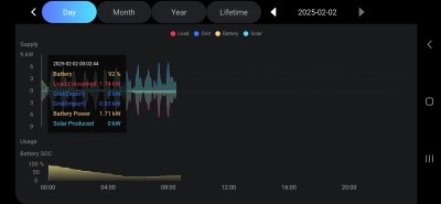

Passing midnight it was up just shy over 90% SoC, but instead of continue force charge it went into self-use
Been careful not to overlap. The min SoC value of 75% in self-use is not my end game, just during testing
Standard scheduler is and were disabled

Schedule timings and settings look fine, although I have found it is best to set FDSoC the same as your battery reserve level (not 95%), i've seen a few issues with that from time to time.

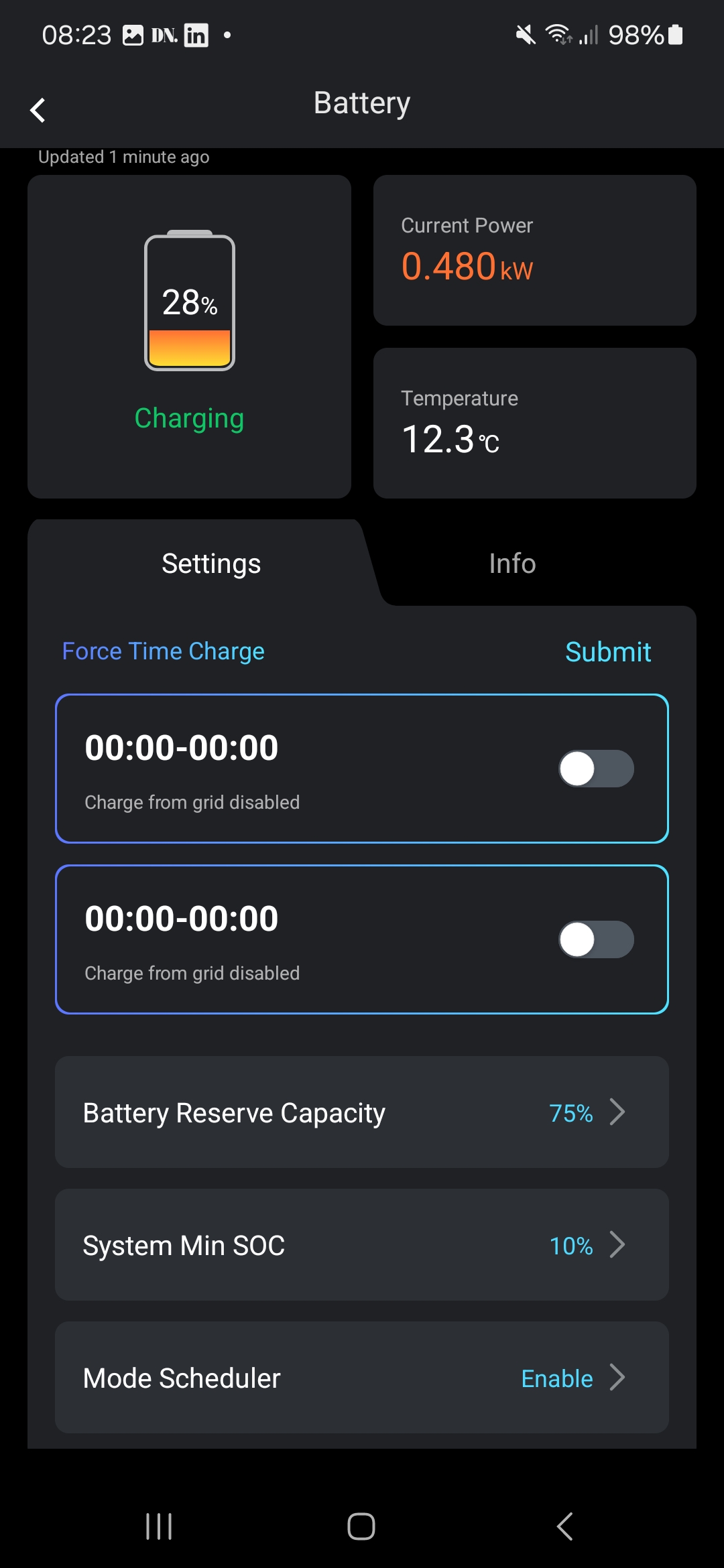

Your battery reserve capacity is very high at 75% - is that intentional ?, normally it is set the same or a little bit higher for use on EPS
The 75% battery reserve capacity is only an artifact from previous test runs where I didn't want a period of self-use drain down batteries to 10. Also, the minSoC 20% will go to 10% once I get things to work.

Yes it does look like a bug, if it is re-producible it should be reported - the best way is to raise a ticket in the V2 app, click 'Me' at the bottom, then 'Contact Us', then 'Support' and you can describe the issue, attach images etc..petste wrote: ↑Sun Feb 02, 2025 11:17 am The 75% battery reserve capacity is only an artifact from previous test runs where I didn't want a period of self-use drain down batteries to 10. Also, the minSoC 20% will go to 10% once I get things to work.
