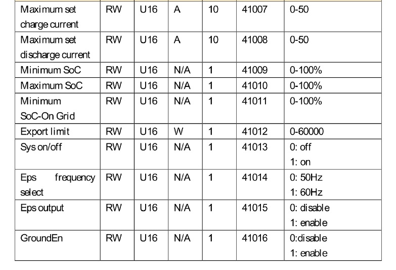

This isn't that well documented and Fox are slowly changing the register map on later firmware versions for consistency.
However I believe on the H3 (and H1) that -
41013 is System Enable, where you write '0' to turn off, and '1' to enable
But you will obviously need to test it to be sure.
Dear Dave,
thanks for your answer!
From the modbus-list of H3 accessible to me I know that 41014 is "sys on/off". But, this switches off the whole electrical system - I just had "killed" my house with that register already in the past
Thus, I am not sure what "system enable" means exactly for 41013; probably it is the same.

I have 41014 recorded in the spec as EPS Frequency Select, and 41015 as EPS output Enable - nothing good would come of writing to either of those.
If you disable the system (41013) your power should stay on, but the inverter will no longer be providing any support - the equivalent of pressing and holding the check button on the inverter panel (second from the right) and selecting stop.
