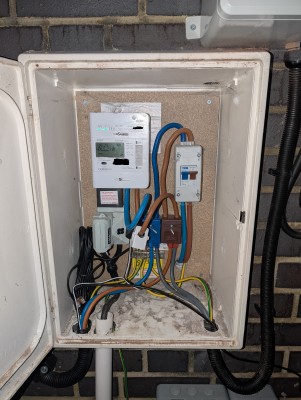

On a related theme, when my EV charger was installed they have wired it so that it now drains the EP11 battery when IOG schedules peak rate charging windows and the EP11 isn't set to Force charge. The installer said he wasn't trained in solar and so could not add it as a separate circuit before the main house and solar circuit, i.e. straight after the tails coming out of the meter in the attached photo, but that should be simple shouldn't it?
Re: Fox Battery will not Force Charge as the same time as Hypervolt EV Charger.
NickKendall wrote: Mon Jan 20, 2025 7:57 pm On a related theme, when my EV charger was installed they have wired it so that it now drains the EP11 battery when IOG schedules peak rate charging windows and the EP11 isn't set to Force charge. The installer said he wasn't trained in solar and so could not add it as a separate circuit before the main house and solar circuit, i.e. straight after the tails coming out of the meter in the attached photo, but that should be simple shouldn't it?
Yes, a henley block on the tail straight after meter where the white CT clamp is.
I must admit I wouldn’t have wired any of it the way it is - so just to confirm i’m reading it right, bottom left is the feed to the EV charger, bottom right is the solar inverter and the feed through the 100A double pole switch through the backboard is going to the house consumer unit ?
Hi Dave, thanks and yes that is correct.
How would you wire it please?
