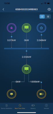

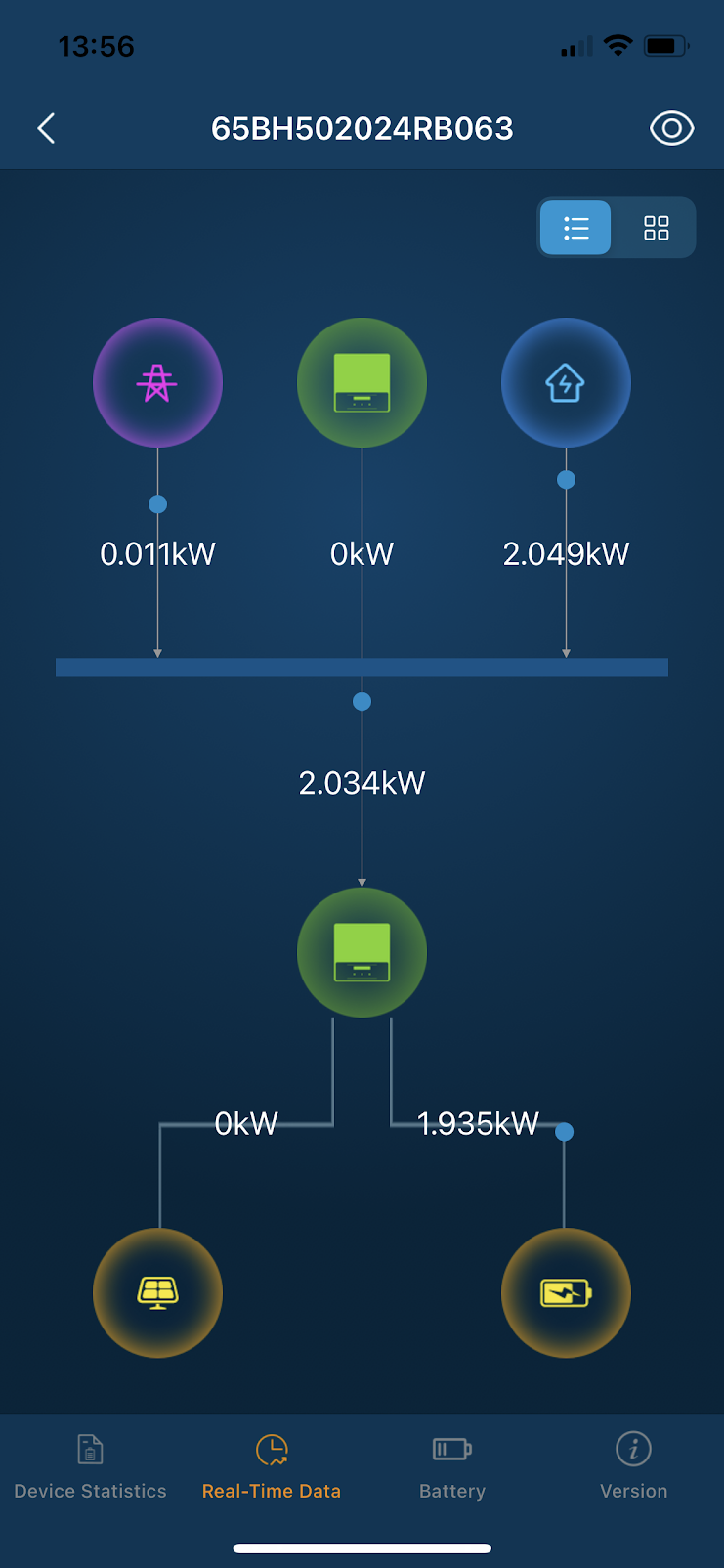

Hi - I have just had installed a similar setup of Enphase microinverters and FoxEss batteries and inverter. So far it's working well but the systems don't integrate well as you'd expect and I wondered whether you're having the same problems. As per the screenshot attached my solar PV energy and my usage energy are combined in the Fox app (flowing in from the house icon in the top right).
This makes it hard to calculate how much energy my house is consuming at any point in time because it's being overridden by the inbound PV energy. Do you have a similar setup?I'm also bristol area and the same problem. Just so tempted to install myself but would be great to hear from someone who has done the same.
