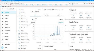

Hi I have added modbus LAN integration to my HA, and even though the sensors work and update as expected, I'm getting the "no unique ID" error when i select them, any idea?

At the moment this is fine. It doesn't stop you being able to use the data or sensors. I'll look into setting unique IDs so the message isn't shown, but it's only advisory.

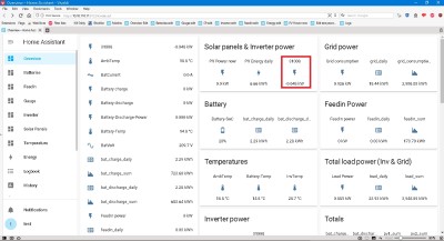

I worked out that that 31008 sensor is the power output of the inverter.
Whether it is from the battery and solar.
