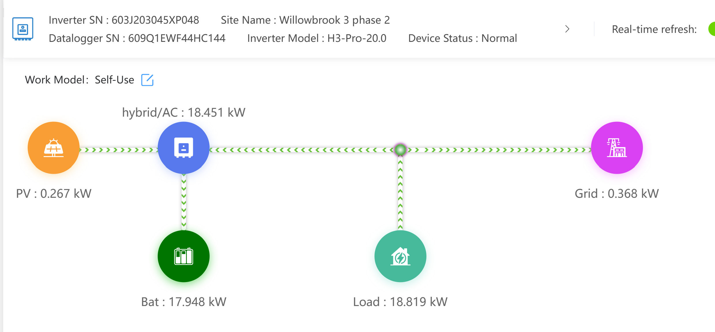

Issue is
The batteries charge from the grid all by themselves, no force charge set.
The power supply shows to be coming from the load and not the grid, Huge loads, over 20kw.
If if turn off the AC the load still shows to be coming from the load icon, and not to the "house" looks like the grid and load are around the wrong way, i have turned the CT Clamps x (3 phase) both ways and still no improvement, super confused.
It is almost like the house pulls a huge demand and the batteries empty in about 20 mins then recharge in the same time.

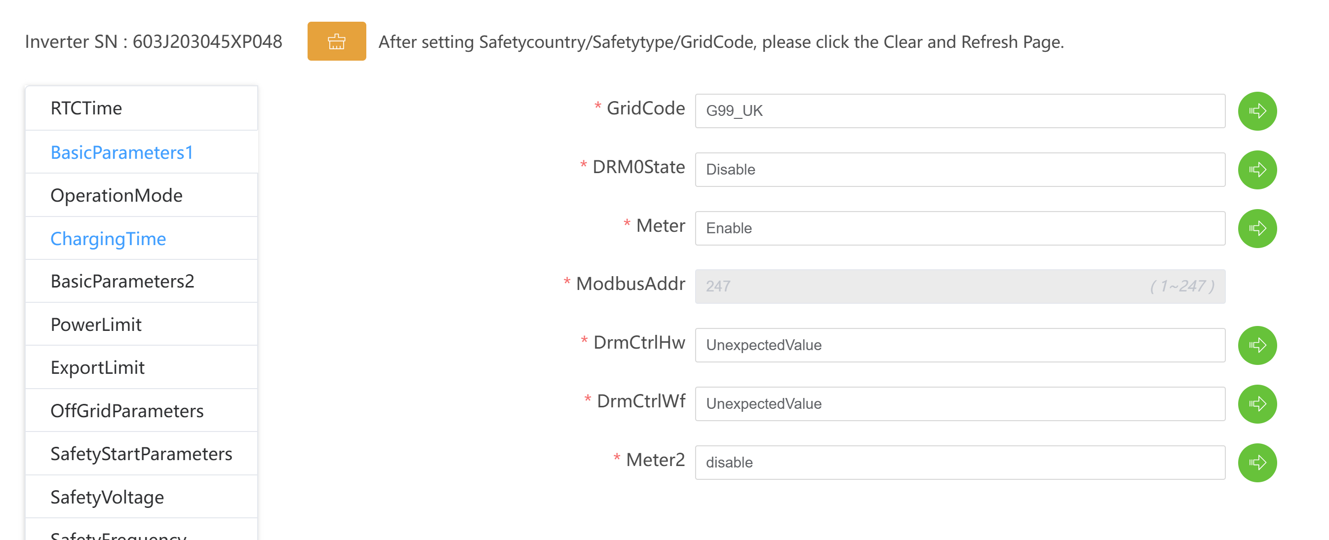

Obviously make sure you have the Meter3P enabled in the Meter/CT settings of the inverter - but looking at the above settings you have set it as if it were connected to the line directly and not using CT clamps (CT=1).
The CT setting is the current ratio and you would expect this to be set to 50 (or 40) depending on the CT clamps you are using - set as 1 it won't work with CT clamps as you can see.

If it's showing the 3 phases then it's very likely it is set correctly - in Meter1/CT you can scroll through options and you'll see something like CT, Meter1_P, Meter3_P - it should be set to Meter3_PRichard Knight wrote: Thu Dec 26, 2024 10:05 am HI Dave. thanks so much for posting a response, can i check?

It needs to be set as Meter3_P in the Meter1/CT settings - the fact you have it disabled is the reason why it reports ‘Meter Wrong’
The reason why the system is playing up with the Meter enabled is that it isn’t reporting the correct load values as you have set the CT current ratio to 1 - that is only used when you have the meter directly cabled in-line with all 3 phases and you are using CT clamps that need a higher value set - that is usually set to 40 for 200A/5A CT clamps or 50 for 250A/5A CT clamps.
Once you set that correctly, restart the meter and you should then be able to enable the Meter1 in the inverter settings - the only question then is do you have the CT clamps facing the right way but you should easily tell that once the CT ratio is set correctly.

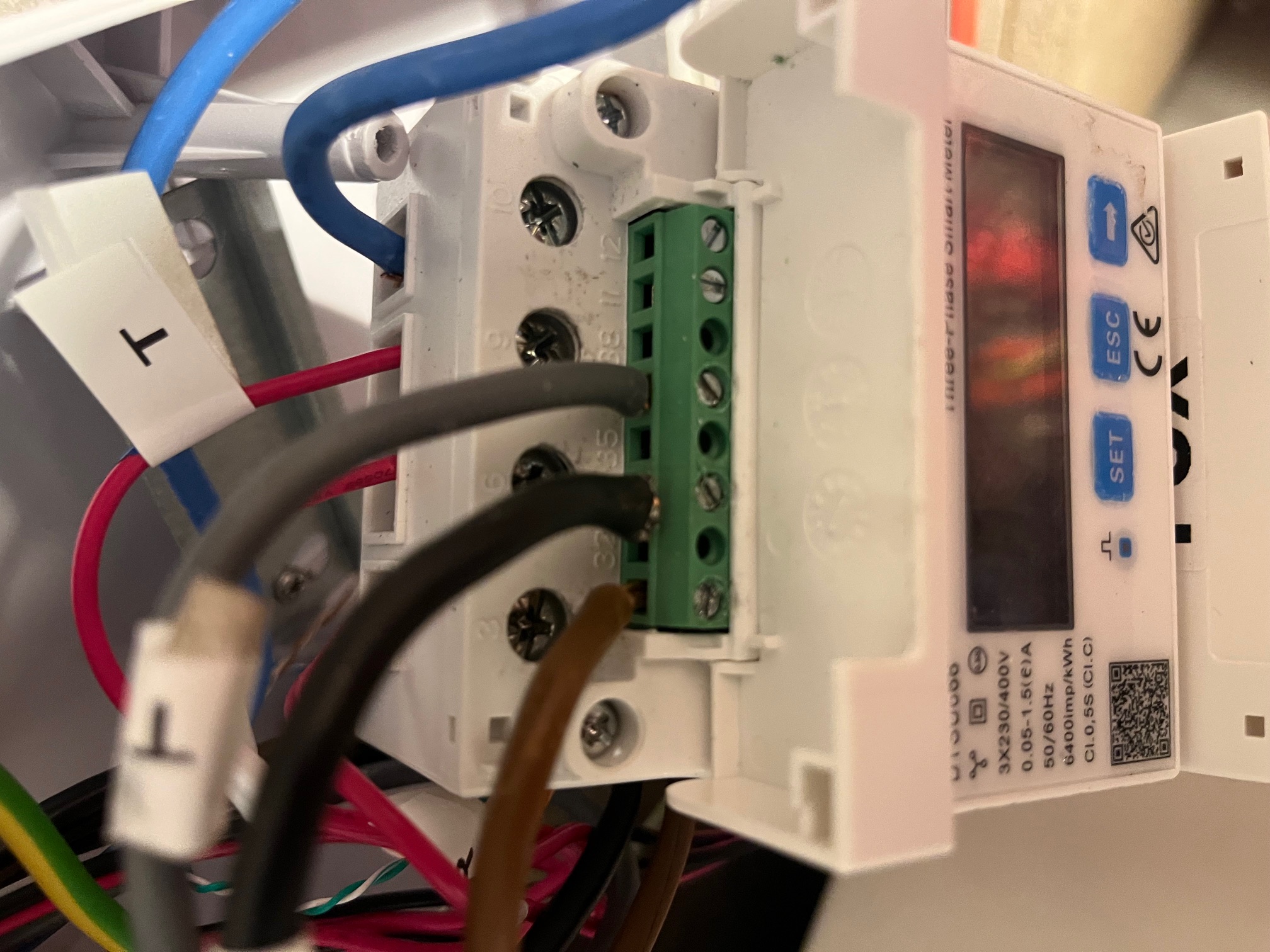

Yes your right it’s the H3 pro - it’s always 3 phase so the only option for meter is ‘enabled’
The rest of the settings look correct it should be set to ‘modbus’ and 9600, n, 8, 1 - address 001
Your wiring looks to be 4 wire (L1/2/3 + N) so ‘net’ is N34
CT should be 40 (or 50) depending on your CT clamp ratio.
On the wiring you should have L1 connected to pin 2, L2 to pin 5, and L3 to pin 8 and Neutral to pin 10
The RS485A pin 24 to pin7 on the inverter, and RS485B pin to 8 on the inverter meter connector.

I am still getting issues as per the image, ie load pulling from the house and batteries charging with being forced to. i really am struggling.
It looks very much as if it is a metering problem, when you go to the Chint meter and look at the various voltage and power flows for each phase does it appear as if they are correct ? - and when you enable the meter in inverter settings does check meter work ?

Assuming you have wired the CT clamps as per the Fox diagram where the S1's (red) would be connected to the meter pins 1,4 & 7
Each CT clamp *must* be clipped to each of the live feeds where they leave your main 3 phase meter and the arrow should be pointing away from the grid towards the load.
The next thing to do is a controlled test which is going to take a bit of timing, if you have a clamp meter it is easier to do this as you can clamp it on each live feed and measure the current you see so you have a 'known known' - if you can't do that try and see what the main meter is showing on each phase.
This is the bit that takes a bit of juggling as at the same time you need to look at the Chint meter and record the results shown in 1A, PA then 1B, PB, and 1C PC, also ideally what you see at the inverter panel in the Grid R/S/T screen.
What i'm trying to get to is that you have a known measured load on each phase and compare it with what the Chint meter is displaying, in theory the inverter should be showing the same as the Chint is it's meter source and it should all match what the smart meter (or clip on meter) is showing.

The CT red wires are connected to 2 6 & 9, black to 1,4 & 7. each phase to 31,33 & 36. Neut to 10. should i swap the red/black over?
I think it seems we are making good progress as the foxcloud screen is showing more positive results, see image.
Once again i feel i need to say Thanks you, you are amazing.
i'm out quite a bit tomorrow myself but will check in when I can.
If you could swap the ct wires over so that all the red R/S/T's are on pins 1, 4 & 7 and their corresponding R/S/T blacks go to 3, 6 and 9 - and then we're matching the manual and then make sure the arrows on each clamp are pointing towards the load (away from the grid).
Each of the phase live should be connected as -
L1=Pin2 (or might be labelled 31)
L2=Pin5 (or might be labelled 33)
L3=Pin8 (or might be labelled 36)
N=Pin10
I've attached a diagram for the Chint meter wiring (with a red ring around the pin config) and also a diagram from a Solax 3 phase as it's a useful visual aid of the system.
If you had the CT colours reversed but the arrows facing the right way (even on just one of the CT's) a side effect of that is the batteries would dump to the grid at full power (the inverter sees the battery power incorrectly as excess solar being generated).
At this point it all might work but if you could do the tests with the clamp meter to confirm the Chint meter is reading and displaying the values correctly.

Thanks Dave.
I have swapped the CT pairs over to match the above/
Red on 1,4 & 7 and black on 3,6 & 9, N on 10.
L1 Brown on 31, Line 2 Black on 33 and Line 3 Grey on 36
Sorry to say it is still no better. I have a mate coming over later to assist with the "Clamp Meter check" so will advise later.
CT reading as follows
UA 236.1 v
UB 241.2 v
UC 242.1 v
1A 22.80 A
1B 23.28 A
1C 34.76 A
PT -1.492 KW
PA -3.050 KW
PB 5.616 KW
PC -4.056 KW
E00182.81KWH
Imp 00098.43 KWH
Could it be that one of the phases needs to be swapped? it really is playing up this morning.

FYI with the current setting the invertor is buzzing like mad dumping grif pwer into the batteries but not showing this on the APP/Fox cloud.

Good Morning David. Hope you are having a good weekend. My good friend came over yesterday and assisted with the clamp meter readings.
we didn't have much time but we did discover that the clamp meter reading on the tails did not match the meter or what was on the invertor.
We also discovered that the CT wires (Red/Black) for L1 & L3 where swapped so the CT reading for L1 was in fact for L3 and visa versa. . We swapped these over and left as we both had arrangements, i watched the APP whilst out last night and things seem to be improving. The meter check now shows "meter 1 correct" which is great.
now that we seem to be making some progress. i wonder if we still have a setting in the meter set incorrectly, i wonder this as the load from the grid seems higher than before, it used to be around 200-400w and now its around 800-1200w. do think we still have a setting in the CHINT incorrect.

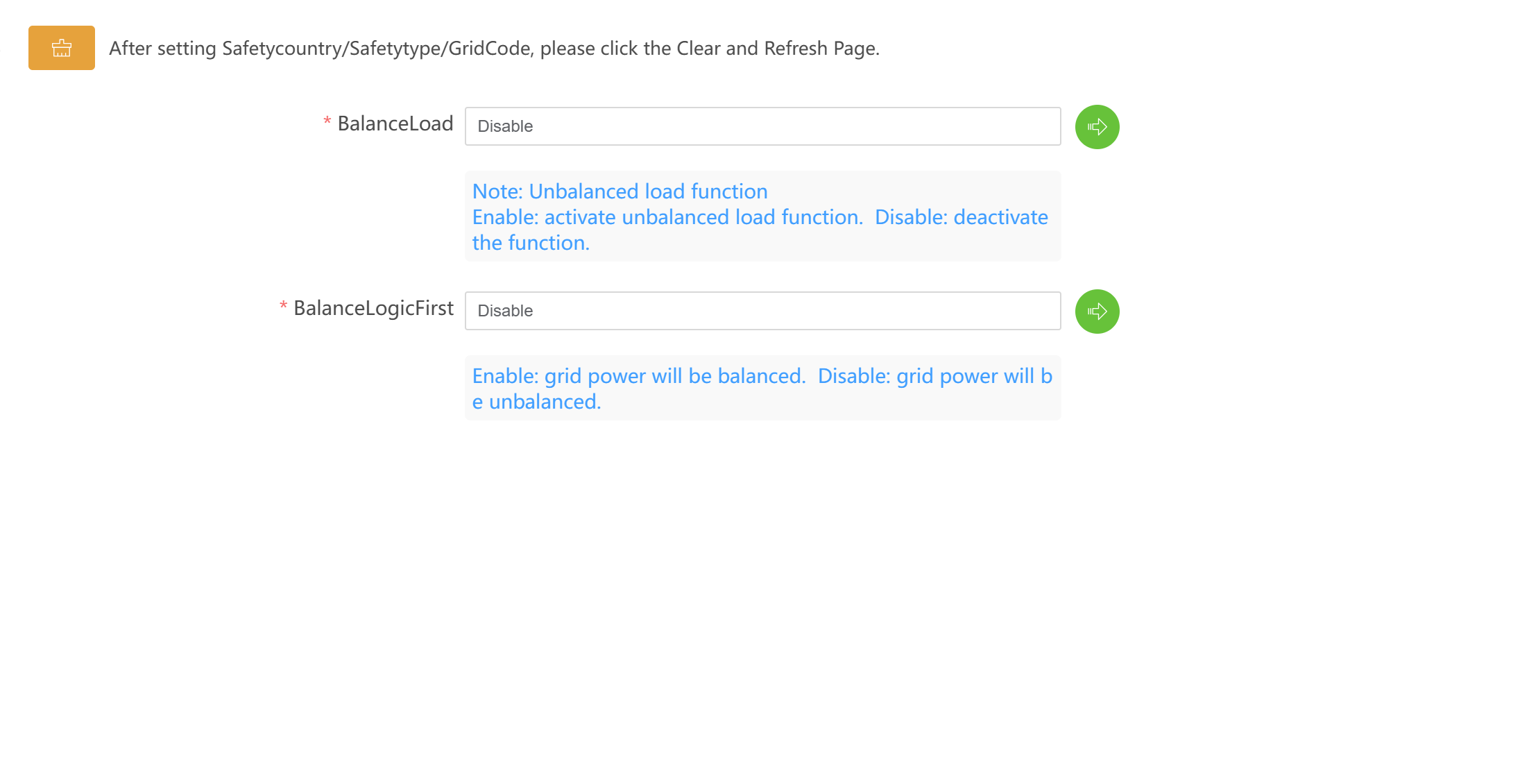

Can i also ask if the "balance loads" should be enabled in the invertor?

On the inverter balance functions - you have an H3-Pro 3 phase 20kw inverter, which means that each of it's phases is capable of outputting at 6.6kw - but as 3 phase loads are independent you might have 8kw on L1, 5 kw on L2 and 5kw on L3 so the inverter will be able to output 6.6kw: 5kw : 5kw meaning you will be taking 1.4kw from the grid.
You would normally have balance loads enabled if you have net-metering agreed with your supplier - so in that previous example you would be paying for 1.4kw of power.
If you enable BalanceLoad and BalanceLogicFirst - then the inverter will attempt to get a zero sum at the meter i.e. it knows the load is (8+5+5)=18 so would output on the phases so as to achieve no import i.e. (6.6kw : 5.7kw : 5.7kw) and hence you wouldn't pay for any electricity.
Also it would draw power on the 3 phases in a balanced way to meet the house loads and charging the batteries.
From what you have said I think you have cracked it - and it would be good if you can get some charge in the batteries and let the system run so we can get some history of load power, grid consumption over time.

The sun has not been shining much recently and so the batteries are low, however they have been charged via the grid during this issue we are discussing.
I checked the "Meter test" last night and it said "Meter Correct"
This morning i checked it again and it now says "Meter Wrong" so we are definitely getting somewhere. but their still must be an setting error maybe?
The sun is shining a little right now and we are pulling in between 888w - 1.2KW. 10.37am
Also i have checked the "force charge" and that works perfectly, now showing the correct load/route of the grid supply. Before it showed it coming from the house.
the batteries where charged to over 80% last night when we got home and they are down to 10% this morning, So i guess they got used up last night. (the kids where up later boiling the kettle and the 3 kw immersion was on for 3 hours from 3am to 6am.
at this very moment the sun has come out and we are pulling in just over 2kw and the batteries are charging which is great.
so i think the we only have one issue left of which is the "Meter Wrong" issue

The meter wrong may not actually be a problem - the test is meant to be done when the meter is disabled to check it is responding correctly, if you check it whilst it is enabled and has just been polled it's likely it will fail, it's only when you get a hard error that says 'meter fault' when it is enabled that it's time to worry.
I didn't ask before but is it a long cable length between the inverter and meter?, from your pictures the cable type looks fine and it can normally cope with long distances but occasionally you have to fit a 120 ohm resistor if it's travelling long distance.
Other than that, be nice if we had a clear sunny day to give it a good test but at least you are getting some PV generation
