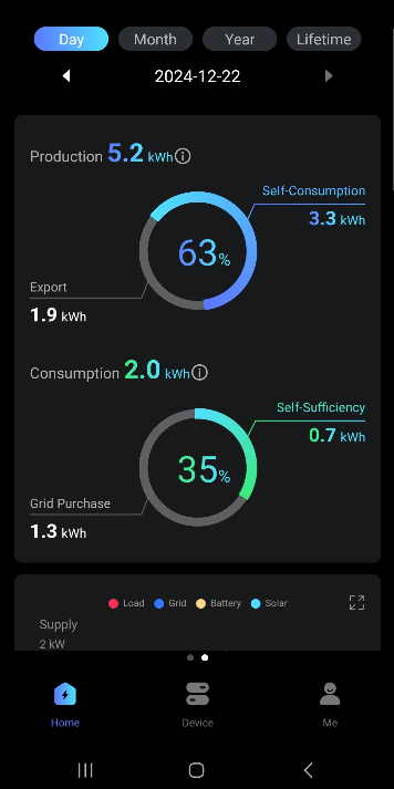

I have a new system some 2 weeks old and the invertor is uploading power to the grid, despite the battery only being around 30% charged.
Today it generated 5.2kWh, but sent 1.9kWh (37%) to the grid. Annoying as I used only 1.3kWh from the grid.

Is it still mis-behaving? - can you post a picture of the graph at the bottom of the page you originally posted as it shows the grid, solar, battery power and soc all together.

Ok, thanks the graph all looks ok and is showing the correct polarity for loads, solar, grid consumption and battery charging.
I can see your BMS did a maintenance charge on your batteries approx 2am - either because they dropped below the Battery Reserve % you have set or the temperature was getting low (below 10C) - are you batteries outside? , either of those conditions will trigger a short maintenance charge.
Other than that everything looks healthy enough here so best to keep an eye on it.
