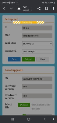

I have recently gone "off grid" but have been unable to reconnect. Despite following the Fox connect/reconnect video on Youtube and after several exchanges with Fox customer services I am still "off grid".
One of the suggestions from the Fox customer service team was to remove and re-insert the cataloguer. I did this but the connection process failed.
The problem seems to be that on the "set up net" page the initialising phase doesn't populate the IP address as 192.168.1.1 instead it populates it with 0.0.0.0
A screenshot of the "set up net" page is attached.
Any ideas what else I can do?

It is a very fiddly process and i’m not sure which video you have used - but i’d recommend watching this as it guides you through the steps and avoids some of the pifalls. https://foxesscommunity.com/viewtopic.php?t=970

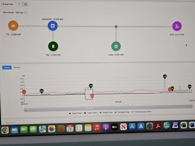

I attach a screenshot of the Fox Cloud system details that shows very minor discharge (0.05kw) from the battery which seems to be the maximum that it will discharge at the moment.

- Posts: 1422
Yes minSoc on Grid should be set the same as minSoC unless you have an EPS system installed (i.e. backup in the case of grid failure).
If you set it to 100% it won’t allow your batteries to discharge and will keep them held at 100%.
(Just to confuse people in the V2 app MinSoC on grid is called Battery Reserve Capacity and minSoC is called System MinSoC)
You may have confused MaxSoC from a force charge video as this is used by schedule when force charging to set the maximum value you want the batteries to charge to. That should normally be set to 100% ~ although perhaps in summer you would set it lower to leave some space in the batteries to accept solar charge.
