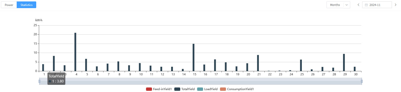

Monthly Report (Daily Breakdown)
Below is the data from the report for November (by days):
The API also returns the same data for this month:
Endpoint: /op/v0/device/report/query
Parameters: year=2024, month=11, dimension=month
{"errno":0,"msg":"success","result":[{"unit":"kWh","values":[3.8, 8.3, 3.2, 20.9, 6.7, 2.6, 4.1, 5.3, 3.2, 4.4, 3.0, 2.4, 2.4, 1.2, 14.9, 3.6, 6.4, 4.8, 2.6, 4.3, 8.8, 0.2, 0.3, 0.5, 6.3, 1.0, 2.3, 1.9, 9.4, 2.4],"variable":"generation"}]}

The yearly report shows 148.6 kWh for November. However, summing up the daily values from the monthly report yields 141.2 kWh.
